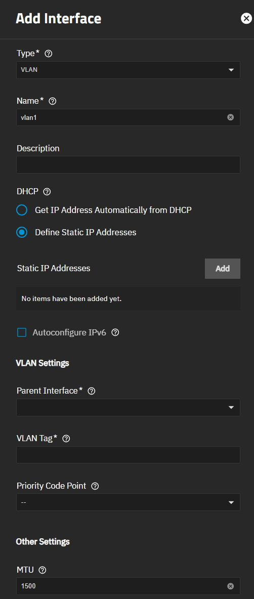

Adding a VLAN Interface
To set up a VLAN interface, go to Network, click Add on the Interfaces widget to open the Add Interface screen, then:
  1. Select VLAN from the Type dropdown list. You cannot change the Type field value after clicking Apply.
    Name populates with the default name vlan1. You cannot change the Name of the interface after clicking Save.
    Leave Define Static IP Addresses selected under DHCP.
  2. (Optional, but recommended) Enter any notes or reminders about this VLAN in Description.
  3. Select the interface in the Parent Interface dropdown list. This is typically an Ethernet card connected to a switch port already configured for the VLAN.
  4. Enter the numeric tag for the interface in the VLAN Tag field. This is typically preconfigured in the switched network.
  5. Select the VLAN Class of Service from the Priority Code Point dropdown list.
  6. (Optional) Click Add to the right of Aliases to show additional IP address fields for each additional IP address to add to this VLAN interface.
  7. Click Save.
  8. Test the network change when prompted.
