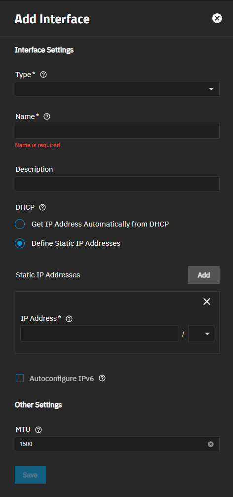

To add another network interface in the UI, go to System > Network and click Add on the Interfaces widget to open the Add Interface screen.
Add Interface Screen
Figure 1: Add Interface Screen
You must specify the type of interface to create. Select the interface type from the Type dropdown options: Bridge, Link Aggregation (bond), or VLAN (virtual LAN). The interface type cannot be changed after clicking Save.
To revert the interface to default network settings, select Reset Configuration on the more_vert for the interface. This resets the interface from a static IP address to a DHCP-assigned address and resets the domain to the TrueNAS default local.
Enter a name for the interface using the format that corresponds to the type of interface you are adding. Naming differs between physical and virtual interfaces. The name assigned to the primary physical network interface on your system is based on the systemd predictable naming scheme, and reflects the hardware type and location. The names vary based on your hardware configuration. For example, eno1 for onboard NICs, ens3 for PCIe slot NICs, and you might see eno1np0, which is an onboard NIC with more than one port on the NIC.
When selecting a virtual interface type, enter a name based on the type. For example, bondX, vlanX, or brX and where X is a number.
To allow DHCP to assign the interface IP address, select Get IP address Automatically from DHCP.
To use a fixed (static) IP address, select the Define Static IP Addresses, and then click Add to the right of Static IP Addresses to show the IP address and netmask (CIDR) fields. Enter the assigned IP address and select the netmask from the dropdown list.
Click Add for each IP address you want to associate with the interface.
If adding an IPv6 IP address, refer to Configuring IPv6 for details on this type of network configuration.
Click Save when you are certain of your configuration. You cannot change the interface type or name after clicking Save!

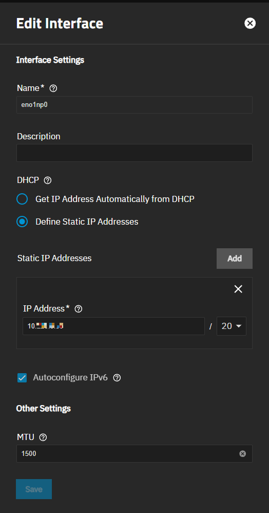

Editing an Interface
To change an existing interface, click on the more_vert icon at the right of the interface, and then click Edit to open the Edit Interface screen.
The Edit Interface and Add Interface screen settings are identical, but the Type and Name fields are not editable for an existing interface. If you created the wrong type of virtual interface (for example, a bridge, vlan, or link aggregation), delete the interface and add a new interface with the correct type.
When changing from a DHCP-provided IP address to a static IP, first verify your current default gateway and name servers work with the new IP address. You must add the new default gateway and DNS name servers that work with the new IP address to the global configuration. If you need to change these settings, do this before you change the interface so you can test the interface change.
Click Save after making all changes.
Test the change as described above in Testing Network Interface Changes.

TrueNAS does not set an FEC mode by default. The NIC uses the factory-default behavior, which is typically automatic negotiation. Set the mode to AUTO to explicitly direct the NIC to negotiate.
Edit Interface screen showing the FEC Mode dropdown
Figure 6: Edit Interface FEC Mode Dropdown
The FEC Mode dropdown on the Edit Interface screen shows only when both of these conditions are true:
  • The interface is a physical NIC, not a bridge, link aggregation, or VLAN.
  • The NIC reports at least one supported FEC mode.
The Add Interface screen creates only virtual interfaces - bridges, link aggregations, and VLANs - none of which support FEC. TrueNAS detects physical interfaces from the hardware, so FEC Mode appears only when you edit an existing physical interface.
TrueNAS reads the supported modes from the NIC when you open the Edit Interface screen. The dropdown lists only the modes valid for that hardware.
An FEC mode mismatch with the upstream switch can disconnect the interface from the network. Change this setting only when TrueNAS Support directs you to, for troubleshooting link negotiation failures.
To change the FEC mode for an interface:
  1. Go to System > Network. Click Edit on the more_vert menu for the interface to open the Edit Interface screen.
    If the FEC Mode dropdown does not appear, the NIC does not support FEC.
  2. Select the FEC mode from the FEC Mode dropdown. The dropdown lists only the modes the NIC supports. See Network Interface Screens for descriptions of each mode.
  3. Click Apply. The test changes options show on the Network screen.
  4. Test the change as described in Testing Network Interface Changes. Verify the system is reachable on the network.
