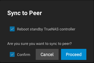

  6. Log into controller 1, go to System > Failover, and click Sync to Peer. This synchronizes controller 2 with controller 1 and restarts controller 2. Controller 2 becomes the standby controller when it finishes restarting.

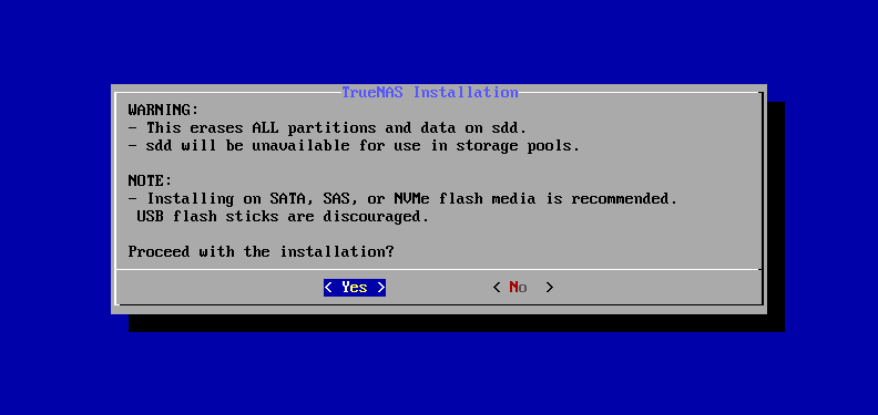

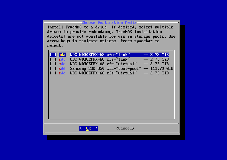

  1. Select Install/Upgrade.
  2. Select the desired install drive.
    Select Yes to proceed with a clean installation of TrueNAS from the .iso. This erases the contents of the selected drive!

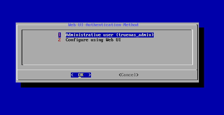

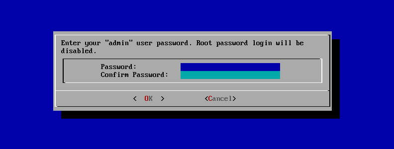

  3. Select option 1 Administrative user (truenas_admin) then OK to install TrueNAS and create the truenas_admin user account and password. TrueNAS has implemented an administrator login as a replacement for the root user login as a security hardening measure. The system retains root as a fallback, but it is no longer the default. The truenas_admin account has full control over TrueNAS and is used to log in to the web interface.
    Set a strong password and protect it.
    Next, enter a password for the new truenas_admin user.

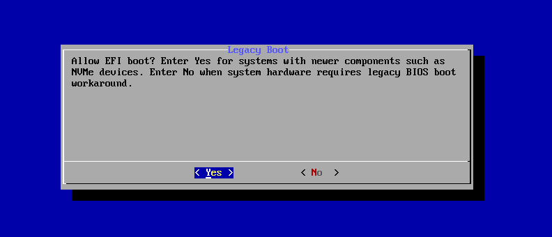

  4. Select Yes at the Legacy Boot prompt to allow the system to boot via UEFI, or select No if your system hardware requires legacy BIOS boot. Press Enter to begin the installation.

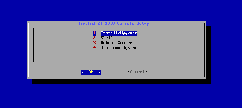

  5. Select OK when the Installation Succeeded screen shows and press Enter to exit from the installer.
  1. Select OK after the The TrueNAS installation on succeeded displays. The Console setup menu screen displays.
  2. Enter 3 to Reboot System and immediately return to the IPMI Virtual Media > CD-ROM image screen to click Unmount. Click Save. If you fail to unmount the iso image before the system completes the restart, the bootstrap install continues in a boot loop.

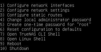

Configuring the Network with Console Setup Menu
After installing the .iso file on both controller 1 and 2 and finishing the TrueNAS Installer process, use the Console setup menu to configure the required network settings on controller 1, so it can access the TrueNAS UI. TrueNAS single controller systems use the DHCP-assigned IP address for the primary network interface to access the UI to complete the rest of the network and other configuration settings. However, HA systems with dual controllers must use static IP addresses.
To allow controller 1 to access the UI, you must disable DHCP and add the controller 1 static IP address and netmask as an alias on the primary network interface, and then enter the network settings for host name, domain name, default gateway, and the name servers (1 and 2). You can configure the rest of the HA global network settings in the TrueNAS web UI.
To use the Console setup menu to configure required network settings on controller 1:
TrueNAS Console Setup Menu
Figure 7: TrueNAS Console Setup Menu

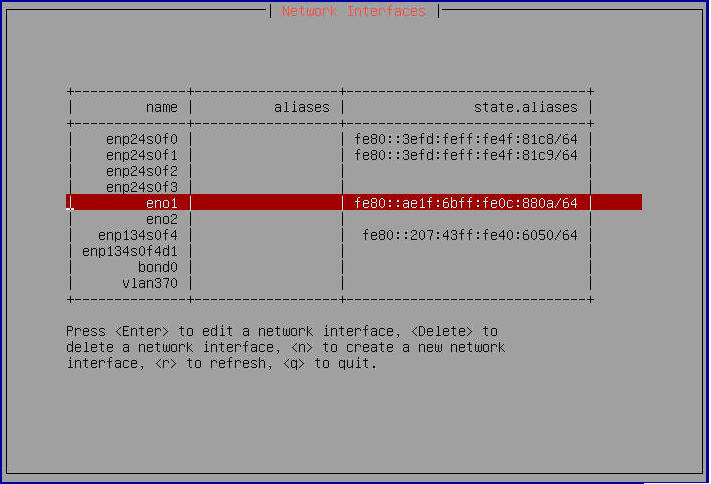

  1. Type 1 and then press Enter to open the Network Interfaces screen.
  2. Use either Tab or the arrow keys to select the interface assigned as your primary network interface. If you have more than one interface installed and wired to your network, the primary interface is typically eno1. With the interface highlighted, press Enter to open the Update Network Interface screen.

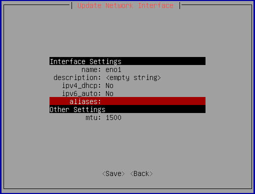

  3. Tab or arrow down to ipv4_dhcp and change it to no.
  4. Tab or arrow down to the aliases setting and enter the static IP address for controller 1. Tab or arrow down to Save, and then press Enter. A pending network changes notice displays with additional options.
  5. Type a to apply the change, then p to make it persist. Type q to return to the main Console setup menu.

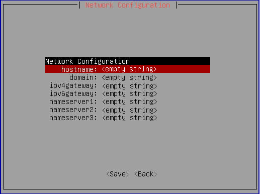

  6. Type 2 and then press Enter to open the Network Configuration screen.
  7. Use either Tab or the arrow keys to select each field. Type the value for each field listed below. Press Enter after each value.
    FieldDescription/Example
    hostnameThe host name you assign to controller 1. For example m50-123-1.
    domainThe domain name for the nework controller 1. For example my.companyname.net
    ipv4gatewayThe default gateway IP address for your network.
    nameserver1
    nameserver2
    The IP addresses for your network DNS servers.
  8. Use either Tab or the arrow keys to select Save, then type q to return to the main Console setup menu.

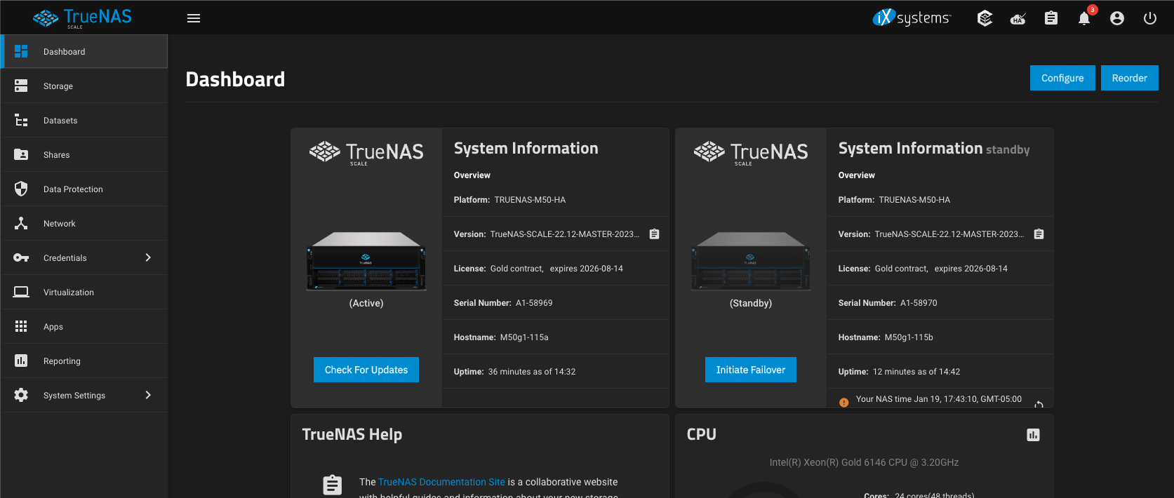

Go to System > General Settings and click Add License on the Support widget. Copy your license and paste it into the License field, then click Save License. The Reload dialog opens. Click Reload Now. Controller 1 restarts, and displays the EULA for controller 2. Sign the EULA agreement for controller 2, and add the license.
The controller 1 and 2 (or a and b) serial numbers display on the Support widget on the System > General Settings screen.

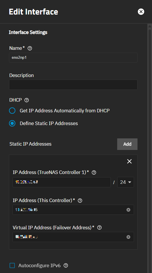

TrueNAS Enterprise (HA) systems use three static IP addresses for access to the UI:
  • VIP to provide UI access regardless of which controller is active. If your system fails over from controller 1 to 2, then fails back over to controller 1 later you might not know which controller is active.
  • IP for controller 1. Do not use DHCP to assign the IP address! If enabled, DHCP assigns an IP to the primary network interface on non-HA systems. Disable DHCP, and then manually enter the Controller 1 static IP address your network administrator assigned for this controller.
  • IP for Controller 2. Manually enter the second IP address assigned for this controller.
Have the list of network addresses, name sever and default gateway IP addresses, and host and domain names ready so you can complete the network configuration without disruption or system timeouts.
TrueNAS safeguards allow a default of 60 seconds to test and save changes to a network interface before reverting changes. This is to prevent users from breaking their network connection in TrueNAS.
To configure network settings on controller 1:

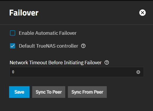

  1. Disable the failover service. Go to System > Advanced Settings, scroll down to the Failover widget, then click Configure. Select Enable Automatic Failover to clear the checkmark, then select Default TruNAS Controller to enable it, and then click Save to disable failover.
  2. Go to System > Network and click Settings to edit the global network settings. Add the controller and virtual host names and update any other network settings.

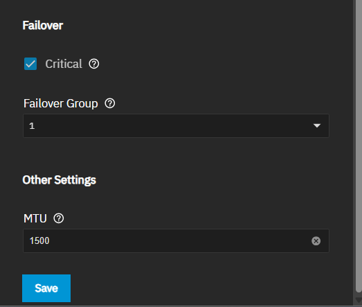

  3. Edit the primary network interface to add failover settings. Click on the more_vert to the right of the the primary interface eno1, and select Edit to open the Edit Interface screen for this interface.
    a. Turn DHCP off if it is on by selecting Define Static Ip Addresses. Click Add to show IP address fields for each interface. Enter the IP address assigned to controller 1 in IP Address (TrueNAS Controller 1), the IP address assigned to controller 2 in IP Address (This Controller), and the IP address assigned as the virtual IP in Virtual IP Address (Failover Address).
    If Define Static IP Addresses is already selected, verify the three static IP addresses assigned to the system show in the correct fields. First, enter the IP address for controller 1 into IP Address (This Controller) and select the netmask (CIDR) number from the dropdown list. Next, enter the controller 2 IP address into IP Address (TrueNAS Controller 2). Finally, enter the VIP address into Virtual IP Address (Failover Address).
    b. Add the failover settings. Select 1 on the Failover Group dropdown list.
  4. Click Save
  5. Click Test Changes after editing the interface settings. Open a new browser window and enter the VIP IP address to access the web UI. Go to System > Network and click Save Changes to make the changes permanent. You have 60 seconds to test and then save changes before they revert. If this occurs, edit the interface again.
  6. Enable failover. Go to System > Advanced Settings, scroll down to the Failover widget, then click Configure. Select Enable Automatic Failover to re-enable failover, then click save.

Syncing Controller 1 and 2
  1. Turn the failover service back on. Go to System > Services locate the Failover service and click edit.
  2. Select Disable Failover to clear the checkmark and turn failover back on, then click Save. The system might restart. Use IPMI to monitor the status of controller 2 and wait until the controller is back up and running.
  3. Log out of the controller 1 UI, and log in using the VIP address.
  4. Sync controller 1 and 2. With controller 2 powered on, but not configured, from controller 1 click Sync To Peer. Select Reboot standby TrueNAS controller and Confirm, then click Proceed to start the sync operation. This sync controller 2 with controller 1 which adds the network settings and pool to controller 2.
When the system comes back up, log into TrueNAS using the virtual IP address. The main Dashboard displays two System Information widgets. In standard configurations by iXsystems, Controller 1 shows its serial number and a host name that includes the letter a. Controller 2 is labeled as Standby Controller and shows its serial number and a host name that includes the letter b. Take note of this information.
Main Dashboard for HA Systems
Figure 15: Main Dashboard for HA Systems

The failover feature on TrueNAS Enterprise platforms with High Availability (HA) can malfunction in network environments that heavily use the Spanning Tree Protocol (STP). When configuring or troubleshooting HA failover, if TrueNAS HA failover does not function properly, investigate STP use in the network and consider disabling STP on network switch ports connected to the TrueNAS platform.
If controller 2 comes online as the primary and controller 1 as the standby, you installed and configured the controllers incorrectly.
  1. Go to System > Failover, clear the Default TrueNAS Controller option, and click Save. The system restarts and fails over to the current standby controller (in this case, to controller 1).
  2. Log back into the UI with the VIP address. Go to System > Failover and select Default TrueNAS Controller to make controller 1 the primary controller.
  3. Select Sync to Peer. TrueNAS makes controller 2 the standby controller and syncs the configuration on controller 1 to controller
  4. Click Save.
