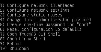

The menu provides several options:
TrueNAS Console Setup Menu
Figure 1: TrueNAS Console Setup Menu

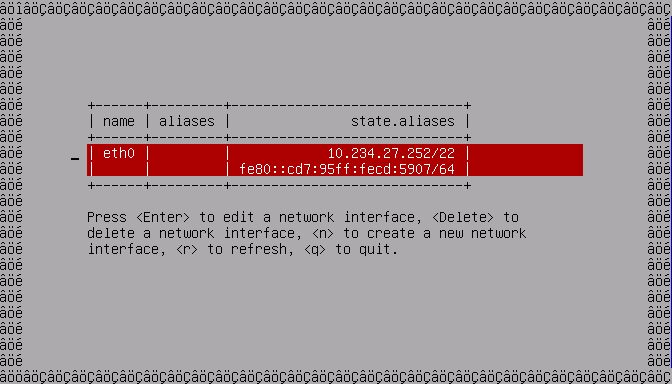

Enter 1 to display the Configure Network Interfaces screen and select the interface settings.
TrueNAS Console Setup Menu Edit Interface
Figure 2: TrueNAS Console Setup Menu Edit Interface

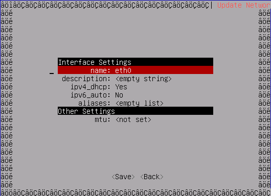

Follow the instructions on the screen to configure an IP for a network interface. Type n to open the new interface screen or press Enter to edit the existing interface.
TrueNAS Console Setup Menu Edit Interface Settings
Figure 3: TrueNAS Console Setup Menu Edit Interface Settings

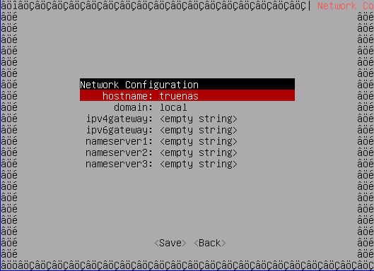

Enter 2 to display the Network Settings screen to set up the host name, domain, default gateway and name servers. You can also add these settings using the web UI.
TrueNAS Console Setup Menu Edit Network Settings
Figure 4: TrueNAS Console Setup Menu Edit Network Settings

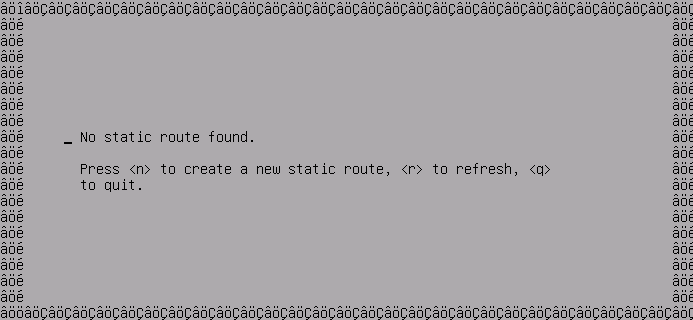

Enter 3 to display the Static Route Settings screen to set up static routes. You can also add static routes in the web UI.
TrueNAS Console Setup Menu Static Routes
Figure 5: TrueNAS Console Setup Menu Static Routes
