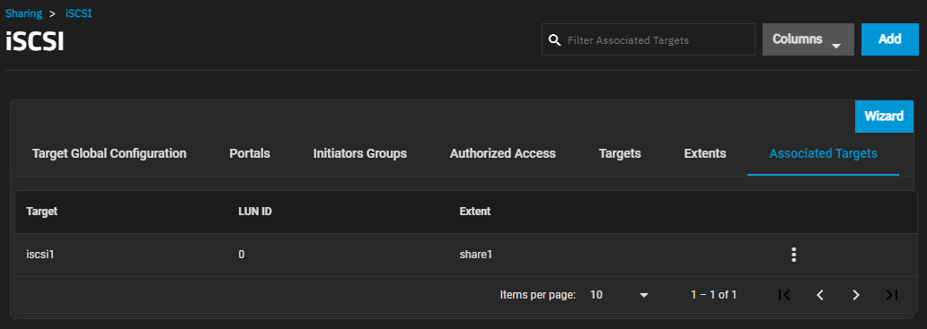

The Associated Targets screen displays settings to create new associated TrueNAS storage resources or edit existing ones in the list.
SharingiSCSIAssociatedTargetsScreen
Add opens the Add Associated Target screen.
The next to each entry displays two options, Edit and Delete. Edit opens the Edit Associated Target screen, and Delete opens a dialog to delete the associated targets for the selected user. The Add and Edit screens display the same settings.

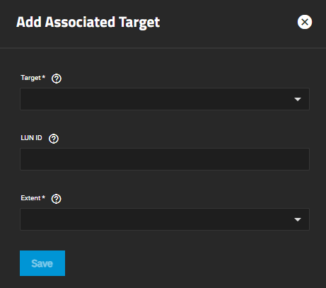

iSCSIManualAddAssocAuthTargets
SettingDescription
TargetRequired. Select an existing target.
LUN IDSelect the value or enter a value between 0 and 1023. Some initiators expect a value below 256. Leave this field blank to automatically assign the next available ID.
ExtentRequired. Select an existing extent.
