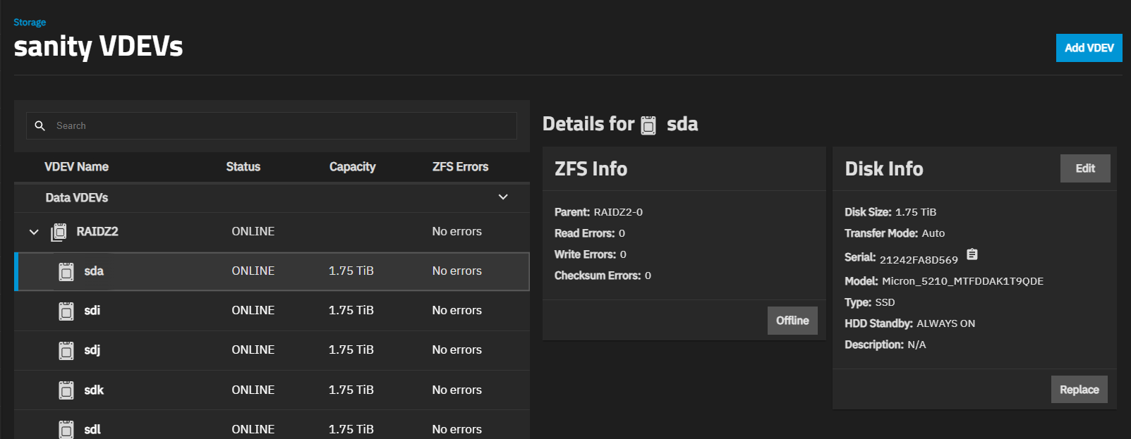

DiskWidgets
Each disk in a VDEV has two widgets that show information for that disk: ZFS Info and Disk Info. After selecting a disk, the widgets show on the right side of the screen in the Details for diskname area of the screen.

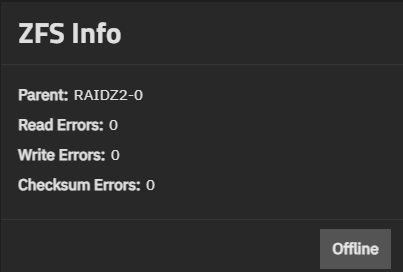

ZFS Info Widget (Drives)
The ZFS Info widget for each device (disk drive) in the VDEV shows the name of the VDEV (Parent), the read, write, and checksum errors for that drive, and the Detach and Offline options.
Detach opens a confirmation dialog and removes the selected drive from the parent VDEV.

Offline opens a confirmation dialog and takes the selected drive to an offline state before taking a disk offline to replace it. Toggles to Online so you can bring a replacement disk online. After taking a drive offline, you can remove or replace the physical drive.

Disk Info Widget
The Disk Info widget shows the disk size, transfer mode, the serial and model numbers for the drive, type of drive, HDD standby setting, and a description associated with the selected drive.
