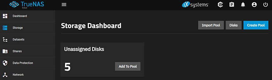

To test one or more disk for errors, go to Storage and click the Disks button.
StorageDashDisksButtonSCALE

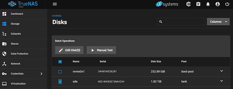

Select the disks you want to test using the checkboxes to the left of the disk names. Selecting multiple disks displays the Batch Operations options.
StorageDisksSelectedSCALE

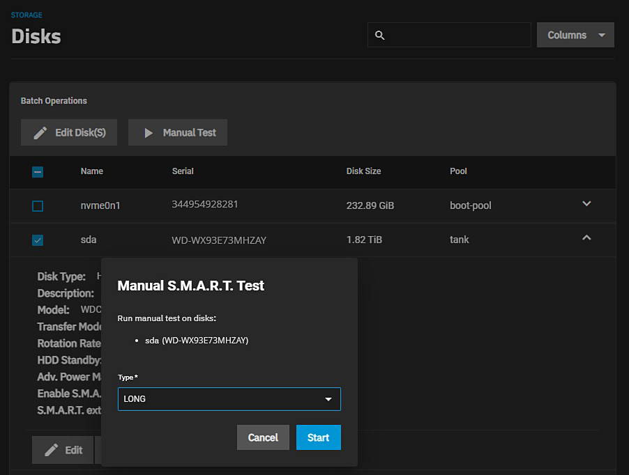

Click Manual Test. The Manual S.M.A.R.T. Test dialog displays.
StorageDisksManualTestSCALE
Next, select the test type from the Type dropdown and then click Start.

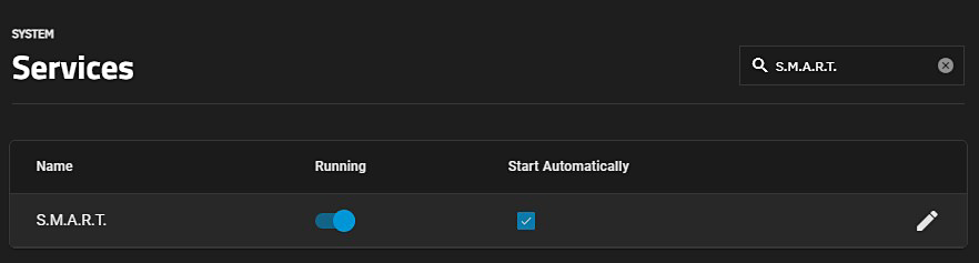

Start the S.M.A.R.T. service. Go to System > Services and scroll down to the S.M.A.R.T. service. If not running, click the toggle to turn the service on. Select Start Automatically to have this service start after after the system restarts.
SMARTSystemServicesSCALE
If you have not configured the S.M.A.R.T. service yet, while the service is stopped, click to open the service configuration form. See Services S.M.A.R.T. Screen for more information on service settings. Click Save to save settings and return to the Services screen.
