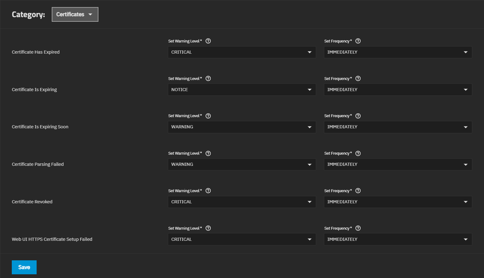

Certificates
Certificates alert settings apply to certificates you add through the Credentials > Certificates screen.
Click here for more information
AlertSettingsCertificates
You can customize alert settings for when a certificate expires, a certificate parsing fails, a certificate revokes, and the web UI HTTPS certificate setup fails.

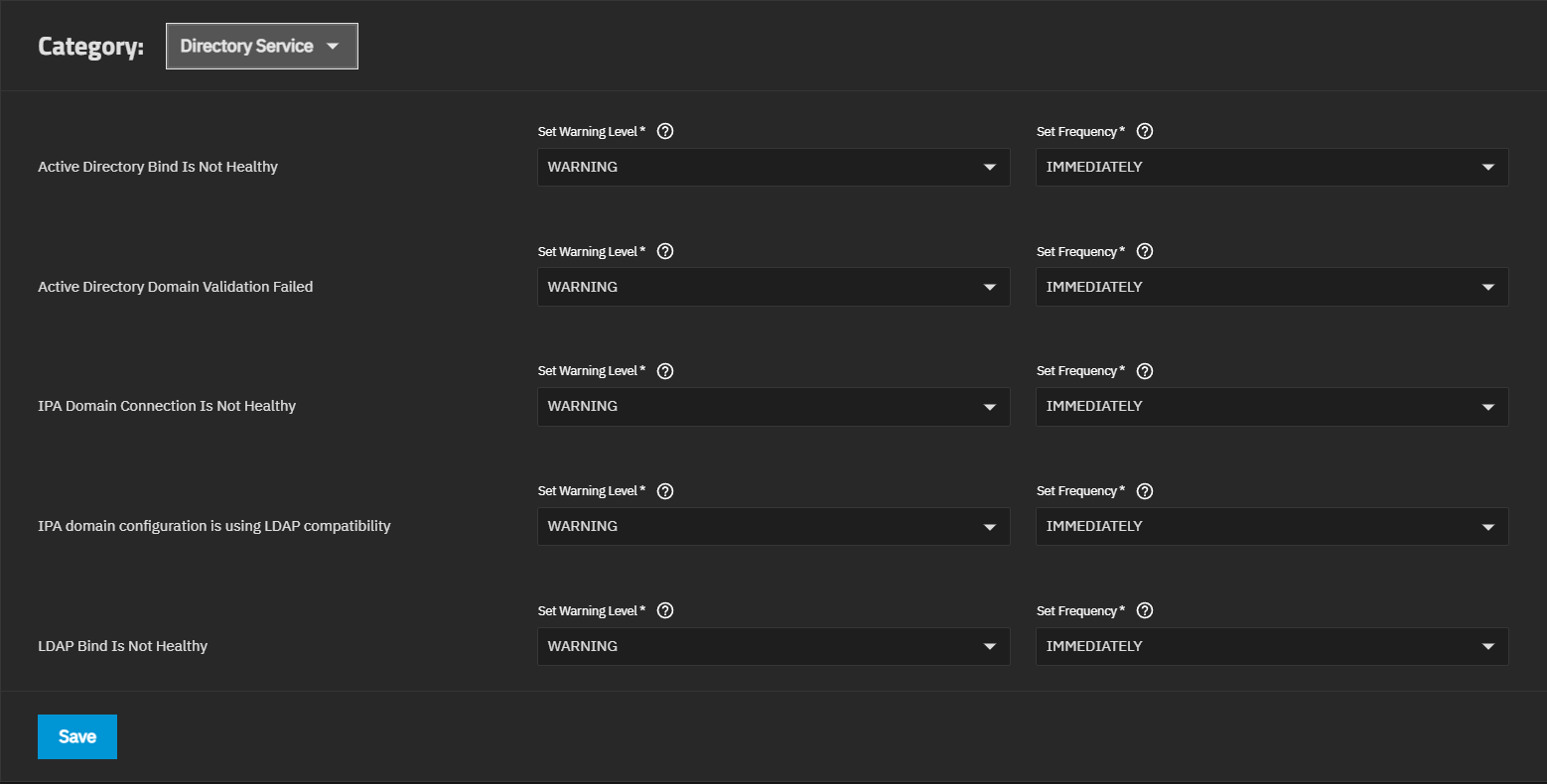

Directory Service
Directory Service alert settings apply to the Active Directory and LDAP servers configured on your TrueNAS.
AlertSettingsDirectoryServices
You can customize alert settings for when the Active Directory bind is unhealthy, Active Directory domain validation fails, the domain is offline, and the LDAP bind bind is unhealthy.

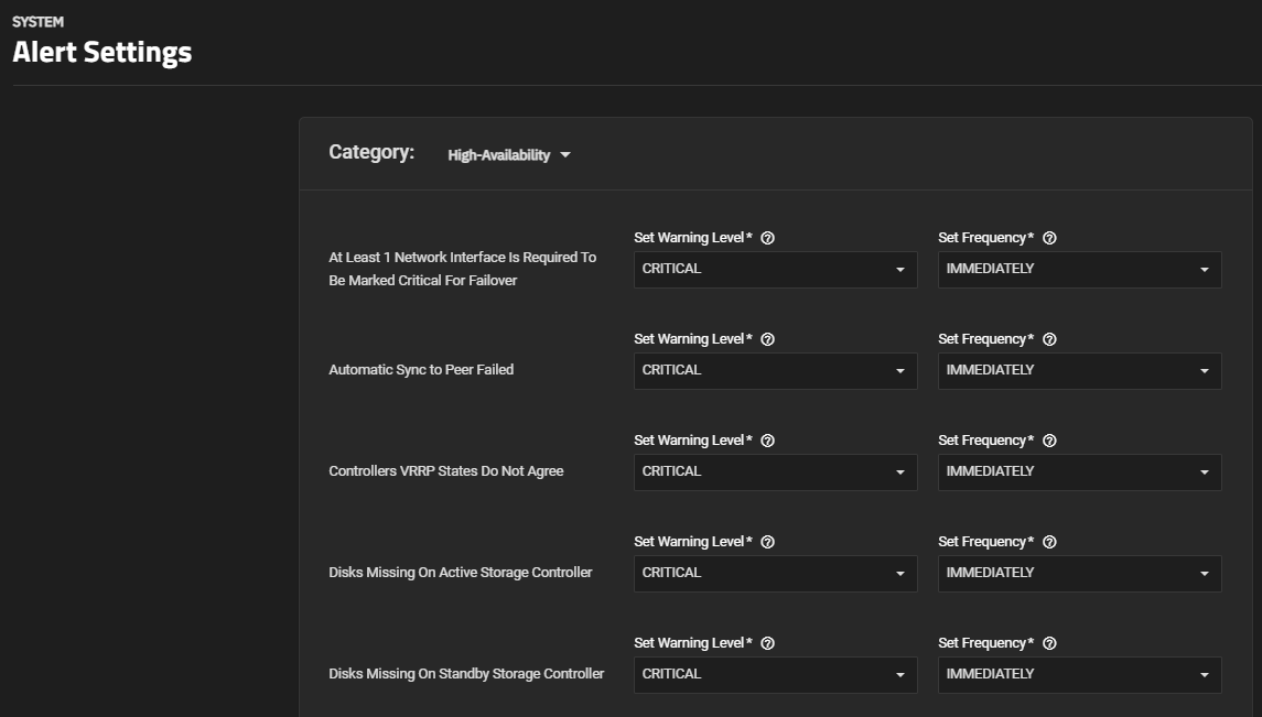

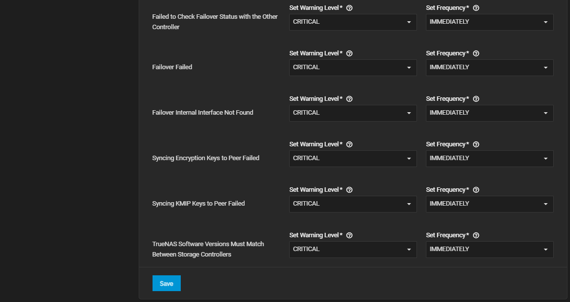

High Availability Settings
TrueNAS Enterprise
This section only applies to TrueNAS Enterprise hardware.
High Availability alert settings apply to TrueNAS Enterprise HA systems and only displays on the list of alerts for dual-controller High-Availability systems with an Enterprise license applied.
AlertSettingsHA1
AlertSettingsHA2
You can customize alert settings for when an automatic sync to peer fails, disks are missing on the active and/or standby controller, the system fails to check failover status with the other controller, syncing operations fail such as encryption keys to peer and KMIP keys to peer, the failover interface is not found, and when a failover action fails.

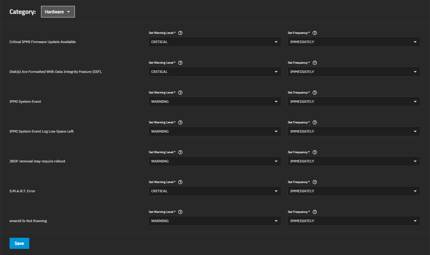

Hardware
Hardware alert settings apply to the IPMI network connections, and S.M.A.R.T. and smartd that monitors the hard drives installed on your TrueNAS system.
AlertSettingsHardware
You can customize alert settings for when disk(s) format with the data integrity feature, IPMI has system events, the IPMI system event log space is low, S.M.A.R.T. has an error, and smartd is not running.
The IPMI System Event Log (SEL) stores system events and can assist with debugging hardware issues. Review IPMI SEL alerts and resolve any underlying hardware issues before clearing space in the SEL. Consult manufacturer documentation for your motherboard to learn how to review IPMI system events and clear the log.

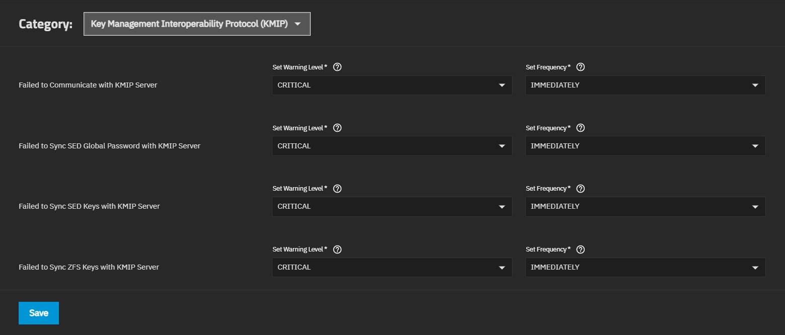

Key Management Interoperability Protocol (KMIP)
Key Management Interoperability Protocol (KMIP) alert settings only apply to KMIP configured on a TrueNAS Enterprise system.
AlertSettingsKMIP
You can customize alert settings for when the system fails to communicate, sync the SED global password, and sync keys with the KMIP server.

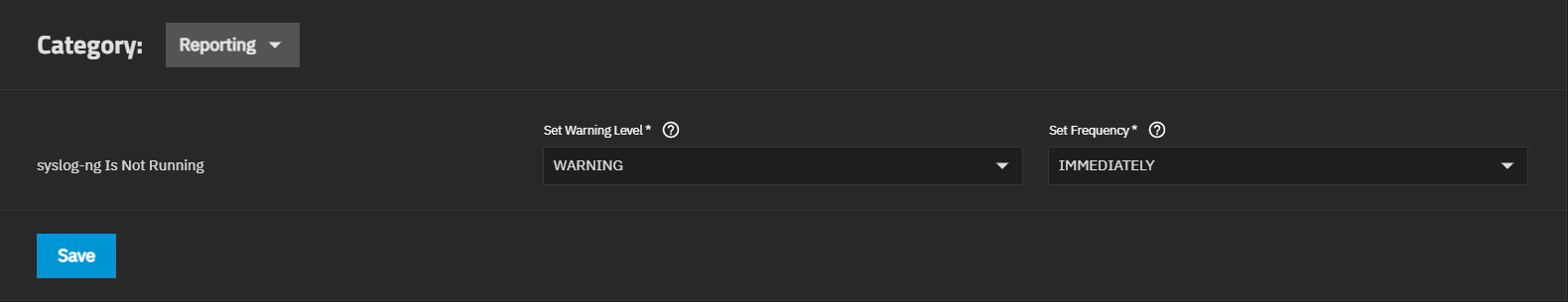

Reporting
Reporting alert settings apply to netdata, database size threshold, and syslog processes on your TrueNAS.
AlertSettingsReporting
You can customize alert settings for when netdata has critical alerts and warnings, the reporting database size exceeds the threshold, and syslog-ng is not running.

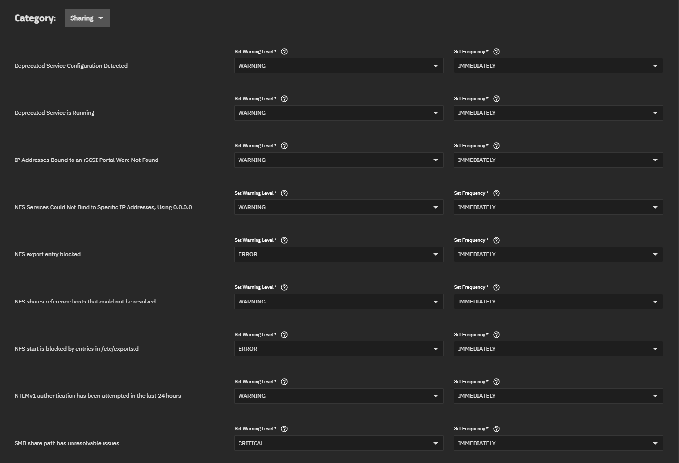

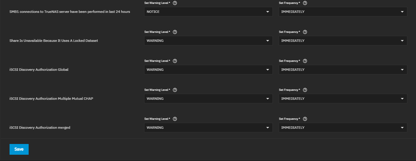

Sharing
Sharing alert settings apply to iSCSI, NFS, or SMB shares and connections configured on your TrueNAS.
AlertSettingsSharing1
AlertSettingsSharing2
You can customize alert settings for when a deprecated service is running, IP addresses bound to an iSCSI portal are not found, NFS services cannot bind to specific IP addresses using 0.0.0.0, and the system cannot resolve NFS share references hosts.
You can also customize alerts for when NTLMv1 attempts authentication in the last 24 hours, SMB1 connections to TrueNAS server are performed in the last 24 hours, and a share is unavailable because it uses a locked dataset.

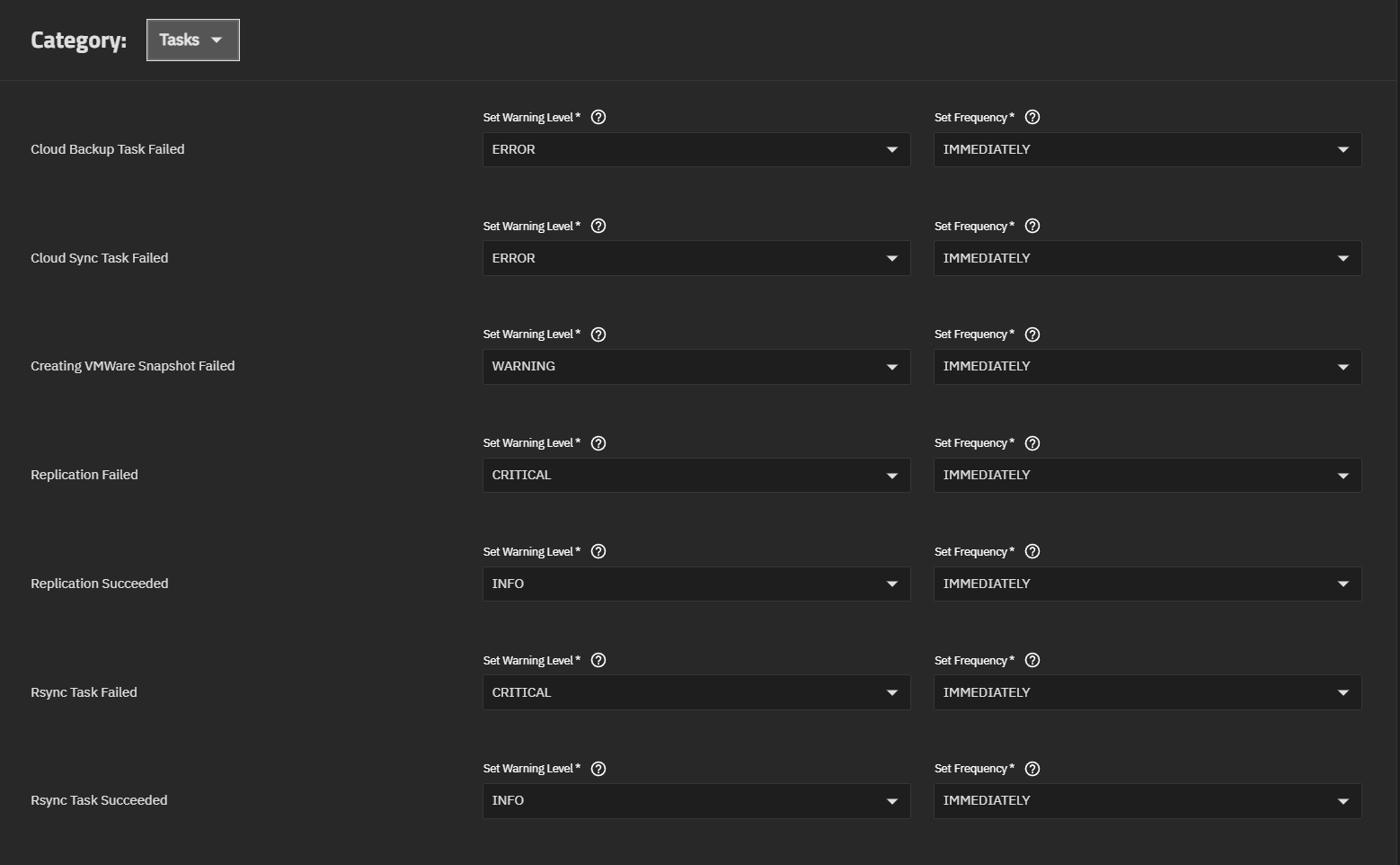

Tasks
Tasks alert settings apply to cloud sync, VMWare snapshots, replication, rsync, scrub and snapshot tasks scheduled on your TrueNAS.
AlertSettingsTasks1
AlertSettingsTasks2
You can customize alert settings for when cloud sync tasks, VMWare snapshot creation, login, and deletion, replication, rsync tasks, scrubs, and snapshot tasks fail in general or due to locked datasets.
You can also change alert settings for when replication, rsync tasks, and scrubs succeed.

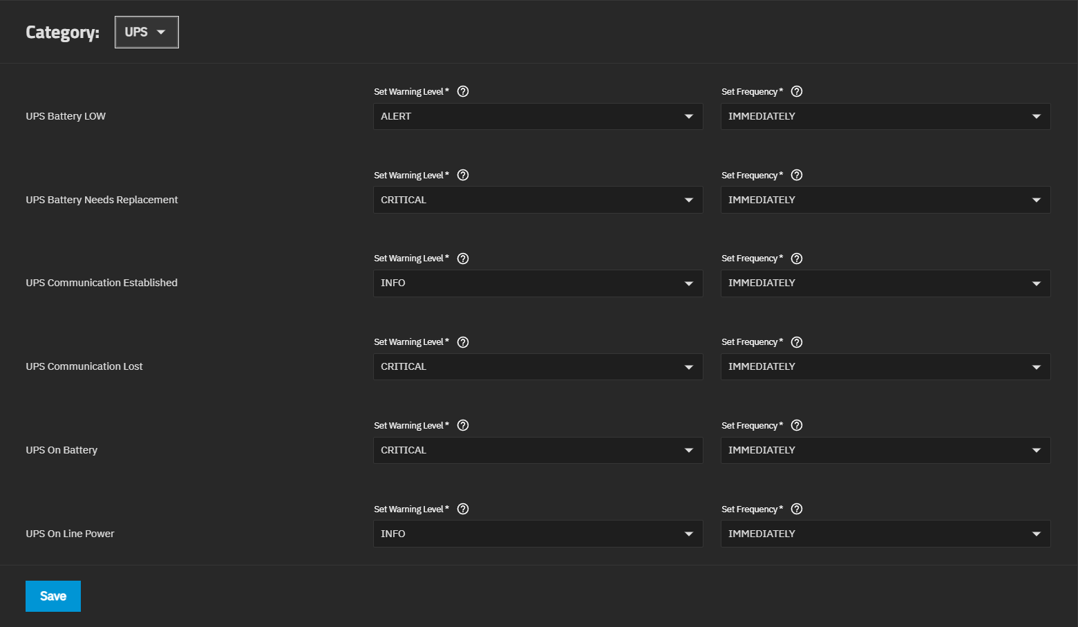

UPS
UPS alert settings apply to a UPS connected to your TrueNAS.
AlertSettingsUPS
You can customize alert settings for when the UPS battery is low or needs replacement, the UPS establishes or loses communication, and the UPS is on battery or line power.
