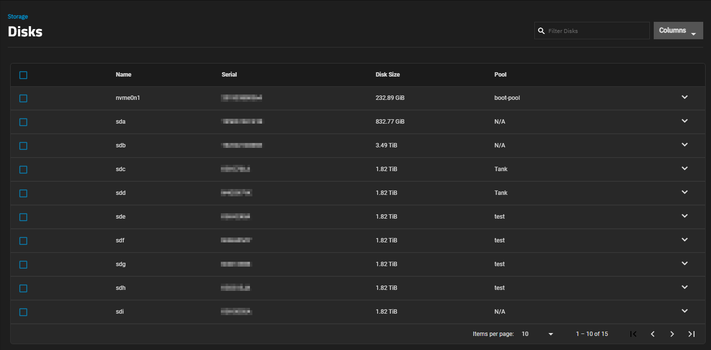

Disks
The Disks screen lists the physical drives (disks) installed in the system. The list includes the names, serial numbers, sizes, and pools for each system disk.
Disks Screen
Figure 1: Disks Screen
Use the Columns dropdown list to select options to customize disk the information displayed. Options are Select All, Name, Serial, Disk Size, Pool (where the disk is in use), Disk Type, Description, Model, Transfer Mode, Rotation Rate (RPM), HDD Standby, Adv. Power Management, Enable S.M.A.R.T., and Reset to Defaults. Each option displays the information you enter in the Edit Disk screen or when you install the disk.
Select the checkbox to the left of a disk to display the Batch Operations options. The checkbox at the top of the table selects all disks in the system. Select again to clear the checkboxes.
Storage in the breadcrumb at the top of the screen returns to the Storage Dashboard.
Disks Screen - Expanded Disk
Click anywhere on a disk row to expand it and show the traits specific to that disk and available options. The expanded view of a disk includes details for the disk and options to edit disk properties, run a SMART test and view the test results, and in some instances the ability to wipe the disk.

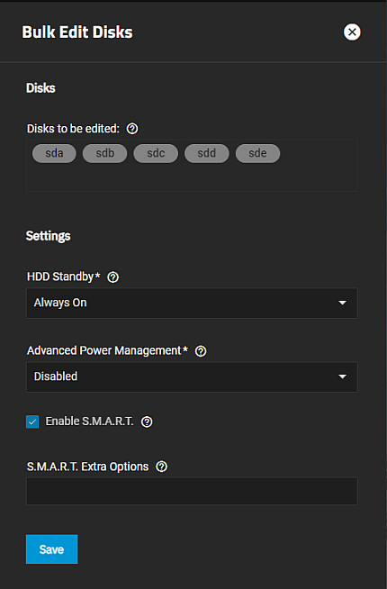

Bulk Edit Disks
The Bulk Edits Disks screen allows you to change disk settings for multiple disks simultaneously. The screen lists the device names for each selected disk in the Disks to be edited section.
Bulk Edit Disks Screen
Figure 3: Bulk Edit Disks Screen
Bulk Edit Disks Settings
SettingDescription
HDD StandbySelect the minutes of inactivity before the drive enters standby mode from the dropdown list. Options are Always On or 5, 10, 20, 30, 60, 120, 240, 300, and 330. For more information read this forum post describing identifying spun-down drives. Temperature monitoring is disabled for the standby disk.
Advanced Power ManagementSelect the power management profile from the dropdown list. Options are Disabled, Level 1 - Minimum power usage with Standby (spindown), Level 64 - Intermediate power usage with Standby, Level 127 - Maximum power usage with Standby, Level 128 - Minimum power usage without Standby (no spindown), Level 192 - Intermediate power usage without Standby, and Level 254 - Maximum performance, maximum power usage.
Enable S.M.A.R.T.Select to enable and allow the system to conduct periodic S.M.A.R.T. tests.

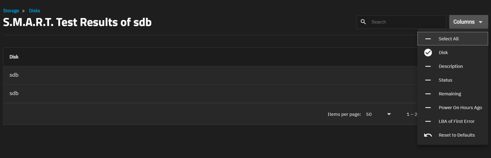

S.M.A.R.T. Test Results of diskname Screen
The S.M.A.R.T. Test Results of diskname lists test results for the selected disk. The Storage and Disks breadcrumbs return to other storage pages. Storage opens the Storage Dashboard and Disks opens the Disks screen.
S.M.A.R.T. Test Results for A Disk Screen
Figure 5: S.M.A.R.T. Test Results for A Disk Screen
Customizing the Test Results Screen
Customize the information displayed with the Columns option.
The Select All option displays all information on the table view. Unselect All shows only the disk ID.
SMART Test Result Column Options
These options, except the ID, appear on the Columns dropdown list.
OptionDescription
DiskThe disk identifier.
DescriptionType of test run and the status of the system. For example, Short offline indicates the test type is Short while the system is offline when the test runs.
StatusLists the test status. Options are Success or Fail.
RemainingHow much of the test is left to perform. If the test encounters an error, the field shows at what point in the test the error occurs. A value of 0 means the test completed and with no errors encountered.
Power On Hours AgoTracks how many hours have passed while the disk has been powered on since the last test.
LBA of First ErrorDisplays the logical block address (LBA) of the first location where a self-test encountered any detected problem. Displays No Errors when no error has been encountered in testing.
