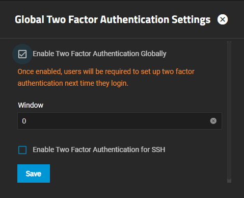

  1. Go to System > Advanced Settings, scroll down to the Global Two Factor Authentication widget, and click Config.
  2. Check Enable Two Factor Authentication Globally, then click Save.
    If you want to enable two-factor authentication for SSH logins, select Enable Two-Factor Auth for SSH before you click Save.
    TrueNAS takes you to the Two-Factor Authentication screen to finish 2FA setup.
