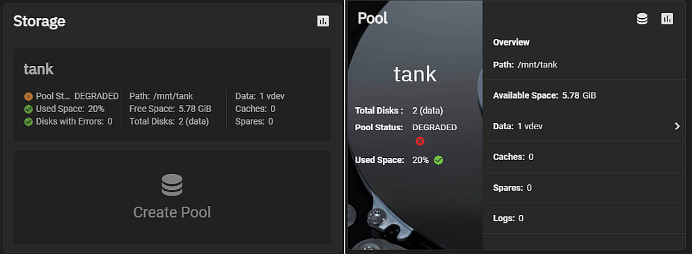

If you configure your main TrueNAS Dashboard to include individual Pool or the Storage widgets they show the status of your system pools as on or offline, degraded, or in an error condition.
Main Dashboard Pool and Storage Widgets Degraded
Figure 1: Main Dashboard Pool and Storage Widgets Degraded
The Storage Dashboard pool widgets also show the status of each of your pools.
Storage Pool Widgets in Degraded State
Figure 2: Storage Pool Widgets in Degraded State
From the main Dashboard, you can click the on either the Pool or Storage widget or you can click Storage on the main navigation menu to open the Storage Dashboard screen and locate the pool in the degraded state.

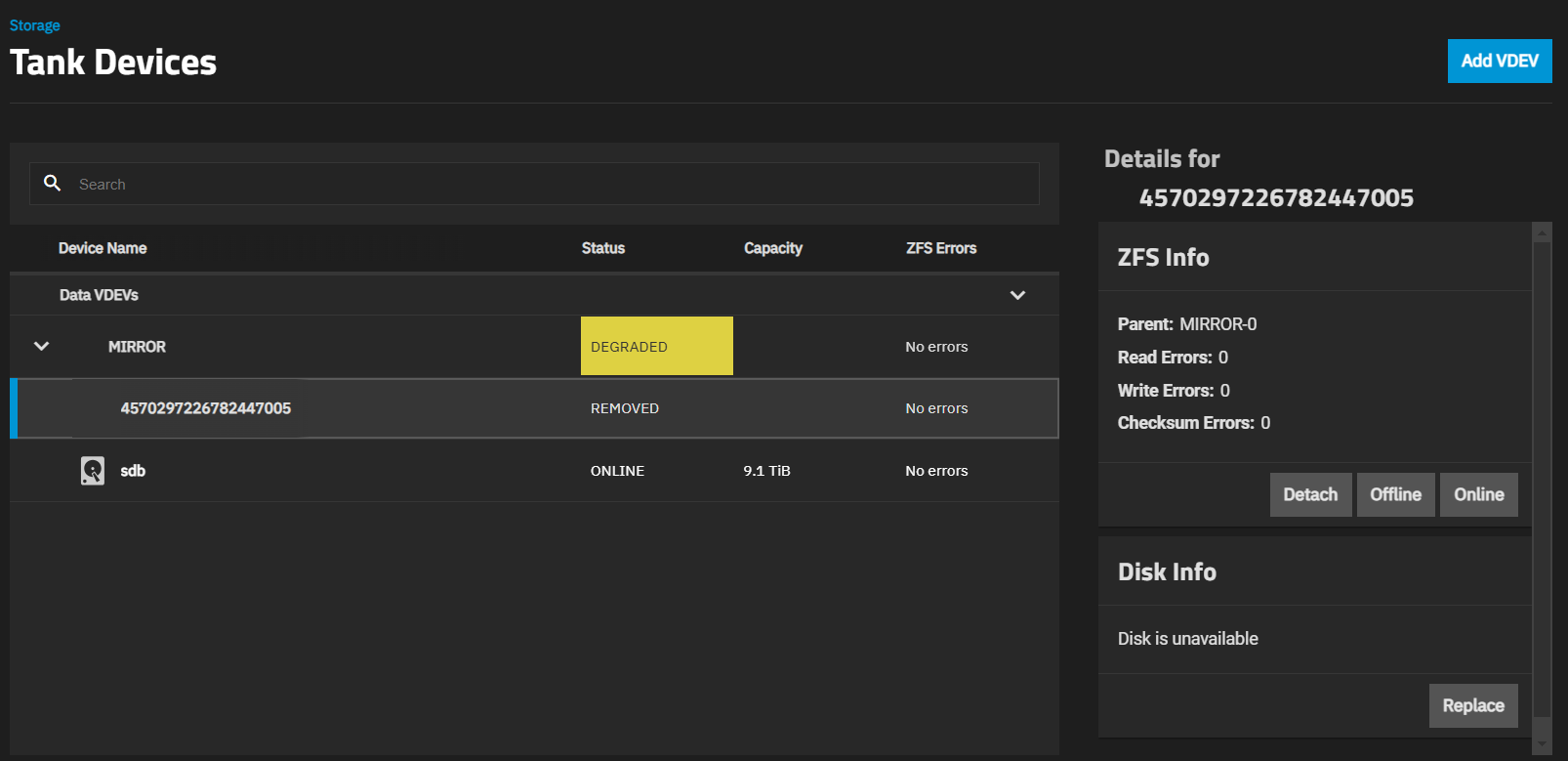

Taking a Failed Disk Offline
We recommend users off-line a disk before starting the physical disk replacement. Off-lining a disk removes the device from the pool and can prevent swap issues. To offline a disk:
Go to the Storage Dashboard and click Manage Devices on the Topology widget for the degraded pool to open the Devices screen for that pool. Click next to the VDEV to expand it, then look for the disk with the REMOVED status.
Devices Disk Failed
Figure 3: Devices Disk Failed
Click on the failed disk, then click Offline in the ZFS Info widget to take the disk offline. The disk status changes to OFFLINE.

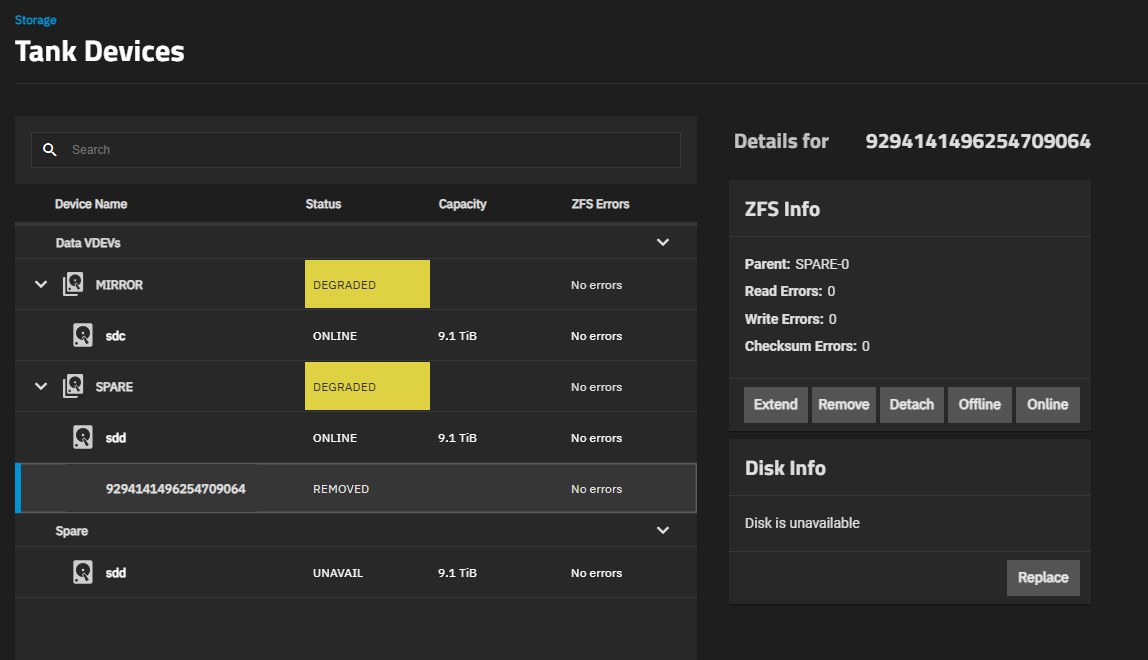

Detaching a Failed Disk
After taking the failed disk offline and physically removing it from the system, go to the Storage Dashboard and click Manage Devices on the Topology widget for the degraded pool to open the Devices screen for that pool. Click next to the VDEV to expand it, then look for the disk with the REMOVED status.
Devices Disk Failed - Hot Spare Active
Figure 7: Devices Disk Failed - Hot Spare Active
Click Detach on the ZFS Info widget on the Devices screen for the disk you off-lined.
Select Confirm, then click Detach. TrueNAS detaches the disk from the pool and promotes the hot spare disk to a full member of the pool.
Refresh the screen to ensure the promoted hot spare appears in the pool as expected.
