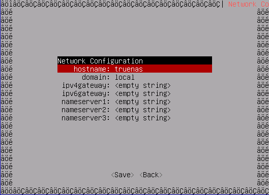

Enter 2 to display the Network Settings screen to set up the host name, domain, default gateway and name servers. You can also add these settings using the web UI.
TrueNAS Console Setup Menu Edit Network Settings
Figure 4: TrueNAS Console Setup Menu Edit Network Settings

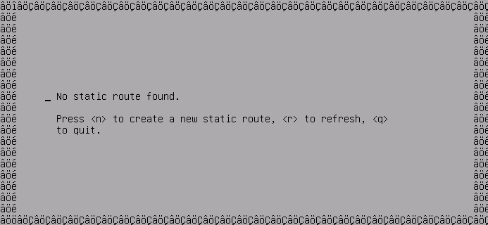

Enter 3 to display the Static Route Settings screen to set up static routes. You can also add static routes in the web UI.
TrueNAS Console Setup Menu Static Routes
Figure 5: TrueNAS Console Setup Menu Static Routes

To configure the default gateway, host name, domain and DNS name severs using the Console Setup menu type 2 and then press Enter to open the Network Settings screen.
