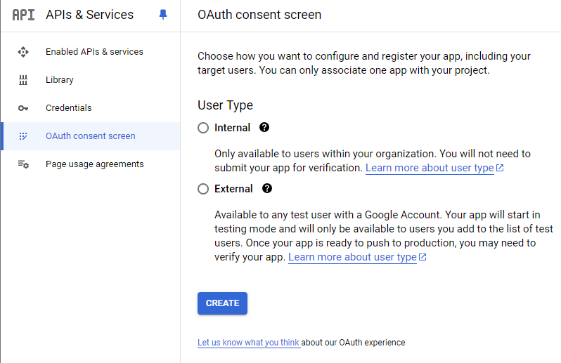

Configure Authentication
Click OAuth consent screen on the left menu, select EXTERNAL, then click CREATE.
Create External User
Figure 5: Create External User
