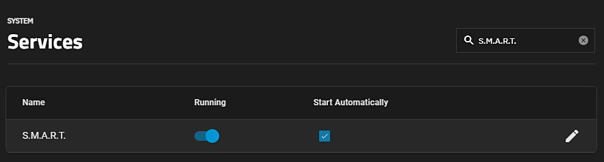

Start the S.M.A.R.T. service. Go to System Settings > Services and scroll down to the S.M.A.R.T. service. If not running, click the toggle to turn the service on. Select Start Automatically to have this service start after after the system reboots.
SMARTSystemServicesSCALE
If you have not configured the S.M.A.R.T. service yet, while the service is stopped, click to open the service configuration form. See Services S.M.A.R.T. Screen for more information on service settings. Click Save to save settings and return to the Services screen.
