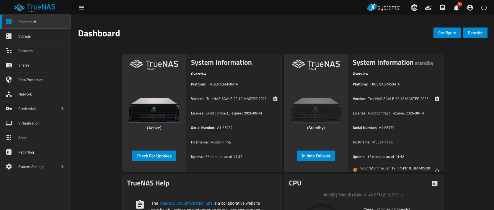

SCALE UI Enterprise customers see the End User License Agreement (EULA) screen the first time they log in. Sign the agreement to open the main SCALE Dashboard. Apply the system license next.
Go to System Settings > General and click Add License on the Support widget. Copy your license and paste it into the License field, then click Save License. The Reload dialog opens. Click Reload Now. Controller 1 restarts, and displays the EULA for controller 2. Sign the EULA agreement for controller 2, and add the license.
The controller 1 and 2 (or a and b) serial numbers display on the Support widget on the System Settings > General screen.

When the system comes back up, log into SCALE using the virtual IP address. The main Dashboard displays two System Information widgets. In standard configurations by iXsystems, Controller 1 shows its serial number and a host name that includes the letter a. Controller 2 is labeled as Standby Controller and shows its serial number and a host name that includes the letter b. Take note of this information.
Main Dashboard for HA Systems
Figure 9: Main Dashboard for HA Systems
