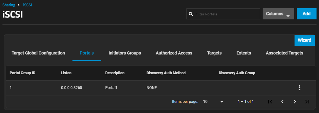

Portals Screens
The configuration tabs Portals screen displays a list of portal ID groups on the TrueNAS system.
SharingiSCSIPortalsScreen
The next to the portal displays the Edit and Delete options. Delete opens the Delete dialog for the selected portal ID. Click Confirm and then Delete to delete the selected portal.
Add opens the Add Portal screen. Edit opens the Edit Portal screen. Both screens have the same setting options.
iSCSIManualAddPortalNoAuth
Basic Info Settings
SettingDescription
DescriptionEnter an optional description. Portals are automatically assigned a numeric group.
Authentication Method and Group Settings
SettingDescription
Discovery Authentication MethodSelect the discovery method you want to use for authentication from the dropdown list. iSCSI supports multiple authentication methods that targets can use to discover valid devices. None allows anonymous discovery. If set to None, you can leave Discovery Authentication Group set to None or empty. If set to CHAP or Mutual CHAP, you must enter or create a new group in Discovery Authentication Group.
Discovery Authentication GroupSelect the discovery authentication group you want to use from the dropdown list. This is the group ID created in Authorized Access. Required when the Discovery Authentication Method is CHAP or Mutual CHAP. Select None or Create New. Create New displays additional setting options.
IP Address Settings
SettingDescription
IP AddressSelect the IP addresses the portal listens to. Click Add to add IP addresses with a different network port. 0.0.0.0 listens on all IPv4 addresses, and :: listens on all IPv6 addresses.
PortTCP port used to access the iSCSI target. The default is 3260.
AddAdds another IP address row.

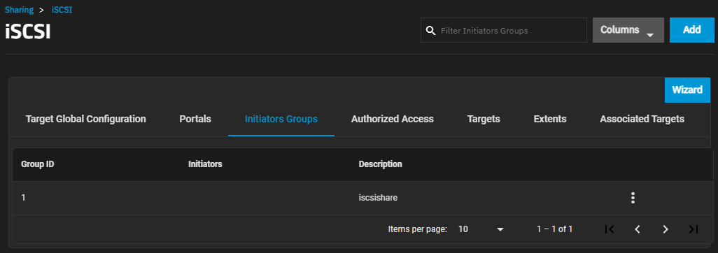

Initiators Groups Screen
The Initiators Groups screen display settings to create new authorized access client groups or edit existing ones in the list.
SharingiSCSIInitiatorsGroupsScreen
The next to the initiator group displays the Edit and Delete options. Delete opens the Delete dialog for the selected group ID. Click Confirm and then Delete to delete the selected portal.
Add opens the Sharing > iSCSI > Initiators > Add screen. Edit opens the Sharing > iSCSI > Initiators > Edit screen. Both screens have the same setting options.
iSCSIManualAddInitiators
SettingDescription
Allow All InitiatorsSelect to allows all initiators.
Allowed Initiators (IQN)Enter initiators allowed access to this system. Enter an iSCSI Qualified Name (IQN) and click + to add it to the list. Example: iqn.1994-09.org.freebsd:freenas.local.
DescriptionEnter any notes about the initiators.

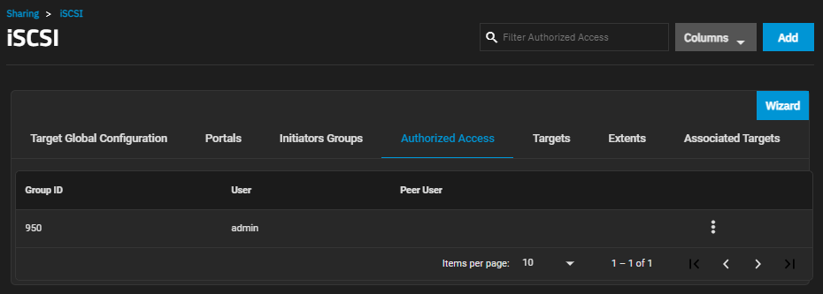

Authorized Access Screen
The Authorized Access screen displays settings to create new authorized access networks or edit existing ones in the list.

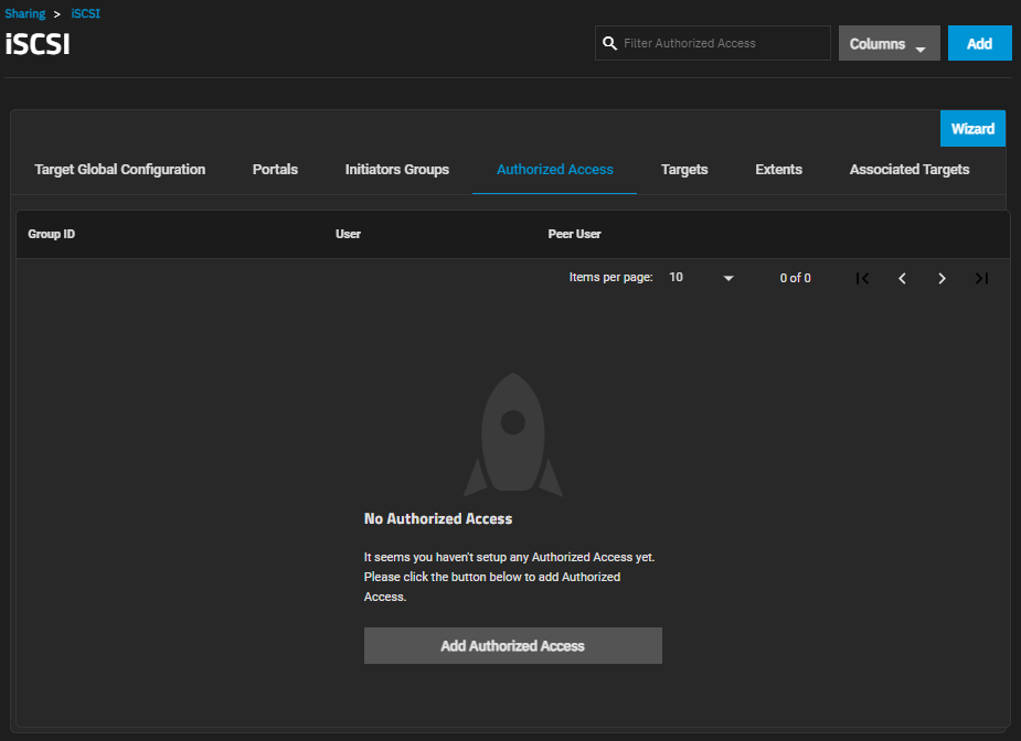

If you have not set up authorized access yet, the No Authorized Access screen displays with the Add Authorized Access button in the center of the screen. Add Authorized Access or Add at the top of the screen opens the Add Authorized Access screen.
iSCSIManualNoAuthAccess
After adding authorized access to the system, the Authorized Access screen displays a list of users.
SharingiSCSIAuthorizedAccessScreen
Add opens the Add Authorized Access screen.
The next to each entry displays two options, Edit and Delete. Edit opens the Edit Authorized Access screen, and Delete opens a dialog to delete the authorized access for the selected user. The Add and Edit screens display the same settings.
iSCSIManualAddAuthAccess
Group Settings
SettingDescription
Group IDEnter a number. This allows configuring different groups with different authentication profiles. Example: all users with a group ID of 1 inherit the authentication profile associated with Group 1.
User Settings
SettingDescription
UserUser account to create CHAP authentication with the user on the remote system. Many initiators use the initiator name as the user name.
SecretEnter the user password. Secret must be at least 12 and no more than 16 characters long. The screen displays a “password does not match” error until you enter the same password in Secret (Confirm).
Secret (Confirm)Enter the same password to confirm the user password.
Peer User Settings
SettingDescription
Peer UserOptional. Enter only when configuring mutual CHAP. Usually the same value as User.
Peer SecretEnter the mutual secret password. Required if entering a Peer User. Must be a different password than the password in Secret.
Peer Secret (Confirm)Enter the same password to confirm the mutual secret password.

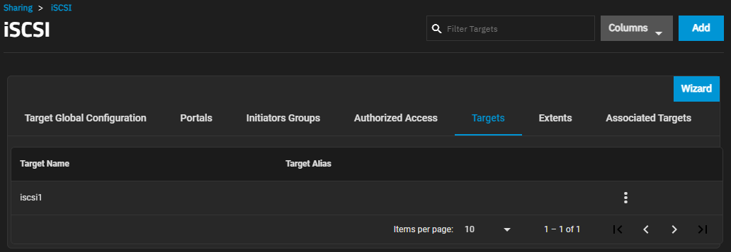

Targets Screen
The Targets screen displays settings to create new TrueNAS storage resources or edit existing ones in the list.
SharingiSCSITargetsScreen
Add opens the Add iSCSI Targets screen.
The next to each entry displays two options, Edit and Delete. Edit opens the Edit iSCSI Targets screen, and Delete opens a dialog to delete the select target. The Add iSCSI Targets and Edit iSCSI Targets screens display the same settings.
Add and Edit iSCSI Target Screens
The Add iSCSI Target and Edit iSCSI Target screens display the same settings, but the current settings populate the Edit iSCSI Target screen settings for the selected share.
To access the Add iSCSI Target screen from the Sharing > iSCSI screen, while on the Targets tab, click Add at the top of the screen. To access the Edit iSCSI Target screen from the Sharing > iSCSI screen, while on the Targets tab, click next to the share and then click Edit.
iSCSIManualAddTargets

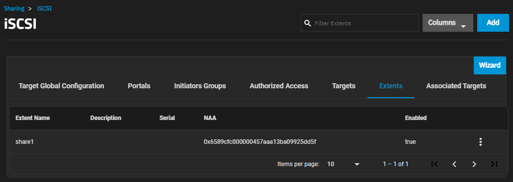

Extents Screen
The Extents screen displays settings to create new shared storage units or edit existing ones in the list.
SharingiSCSIExtentsScreen
Add opens the Add Extent screen.
The next to each entry opens two options, Edit and Delete. Edit opens the Edit Extent screen, and Delete opens a dialog to delete the extents for the selected user. The Add and Edit screens display the same settings.
iSCSIManualAddExtentDevice

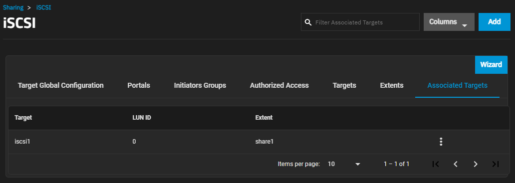

Associated Targets Screen
The Associated Targets screen displays settings to create new associated TrueNAS storage resources or edit existing ones in the list.
SharingiSCSIAssociatedTargetsScreen
Add opens the Add Associated Target screen.
The next to each entry displays two options, Edit and Delete. Edit opens the Edit Associated Target screen, and Delete opens a dialog to delete the associated targets for the selected user. The Add and Edit screens display the same settings.
iSCSIManualAddAssocAuthTargets
SettingDescription
TargetRequired. Select an existing target.
LUN IDSelect the value or enter a value between 0 and 1023. Some initiators expect a value below 256. Leave this field blank to automatically assign the next available ID.
ExtentRequired. Select an existing extent.
