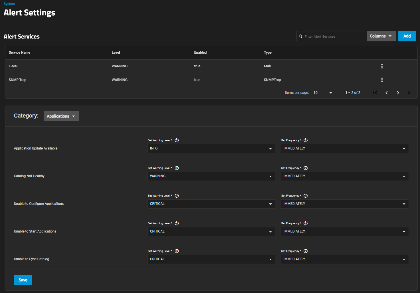

The Alert Settings screen displays options to create and edit alert services and to configure warning levels and frequencies. To access this screen, click the notifications icon, then click the settings icon and select Alert Settings on the dropdown list.
AlertServicesScreen
Use Columns to change the information displayed in the list of alert services. Options are Unselect All, Type, Level, Enabled and Reset to Defaults.

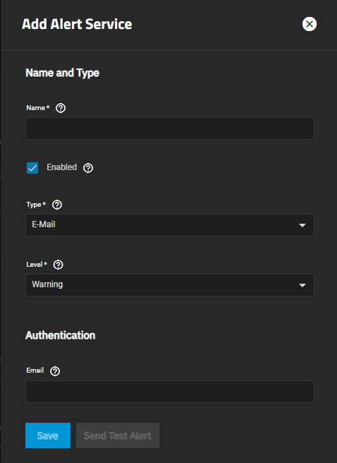

The Add Alert Service and Edit Alert Service screens show the same settings.
Use Add to create a new alert service using the Add Alert Service screen. The Type settings for AWS SNS display by default. To add an alert service for another option, use the Type dropdown list. Only the Authentication Settings change for each option.
Use the Edit Alert Service screen to modify settings for a service. Select the more_vert icon for the service, and then click Edit to display the Edit Alert Service screen.
AddAlertServiceScreen
Name and Type Settings
SettingDescription
NameEnter a name for the new alert service.
EnabledClear the checkmark to disable this service without deleting it.
TypeSelect an option from the dropdown list for an alert service to display options for that service. Options are AWS SNS which is the default type displayed, E-Mail, InfluxDB, Mattermost, OpsGenie, PagerDuty, Slack, SNMP Trap, Telegram or VictorOPS.
LevelSelect the severity from the dropdown list. Options are Info, Notice, Warning, Error, Critical, Alert or Emergency.
Use SEND TEST ALERT to generate a test alert to confirm the alert service works.
Click Cancel to exit the Alert Services screen without saving.
Use Save to add the new service with the settings you specify to the list of alert services.

Email
Select Email from the Type dropdown list to display email authentication settings.
AddAlertServiceEmailScreen
SettingDescription
Email AddressEnter a valid email address to receive alerts from this TrueNAS system.

Alert Categories
Use the Category dropdown list to display alert settings for each category.
Applications
Applications alert settings display by default. These alerts apply to the third-party applications you deploy on your TrueNAS system.
AlertSettingsApplications
You can customize alert settings for when available applications have updates, catalog is not healthy, the system cannot configure or start applications, and the system cannot sync the catalog.
