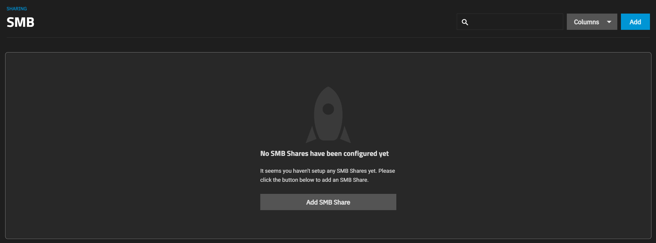

If you have not added SMB shares to the system, clicking the Windows (SMB) Shares option on the Sharing screen displays the No SMB Shares have been configured yet screen with the Add SMB Share button in the center of the screen.
SMBShareScreenNoShare
Use this button or the Add button at the top right of the screen to configure your first SMB share. After adding the first SMB share, the Sharing SMB screen displays.

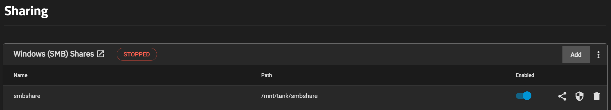

Windows (SMB) Shares Widget

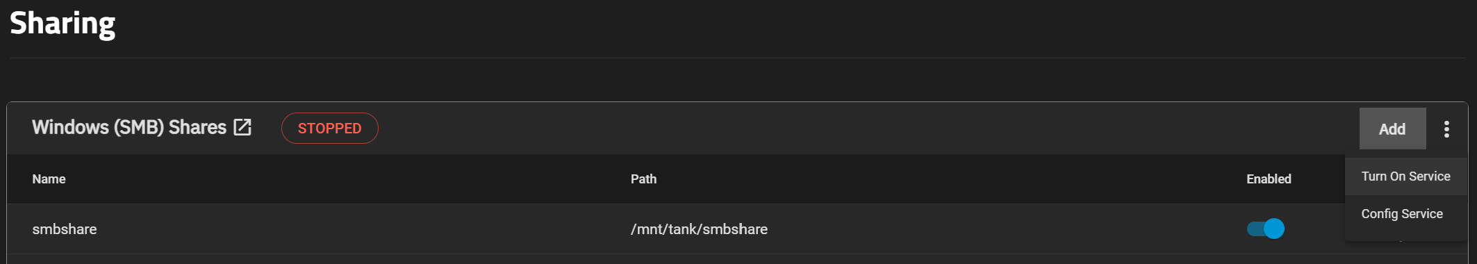

The Windows (SMB) Shares launch widget updates after adding SMB shares. It also updates when you click Shares on the main navigation panel to return to the Sharing screen.
SharingSMBServiceStatusScreen
Each SMB share toggle provides quick access to enable or disable the share.
The share Edit Share ACL icon displays the Edit Share ACL screen.
The security Edit Filesystem ACL icon opens the Edit Filesystem ACL screen.
Each share also has a delete delete option.
The SMB share row is a link to the Edit SMB screen.

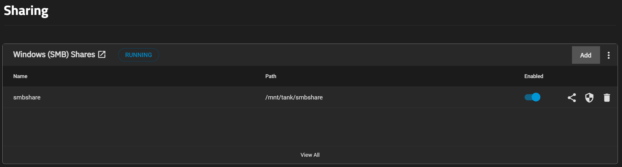

Windows (SMB) Shares Service Toolbar
The Windows (SMB) Shares launch toolbar displays the status of the SMB service as either STOPPED (red) or RUNNING (blue). Before adding the first share, the STOPPED status displays in the default color.
SMBServiceStatusAfterFirstShareAdded
Both Windows (SMB) Shares and View Details at the bottom of the widget display the Sharing > SMB details screen.
The Add button displays the Add SMB share configuration screen.
The more_vert displays options to turn the SMB service on or off. Turn Off Service displays if the service is running, otherwise, Turn On Service displays. The Config Service option displays the System Settings > SMB configuration screen.

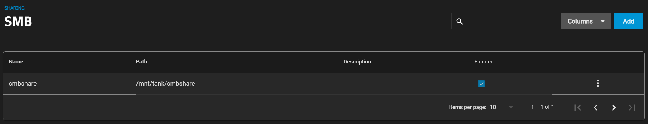

Sharing SMB Details Screen
Windows SMB Share launch displays The Sharing >SMB details screen. From this screen, you can add or edit an SMB share on the list.
SharingSMBScreen
Add displays the Add SMB configuration screen.
The Columns button displays a set of options to customize the list view. Options include Unselect All, Path, Description, Enabled and Reset to Defaults.
The Enabled checkbox provides the share status. If selected, it indicates the share path is available when the SMB service is active. If cleared, it disables but does not delete the share.
The more_vert displays a dropdown list of options for each share. The Edit displays the Edit SMB screen, Edit Share ACL displays the Edit Share ACL screen, Edit Filesystem ACL opens the Edit Filesystem ACL screen, and Delete displays the Delete dialog.

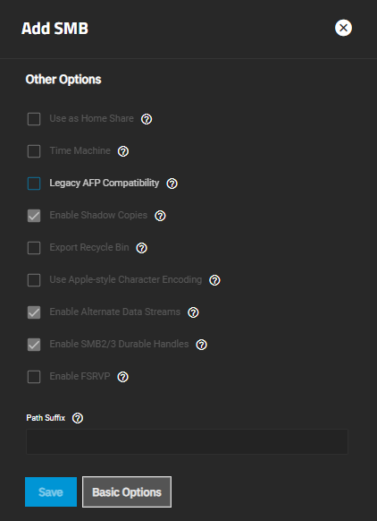

Other Settings
The Other Options settings are for improving Apple software compatibility, ZFS snapshot features, and other advanced features.
AddSMBAdvancedOtherSettings
SettingDescription
Use as Home ShareSelect to allow the share to host user home directories. Each user has a personal home directory they use when connecting to the share that is not accessible by other users. Home Shares allow for personal, dynamic shares. You can only use one share as the home share. See Adding an SMB Home Share for more information.
Time MachineEnables Apple Time Machine backups on this share. This option requires SMB2/3 protocol extension support. You can enable this in the general SMB server configuration.
Legacy AFP CompatibilitySelect to enable the share to behave like the deprecated Apple Filing Protocol (AFP). Leave cleared for the share to behave like a normal SMB share. This option controls how the SMB share reads and writes data. Only enable this when this share originated as an AFP sharing configuration. You do not need legacy compatibility for pure SMB shares or macOS SMB clients. This option requires SMB2/3 protocol extension support. You can enable this in the general SMB server configuration.
Enable Shadow CopiesSelect to export ZFS snapshots as Shadow Copies for Microsoft Volume Shadow Copy Service (VSS) clients.
Export Recycle BinSelect to enable. Deleted files from the same dataset move to a Recycle Bin in that dataset and do not take any additional space.
Use Apple-style Character EncodingSelect to convert NTFS illegal characters in the same manner as macOS SMB clients. By default, Samba uses a hashing algorithm for NTFS illegal characters.
Enable Alternate Data StreamsSelect to allow multiple NTFS data streams. Disabling this option causes macOS to write streams to files on the file system.
Enable SMB2/3 Durable HandlesSelect to allow using open file handles that can withstand short disconnections. Support for POSIX byte-range locks in Samba is also disabled. We don’t recommend this option when configuring multi-protocol or local access to files.
Enable FSRVPSelect to enable support for the File Server Remote VSS Protocol (FSVRP). This protocol allows remote procedure call (RPC) clients to manage snapshots for a specific SMB share. The share path must be a dataset mount point. Snapshots have the prefix fss- followed by a snapshot creation timestamp. A snapshot must have this prefix for an RPC user to delete it.
Path SuffixAppends a suffix to the share connection path. Use this to provide individualized shares on a per-user, per-computer, or per-IP address basis. Suffixes can contain a macro. See the smb.conf manual page for a list of supported macros. The connect path must be preset before a client connects.

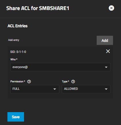

SMB Share ACL Screen
The SMB Share ACL screen displays when you click Edit Share ACL from the more_vert options list on the Sharing SMB details screen. These settings configure new ACL entries for the selected SMB share and apply them at the entire SMB share level. It is separate from file system permissions.
SMBShareACLScreen
ACL Entries Settings
ACL Entries are listed as a block of settings. Click Add to add a new entry.
SettingDescription
SIDShows the SID trustee value (who) this ACL entry (ACE) applies to. SID is a unique value of variable length that identifies the trustee. Shown as a Windows Security Identifier. Click Save and re-open Edit Share ACL to update.
WhoSelect the domain for account(s) (who) this ACL entry applies to. Options are User, Group, and everyone@.
UserEnter or select from the dropdown a user (who) this ACL entry applies to, shown as a user name. Available when Who is set to User.
GroupEnter or select from the dropdown a group (who) this ACL entry applies to, shown as a group name. Available when Who is set to Group.
PermissionSelect predefined permission combinations from the dropdown list. Select FULL to grant read access, execute permission, write access, delete objects, change permissions, and take ownership (RXWDPO) permissions. Select CHANGE to grant read access, execute permission, write access, and delete object (RXWD) permissions. Select READ to grant read access and execute permission on the object (RX). For more details, see smbacls(1).
TypeSelect the option from the dropdown list that specifies how TrueNAS applies permissions to the share. Select ALLOWED to deny all permissions by default, except manually defined permissions. Select DENIED to allow all permissions by default, except manually defined permissions.
Save stores the share ACL and immediately applies it to the share.

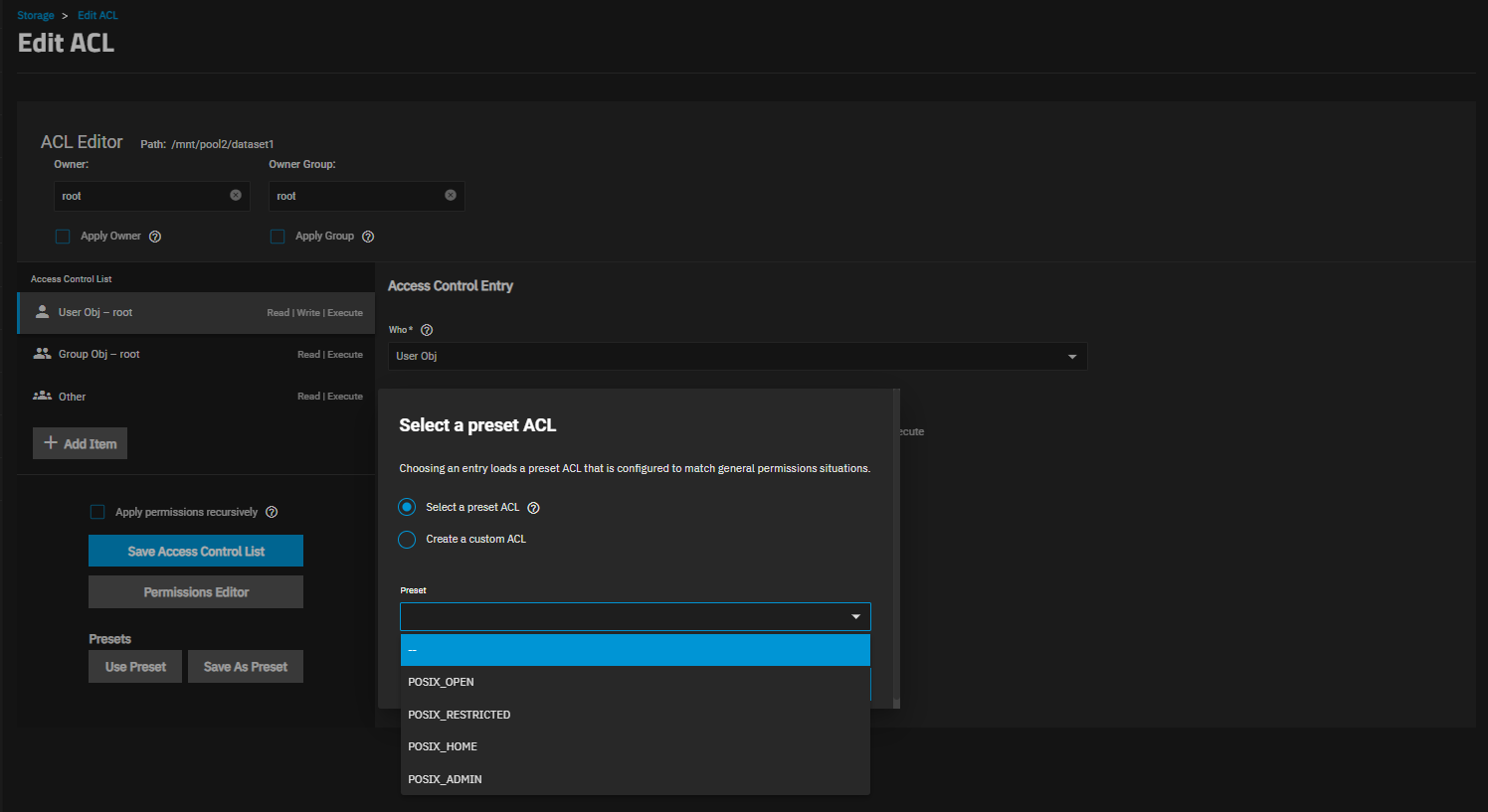

Edit Filesystem ACL Screen
Edit Filesystem ACL opens Datasets > Edit ACL screen for the shared dataset.
SMBACLEditor
The ACL editor screen lets you set permissions for the shared dataset. See Edit ACL Screens or Permissions for more information on configuring permissions.
