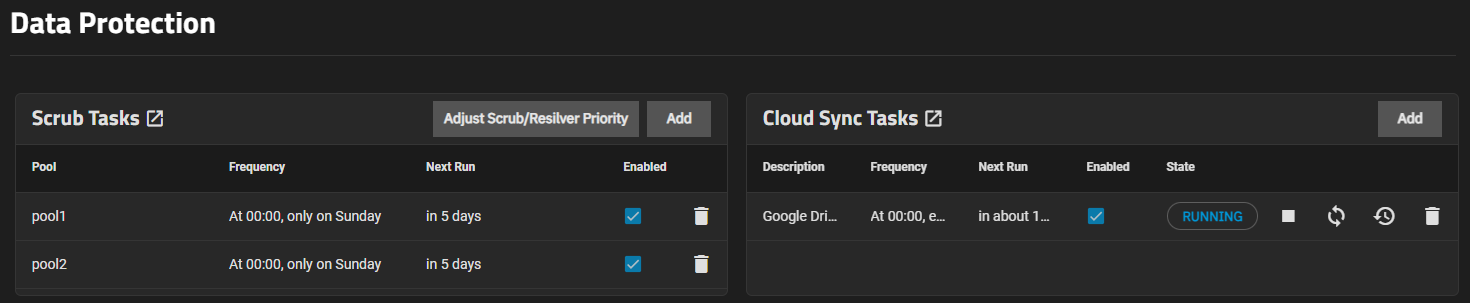

The Cloud Sync Task widget displays a list of tasks configured on the system.
Data Protection Cloud Sync Task
Figure 1: Data Protection Cloud Sync Task

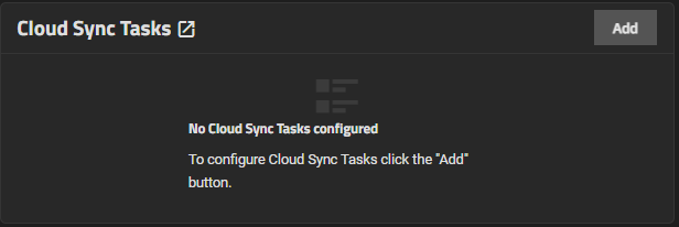

If cloud sync task are not yet configured No Cloud Sync Tasks configured displays in the widget.
No Cloud Sync Tasks
Figure 2: No Cloud Sync Tasks
Add opens the Add Cloud Sync Task screen. Each task listed is a link that opens the Edit Cloud Sync Task screen populated with with the settings for that task. Click on the Description, Frequency or Next Run column entry to open the edit task screen.
State displays the status of the next cloud sync task. Click on the state for the cloud sync task to display a Logs dialog for that task. Download Logs saves a copy of the current task logs.

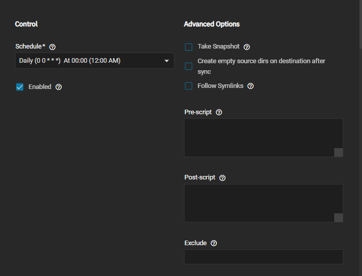

Control settings establish when the cloud sync task occurs.
Add Cloud Sync Task Control and Advanced Options
Figure 6: Add Cloud Sync Task Control and Advanced Options
SettingsDescription
ScheduleSelect a schedule preset or choose Custom to open the advanced scheduler.
EnabledSelect to enable this Cloud Sync Task. To disable this cloud sync task without deleting it and make the configuration available without allowing the specified schedule to run the task, clear the checkbox. You can use the Enable column on the Cloud Sync Tasks widget to enable or disable the task.
Advanced Options Settings
Advanced Options settings include settings for advanced users. Selecting Push in Direction adds the Take Snapshot option in Advanced Options.
SettingsDescription
Take SnapshotDisplays if Direction is set to Push. Select to take a snapshot before transfering data to the cloud storage provider.
Create empty source dirs on destination after syncSelect to create an empty source directory in the cloud storage provider folder when pushing data to the cloud provider location, or in TrueNAS if pulling data from the cloud storage provider.
Follow SymlinksSelect to follow symlinks and copy the items to which they link.
Pre-ScriptFor advanced users. Enter a script to execute before running sync. See the Cloud Sync tutorial for more information.
Post-ScriptFor advanced user. Enter a script to execute after running sync. See the Cloud Sync tutorial for more information.
ExcludeEnter a list of files and directories to exclude from sync. Separate entries by pressing Enter.
Examples of proper syntax used to exclude files/directories are:
  • photos</code> excludes a file named photos
  • /photos> excludes a file named photos from root directory (but not subdirectories)
  • photos/ excludes a directory named *photos
  • /photos/ excludes a directory named photos from root directory (but not subdirectories).
  • See rclone filtering for more details about the --exclude option.
