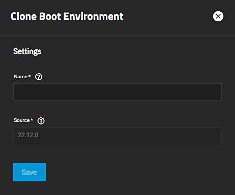

Cloning a Boot Environment
Cloning copies the selected boot environment into a new entry.
Click the more_vert for a boot environment, and then select Clone to open the Clone Boot Environment window.
CloneBootEnvironmentSCALE
Enter a new name using only alphanumeric characters, and/or the allowed dashes (-), underscores (_), and periods (.) characters.
The Source field displays the boot environment you are cloning. If the displayed name is incorrect, close the window and select the correct boot environment to clone.
Click Save.

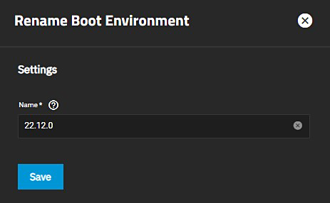

Renaming a Boot Environment
You can change the name of any boot environment on the System Settings > Boot screen.
Click the more_vert for a boot environment, and then select Rename to open the Rename Boot Environment window.
RenameBootEnvironmentSCALE
Verify the boot environment in Name is the one you want to rename.
Click Save.
