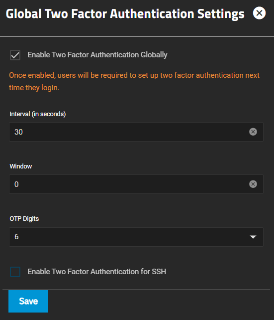

  1. Go to System Settings > Advanced, scroll down to the Global Two Factor Authentication widget, and click Config.
  2. Check Enable Two Factor Authentication Globally, then click Save.
    If you want to enable two-factor authentication for SSH logins, select Enable Two-Factor Auth for SSH before you click Save.
    TrueNAS will take you to the Two-Factor Authentication screen to finish 2FA setup.
    When using Google Authenticator, set Interval to 30 or the authenticator code might not function when logging in.

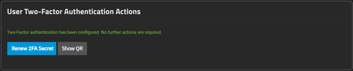

  3. Click Show QR and scan the QR code using Google Authenticator.
    After scanning the code click CLOSE to close the dialog on the Two-Factor Authentication screen.

To change the system-generated Secret, go to Credentials > 2FA and click Renew 2FA Secret.

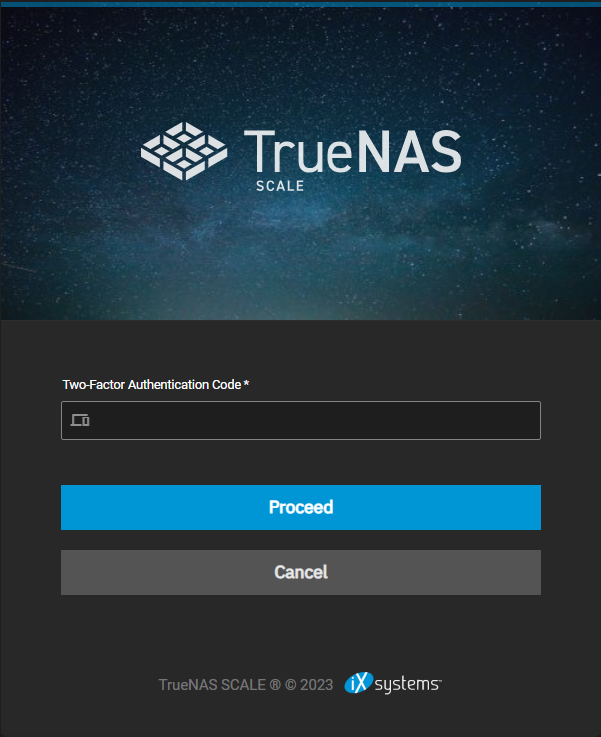

The login screen adds another field for the randomized authenticator code. If this field is not immediately visible, try refreshing the browser.
Enter the code from the mobile device (without the space) in the login window and use the root User name and password.
2FA Signin Splash Screen
Figure 4: 2FA Splash Screen.
If you wait too long, a new number code displays in Google Authenticator, so you can retry.
