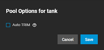

Setting Up Auto TRIM
Select Storage on the main navigation panel, locate the ZFS Health widget for the pool, and then click the Edit Auto TRIM. The Pool Options for poolname dialog opens.
Pool Edit Auto TRIM Dialog
Figure 2: Pool Edit Auto TRIM Dialog
Select Auto TRIM.
Click Save.
With Auto TRIM selected and active, TrueNAS periodically checks the pool disks for storage blocks it can reclaim. Auto TRIM can impact pool performance, so the default setting is disabled.
For more details about TRIM in ZFS, see the autotrim property description in zpool.8.

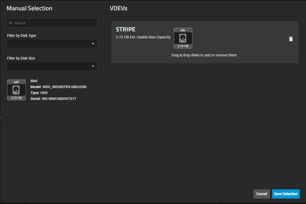

To use the automated option, select the disk size from the Automated Disk Selection > Disk Size dropdown list, then select the number of vdevs to add from the Width dropdown. To add the vdev manually, click Manual Disk Selection to open the Manual Selection screen.
Add Vdev Manual Selection Screen
Figure 6: Add Vdev Manual Selection Screen
Click Add to show the vdev options available for the vdev type. The example image shows adding a stripe vdev for the spare. TrueNAS limits Vdev options by the number of available disks in your system and the configuration of any existing vdevs of that type in the pool. Drag the disk icon to the stripe vdev, then click Save Selection.

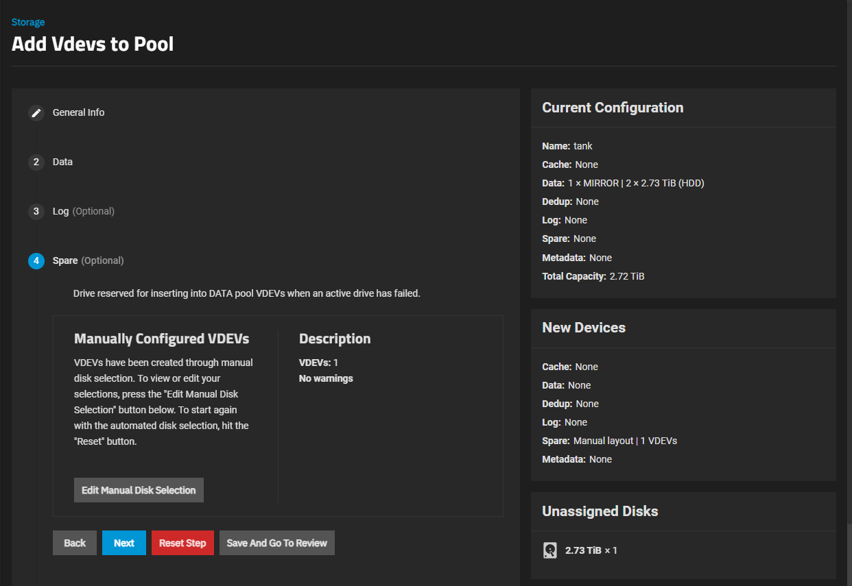

The Manual Selection screen closes and returns to the Add Vdev to Pool wizard screen (in this case, the Spare option.)
Add Vdev to Pool Spare with Vdev Added
Figure 8: Add Vdev to Pool Spare with Vdev Added
You can accept the change or click Edit Manual Disk Selection to change the disk added to the strip vdev for the spare. Or click Reset Step to clear the strip vdev from the spare completely. Click either Next or a numbered item to add another type of vdev to this pool.

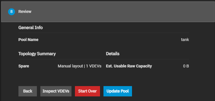

Click Save and Go to Review to go to the Review screen when ready to save your changes.
Add Vdev to Pool Review Screen
Figure 9: Add Vdev to Pool Review Screen
To make changes, click either Back or the vdev option (i.e., Log, Cache, etc.) to return to the settings for that vdev. To clear all changes, click Start Over. Select Confirm, then click Start Over to clear all changes.
To save changes, click Update Pool.

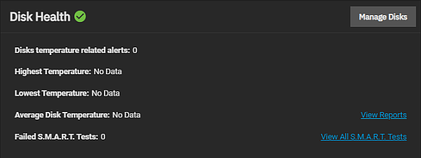

Use Scrub on the ZFS Health pool widget to start a pool data integrity check.
Disk Health Widget
Figure 10: Disk Health Widget
Click Scrub to open the Scrub Pool dialog. Select Confirm, then click Start Scrub.
If TrueNAS detects problems during the scrub operation, it either corrects them or generates an alert in the web interface.
By default, TrueNAS automatically checks every pool on a recurring scrub schedule.
The ZFS Health widget displays the state of the last scrub or disks in the pool. To view scheduled scrub tasks, click View all Scrub Tasks on the ZFS Health widget.

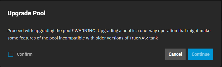

Upgrading a Pool
Storage pool upgrades are typically not required unless the new OpenZFS feature flags are deemed necessary for required or improved system operation.
Do not do a pool-wide ZFS upgrade until you are ready to commit to this SCALE major version and lose the ability to roll back to an earlier major version!
The Upgrade button displays on the Storage Dashboard for existing pools after an upgrade to a new TrueNAS major version includes new OpenZFS feature flags. Newly created pools are always up to date with the OpenZFS feature flags available in the installed TrueNAS version.
Upgrade Pool Confirmation Dialog
Figure 11: Upgrade Pool Confirmation Dialog
The upgrade itself only takes a few seconds and is non-disruptive. It is not necessary to stop any sharing services to upgrade the pool. However, we recommend upgrading when the pool is not in heavy use. The upgrade process suspends I/O for a short period but is nearly instantaneous on a quiet pool.
