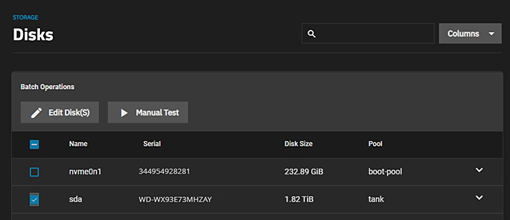

Select the disks you want to test using the checkboxes to the left of the disk names. Selecting multiple disks displays the Batch Operations options.
StorageDisksSelectedSCALE

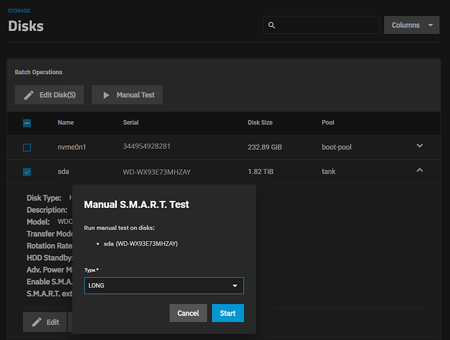

Click Manual Test. The Manual S.M.A.R.T. Test dialog displays.
Manual S.M.A.R.T. tests on NVMe devices is currently not supported.
StorageDisksManualTestSCALE
Next, select the test type from the Type dropdown and then click Start.
Test types differ based on the drive connection, ATA or SCSI. Test duration varies based on the test type you chose. TrueNAS generates alerts when tests discover issues.

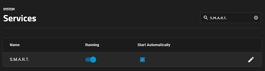

Start the S.M.A.R.T. service. Go to System Settings > Services and scroll down to the S.M.A.R.T. service. If not running, click the toggle to turn the service on. Select Start Automatically to have this service start after after the system reboots.
SMARTSystemServicesSCALE
If you have not configured the S.M.A.R.T. service yet, while the service is stopped, click to open the service configuration form. See Services S.M.A.R.T. Screen for more information on service settings. Click Save to save settings and return to the Services screen.
