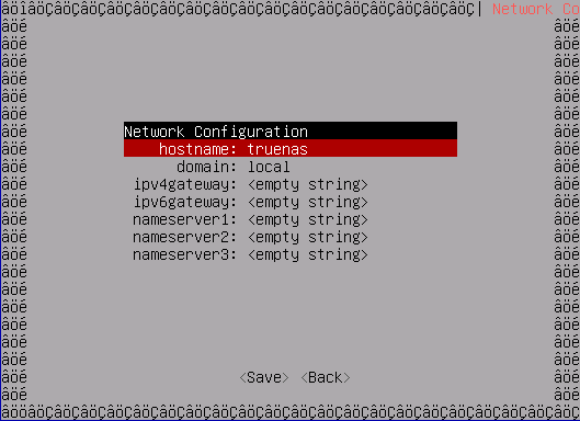

Enter 2 to display the Network Settings screen where you can set up the host name, domain, default gateway and name servers.
TrueNAS SCALE Console Setup Menu Edit Network Settings
Figure 4: TrueNAS SCALE Console Setup Menu Edit Network Settings

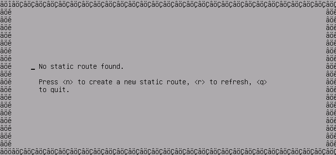

Enter 3 to display the Static Route Settings screen where you can set up any static routes. You can also add static routes in the web UI.
TrueNAS SCALE Console Setup Menu Static Routes
Figure 5: TrueNAS SCALE Console Setup Menu Static Routes
