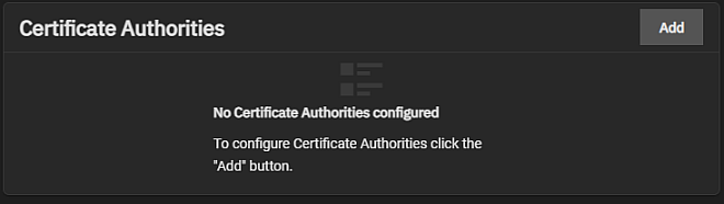

Last Modified 2023-08-31 13:31 EDTThe Certificate Authorities widget on the Credentials > Certificates screen displays certificate authorities(CAs) added to SCALE, and allows you to add new CAs, or download, delete, or edit the name of an existing CA.
The download icon downloads the CA to your server.
deletes the CA from your server.
Each CA listed on the widget is a link that opens the Edit CA screen.
Add opens the Add CA wizard that steps you through setting up a certificate authority (CA) that certifies the ownership of a public key by the named subject of the certificate.

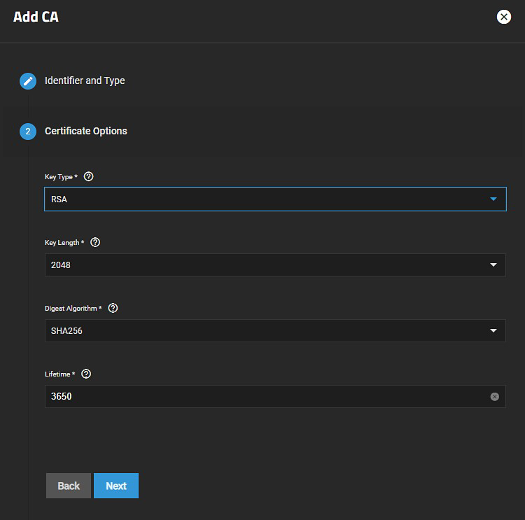

The Certificate Options settings specify the type of private key to use (as well as the number of bits in the key used by the cryptographic algorithm), the cryptographic algorithm the CA uses, and how many days the CA lasts.
The Certificate Options settings do not display if Type on the Identifier and Type screen is set to Import CA.
The Key Type selection changes fields displayed. RSA is the default setting in Key Type.

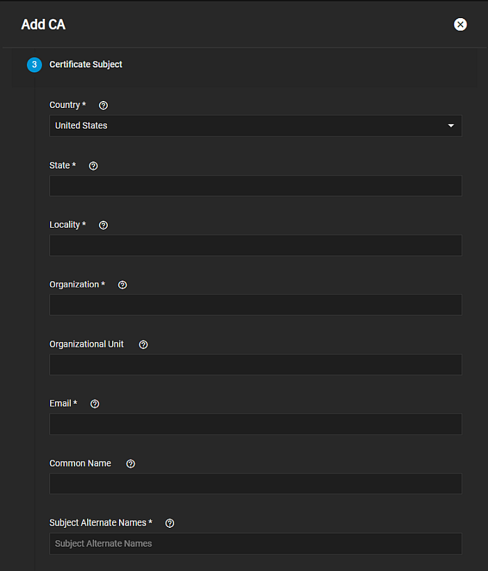

The Certificate Subject settings define the location, name, and email for the organization using the certificate.
Users can also enter the system fully-qualified hostname (FQDN) and any additional domains for multi-domain support.
The Certificate Subject settings do not display if Type on the Identifier and Type screen is set to Import CA.

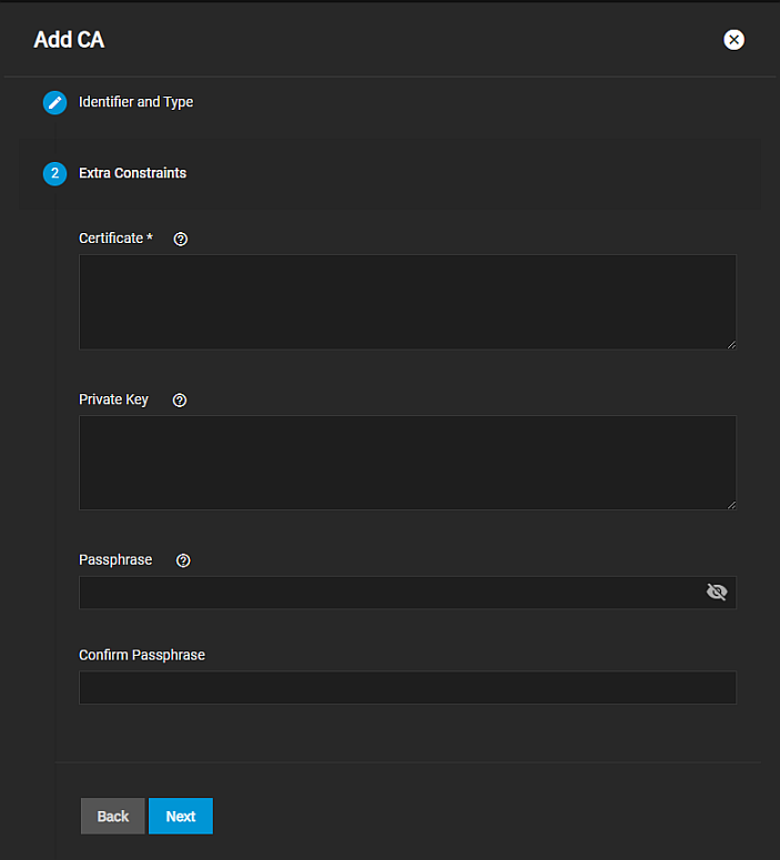

When Type on Identifier and Type is set to Import CA the Extra Constraints screen does not include the options to set extension types.

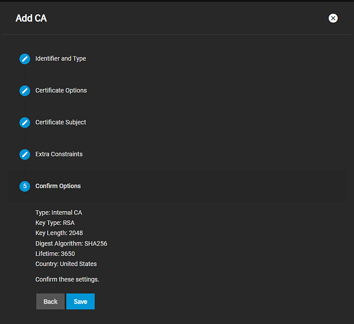

The final step screen is the Confirm Options that displays the CA Type, Key Type, Key Length, Digest Algorithm, Lifetime, Country, and any configured Usages. For Import CA type, the screen displays Type and Certificate.
Save adds the certificate to SCALE. Back returns to previous screens to make changes before you save. Next advances to the next screen in the sequence to return to Confirm Options.
