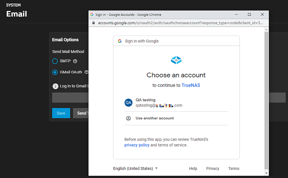

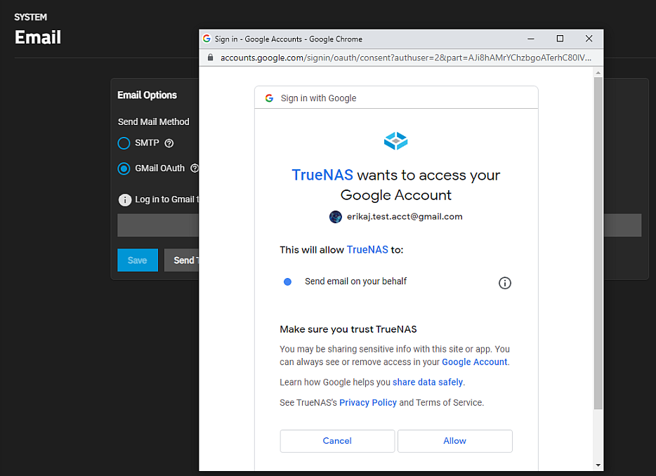

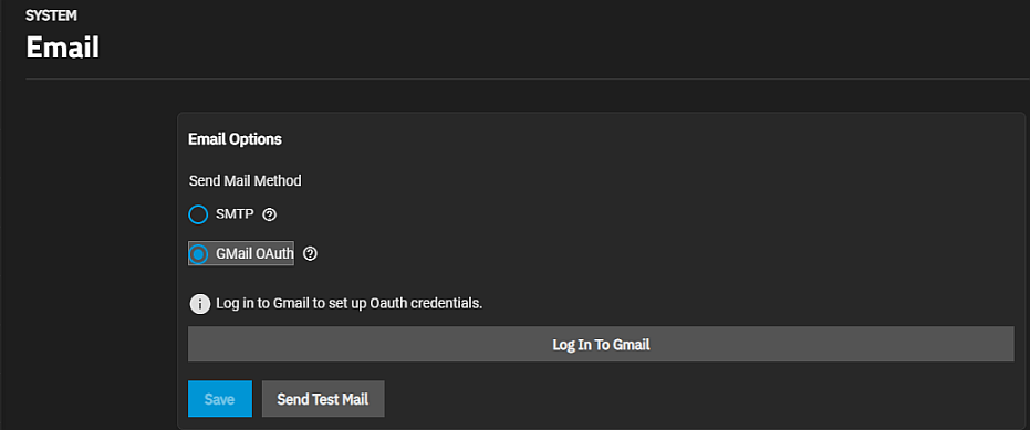

Click the Alerts icon in the top right of the UI, then click the gear icon and select Email to open the Email configuration screen.
The Send Mail Method shows two different options:
- SMTP
- GMail OAuth
The Email screen configuration options change based on the selected option.
After configuring the send method, click Send Test Mail to verify the configured email settings are working. If the test email fails, verify that the root user Email field is correctly configured for the root user. Return to Credentials > Users to select the admin user.
The Email screen displays with GMail OAuth preselected as the default send method.
