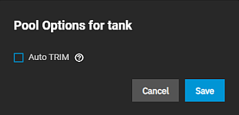

Select Storage on the main navigation panel and then click the Edit Auto TRIM on the ZFS Health widget for the selected pool to open the Pool Options for poolname dialog.
Select Auto TRIM.
Click Save.
With Auto TRIM selected and active, TrueNAS periodically checks the pool disks for storage blocks it can reclaim. Auto TRIM can impact pool performance, so the default setting is disabled.
For more details about TRIM in ZFS, see the autotrim
property description in zpool.8.

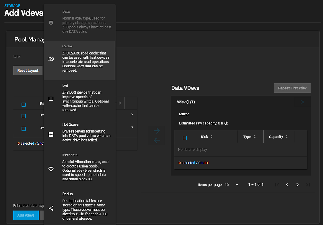

ZFS supports adding VDEVs to an existing ZFS pool to increase the capacity of the pool.
You cannot change the original encryption or data VDEV configuration.
To add a VDEV to a pool: Click Manage Devices on the Topology widget to open the Devices screen. Click Add VDEV on the Devices screen. The Add Vdevs to Pool version of the Pool Manager screen opens.
Click Add Vdev and select the type of VDEV you want to add.
Select the disk(s) you want to move to that VDEV and then click the to the left of the VDEV you just added to them to that VDEV.
Repeat for each type of VDEV you want to add to this pool.
Click Add Vdevs at the bottom of the screen to save the changes and close the Pool Manager screen. The Topology widget displays the newly added VDEVs.
You cannot add more drives to an existing data VDEV but you can stripe a new VDEV of the same type to increase the overall pool size. To extend a pool, you must add a data VDEV that is the same type as existing VDEVs.
To make a hot spare for a VDEV, click Add VDev and select Hot Spare. Move the disk you want to use to that Spare VDev before you click Add VDevs to save the changes to the pool.

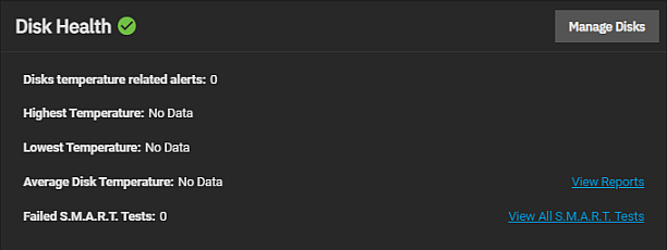

The Storage Dashboard screen Disks button and the Manage Disks button on the Disk Health widget both open the Disks screen.
