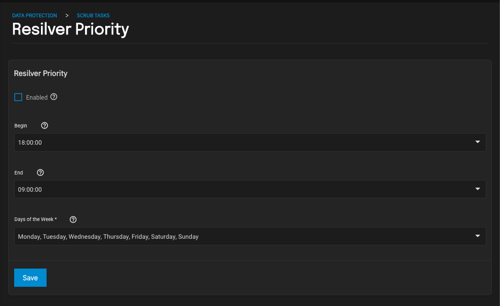

To schedule a new resilver task to run at a higher priority, select the hour and minutes from the Begin dropdown list.
To schedule a new resilver task to run at a lower priority to other processes, select the hour and minutes from the End dropdown list. Running at a lower priority is a slower process and takes longer to complete. Schedule this for times when your server is at its lowest demand level.
