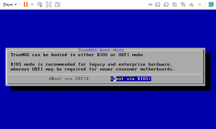

Choose to boot in UEFI mode or legacy CSM/BIOS mode. When installing TrueNAS, make the matching choice for the installation. For Intel chipsets manufactured in 2020 or later, UEFI is likely the only option.

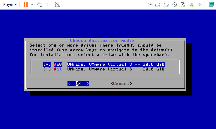

After installing SCALE on a virtual machine (VM), add virtual disks to the VM. You need a minimum of two disks, 16 GB each. One disk is for the boot environment the other for data storage.

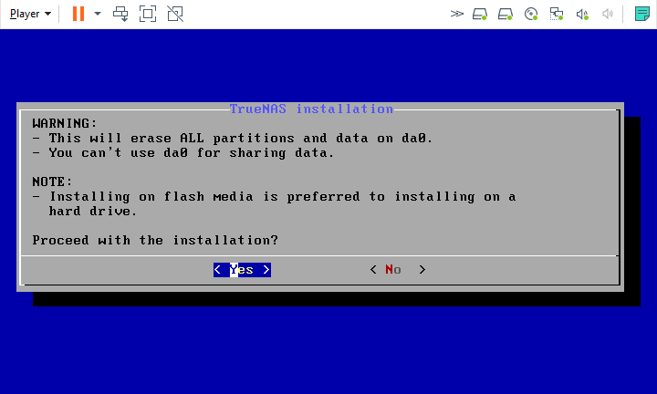

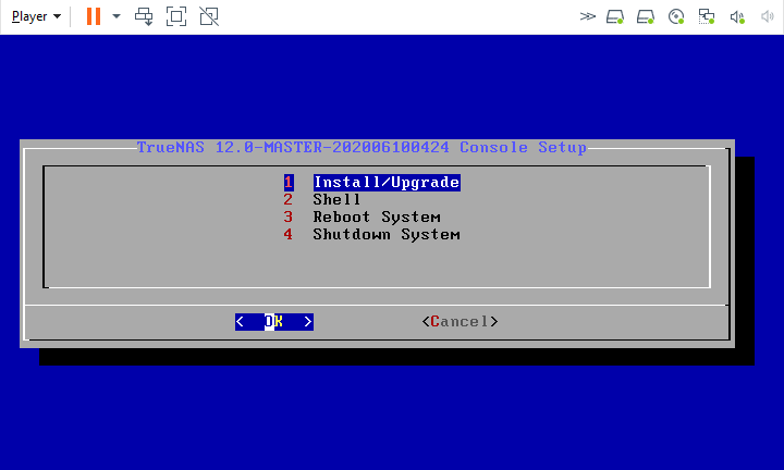

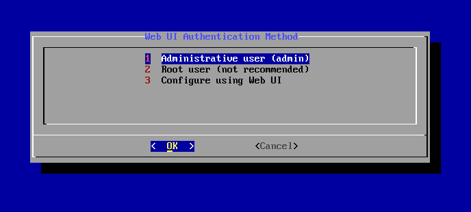

Just as with installing SCALE on physical hardware, you complete the install in the VM by booting into the TrueNAS installer.
Congratulations, TrueNAS SCALE is now installed!
