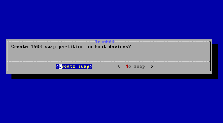

Install SCALE using the
iso file and select the Fresh Install option. Install on controller 1, then immediately begin installing on controller 2 in the other IPMI session to simultaneously install SCALE on both controllers.Disable DHCP, then enter the network settings to controller 1 using the Console Setup Menu. Enter the IP address and netmask assigned to controller 1, then enter the global network settings for host name, domain name, and nameservers.

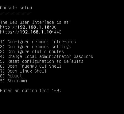

- Configure the required network settings on controller 1 with the Console setup menu.

Use this process to install the
If you are doing a clean install from the SCALE.iso file to recover from an issue that requires you to re-install SCALE from the.iso , have your network configuration information ready to use for controller 1 after the installation completes. Do not configure network settings on controller 2. Also have your SCALE system configuration file and data backups handy so you can recover your system settings and import your data into the recovered SCALE clean-install system.
After installing the SCALE

To use the Console setup menu to configure required network settings on controller 1:

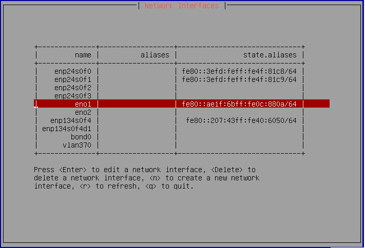

Type 1 and then press Enter to open the Network Interfaces screen.

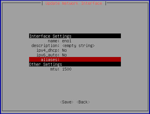

Use either Tab or the arrow keys to select the interface assigned as your primary network interface. If you have more than one interface installed and wired to your network, the primary interface is typically eno1. With the interface highlighted, press Enter to open the Update Network Interface screen.
Tab or arrow down to ipv4_dhcp and change it to no.
Tab or arrow down to the aliases setting and enter the static IP address for controller 1. Tab or arrow down to Save, and then press Enter. A pending network changes notice displays with additional options.
Type a to apply the change, then p to make it persist. Type q to return to the main Console setup menu.
Type 2 and then press Enter to open the Network Configuration screen.
Use either Tab or the arrow keys to select each field. Type the value for each field listed below. Press Enter after each value.
Field Description/Example hostname The host name you assign to controller 1. For example m50-123-1. domain The domain name for the nework controller 1. For example my.companyname.net ipv4gateway The default gateway IP address for your network. nameserver1
nameserver2The IP addresses for your network DNS servers. Use either Tab or the arrow keys to select Save, then type q to return to the main Console setup menu.

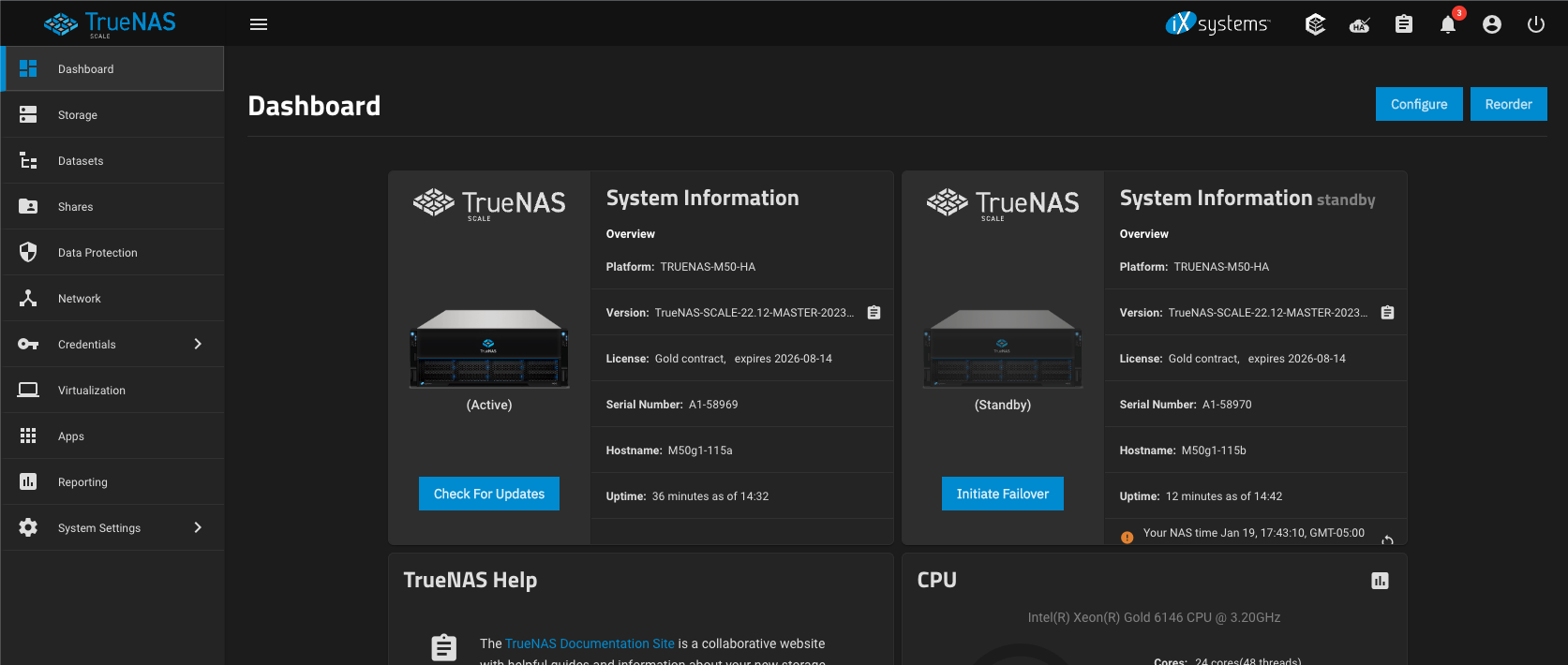

When the system comes back up, log into SCALE using the virtual IP address. The main Dashboard displays two System Information widgets. In standard configurations by iXsystems, Controller 1 shows its serial number and a host name that includes the letter a. Controller 2 is labeled as Standby Controller and shows its serial number and a host name that includes the letter b. Take note of this information.
If controller 2 comes on line as the primary and controller 1 as the standby, you installed and configured these controllers incorrectly. Go to System Settings > Failover, clear the Default TrueNAS Controller option, and click Save. The system reboots and fails over to the current standby controller (in this case, to controller 1). Log back into the UI with the VIP address, go to System Settings > Failover and select Default TrueNAS Controller to make controller 1 the primary controller. and then select Sync to Peer. SCALE makes controller 2 the standby controller and syncs the configuration on controller 1 to controller 2. Click Save.
