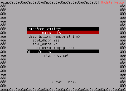

1) Configure network interfaces
Use this to configure the primary network interface with a static IP. This is for switching away from the DHCP-assigned IP address TrueNAS provides when the system boots after installing SCALE. Also, use this to set up other network interfaces or to add alias IP addresses for the primary interface.

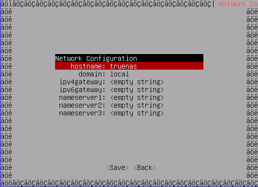

2) Configure network settings
Use this to set up the network default gateway, host name, domain, IPv4 gateway and DNS name servers. Configured options display in the Global Configuration widget in the web UI Network screen.

Enter 1 to display the Configure Network Interfaces screen where you can select the interface settings.
Follow the instructions on the screen to configure an IP for a network interface. Type n to open the new interface screen or press Enter to edit the existing interface.
You can enter aliases for an interface when you create a new one or edit an existing interface.
Type q to to return to the main Console setup menu screen.
Enter 2 to display the Network Settings screen where you can set up the host name, domain, default gateway and name servers.

To use the Console setup menu to change the network interface IP address, type 1 and then press Enter to open the Configure Network Interfaces screen. Use either Tab or the arrow keys to select the interface to use as your primary network interface if you have more than one interface installed and wired to your network. Type in the IP address then use either Tab or the arrow keys to move through the menu and down to select Save, and then press Enter. After saving, return to the main Console setup menu by entering q.
To configure the default gateway, host name, domain and DNS name severs using the Console setup menu type 2 and then press Enter to open the Network Settings screen.
