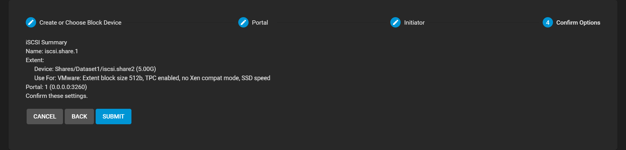

Users can configure an iSCSI block share using either the wizard or the individual configuration screens. The wizard steps users through the configuration process in an ordered sequence. Using the seven tabs on the iSCSI screen allows users to configure settings in any order they choose (a manual process).
The iSCSI Wizard configuration forms guide users through the process of setting up an iSCSI block share. Click WIZARD to display the first configuration screen.
Use Next to advance to the next wizard configuration form. Use Back to return to a previous wizard configuration form. Use Cancel to exit the configuration wizard.
Wizard Configuration Screens and Settings
Create or Choose Block Device Screen Settings
| Setting | Description |
| Name | Type a lower case alphanumeric character string that can include a dot (.), dash (-), or colon (:). Keep the string short and do not exceed 63 characters. |
| Extent Type | Choose either Device or File. If selecting Device use a zvol created for the share. If selecting File also select the path to the extent and include the file size. |
| Device | Required field. Create New or select from devices listed |
| Sharing Platform | Select from the options provided: VMware: extent block size 512b, TCP enabled, no Xen compat mode, SSD speed Xen: Extent block size 512b, TCP enabled, Xen compat mode enabled, SSD speed Legacy OS: Extent block size 512b, TCP enabled, no Xen compat mode, SSD speed Modern OS: Extent block size 4k, TCP enabled, no Xen compat mode, SSD speed Use Moderon OS for updated operating systems like Linux OS.  |

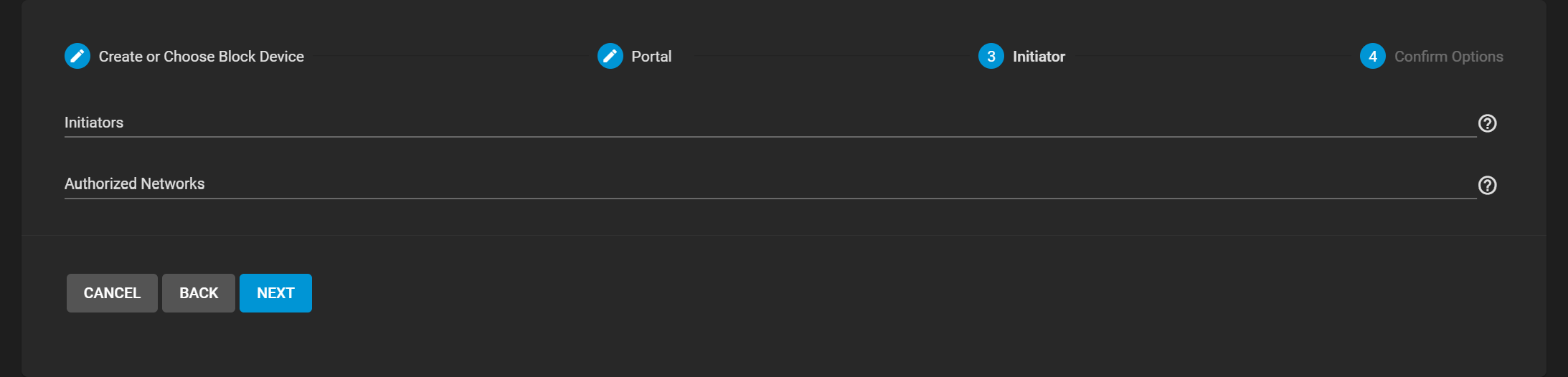

Initiator Screen Settings
| Initiators | Leave blank to allow all host names or to enter a list of initiator host names. Use the keyboard Enter after entering each host name to save. |
| Authorized Networks | Network addresses allowed to use this initiator. Leave blank to allow all networks or list all network addresses with a CIDR mask. Separate each entry with the keyboard Enter. |

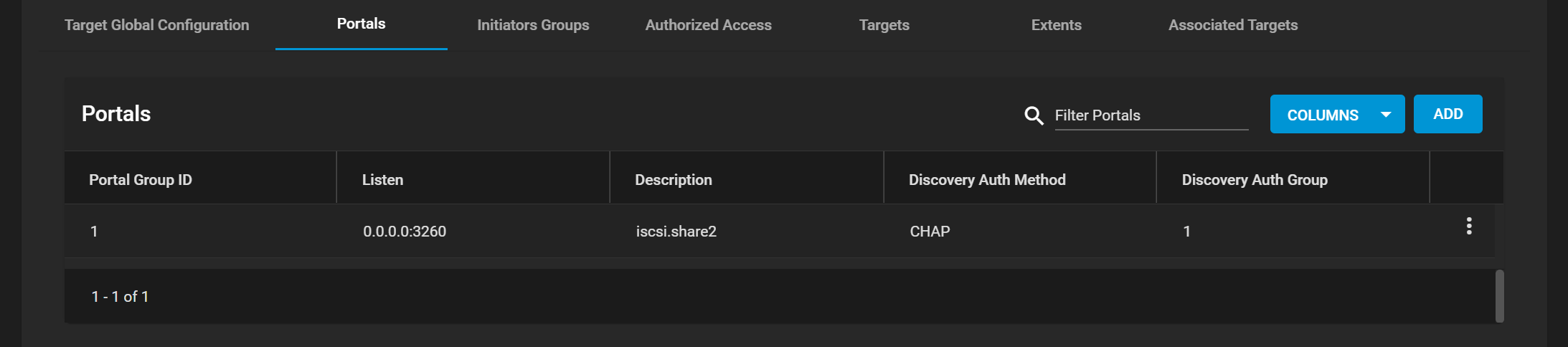

Portals Tab
The Portals screen displays a list of configured portals. It lets users create new portals or edit the existing ones in the list. Use the blue Columns dropdown list to display a list of available options to add or remove columns in the Portals table. Select from Unselect All, Listen, Description, Discovery Auth Method, Discover Auth Group or Reset to Defaults to reverse any changes you made to the table.
Use ADD to display the Portals Add configuration form. Click the more_vert icon for the portal and select Edit to display the Portal Edit configuration form. Both the Add and Edit forms have the same settings fields.

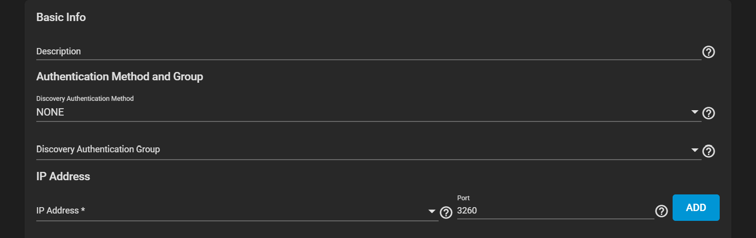

Basic Info
| Description | Optional description. Portals are automatically assigned a numeric group. |
Authentication Method and Group
| Discovery Authentication Method | iSCSI supports multiple authentication methods that the target uses to discover valid devices. None allows anonymous discovery while CHAP and Mutual CHAP require authentication. |
| Discovery Authentication Group | Group ID created in Authorized Access. Required when the discovery authentication method is CHAP or Mutual CHAP. |
IP Address
| IP Address | Select the IP addresses the portal uses to listened on. Click ADD to add IP addresses with a different network port. 0.0.0.0 listens on all IPv4 addresses and :: listens on all IPv6 addresses. |
| Port | TCP port used to access the iSCSI target. Default is 3260. |
| ADD | Adds another IP address row. |

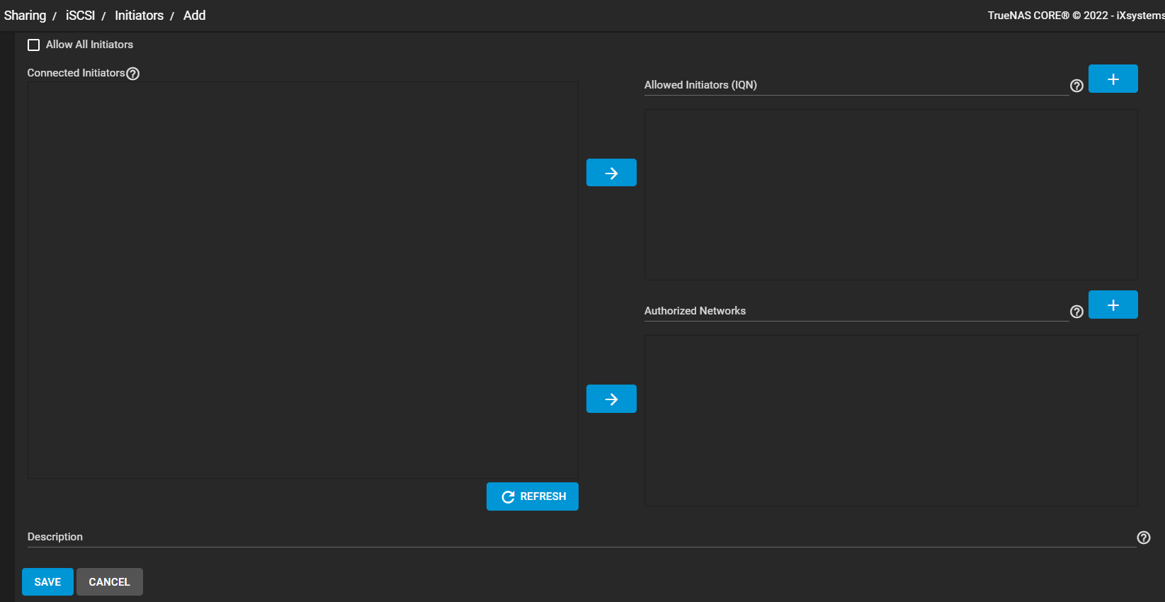

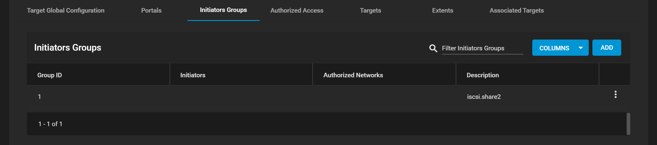

Initiators Groups Tab
The Initiators Groups screen displays a lis of configured initiators. It lets users create new authorized access client groups or edit existing ones on the list. Use the blue Columns dropdown list to display a list of available options to add or remove columns in the Initiator Groups table. Select from Unselect All, Initiators, Authorized Networks, Description or Reset to Defaults to reverse any changes you made to the table.
Use ADD to display the Initiators Add configuration screen. Click the more_vert icon for the initiator and select Edit to display the Initiators Edit configuration form. Both the Add and Edit forms have the same settings fields.
| Connected Initiators | Initiators currently connected to the system, displayed in the IQN format with an IP address. Set initiators and click an to add the initiators to either the Allowed Initiators or Authorized Networks lists. Click Refresh to update the list of connected initiators. |
| Allow All Initiators | Allows all initiators when selected. If not selected, configure your own allowed initiators and authorized networks. |
| Allowed Initiators (IQN) | Initiators allowed access to this system. Enter an iSCSI Qualified Name (IQN) and click the to add it to the list. Example: iqn.1994-09.org.freebsd:freenas.local. |
| Authorized Networks | Network addresses allowed use this initiator. Each address can include an optional CIDR netmask. Click to add the network address to the list. Example: 192.168.2.0/24. |
| Description | Enter any notes about initiators. |
| REFRESH | Refreshes the list displayed in Connected Initiators. |
| SAVE | Saves changes made on the Add or Edit initiator screens. |
| CANCEL | Discards changes made on and closes the Add or Edit initiator screens. |

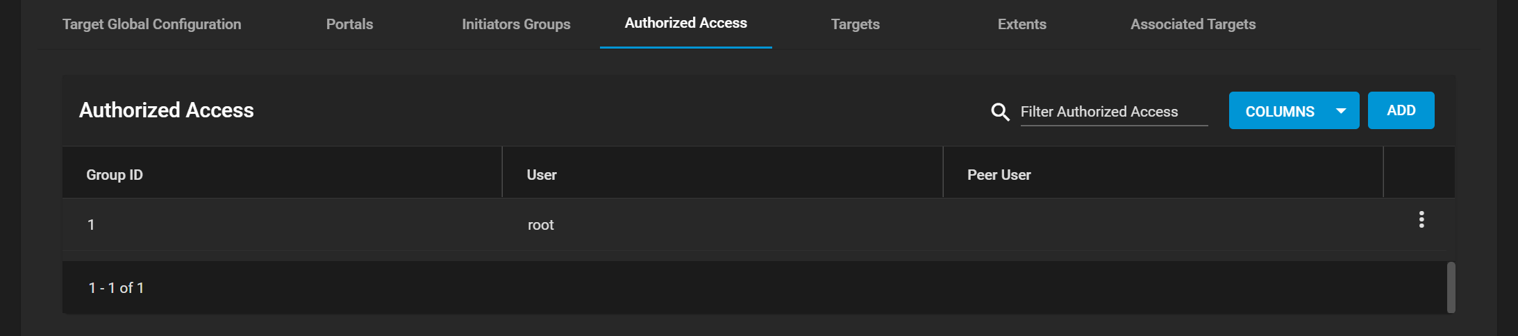

Authorized Access Tab
The Authorized Access screen displays a list of authorized access networks. It lets users create new authorized access networks or edit existing ones in the list. Use the blue Columns dropdown list to display a list of available options to add or remove columns in the Initiator Groups table. Select from Unselect All, User, Peer User or Reset to Defaults to reverse any changes you made to the table.
Use ADD to display the Authorized Access Add configuration screen. Click the more_vert icon for the authorized access and select Edit to display the Authorized Access Edit configuration form. Both the Add and Edit forms have the same settings fields.

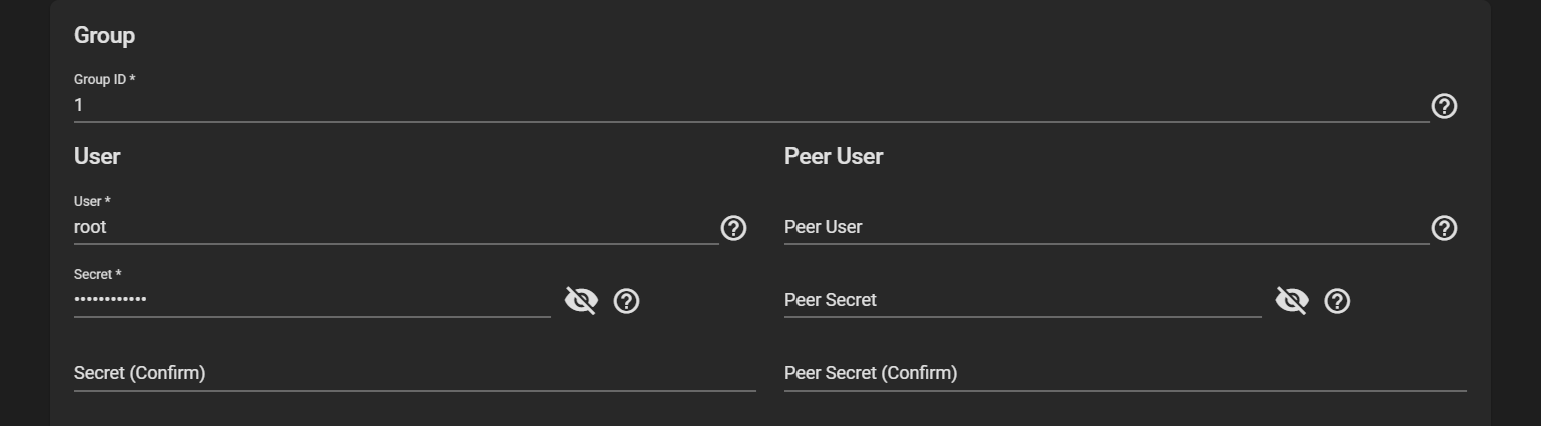

Group
| Group ID | Allow you to configure different groups with different authentication profiles. For example, all users with a group ID of 1 inherit the authentication profile associated with Group 1. |
User
| User | User account to create for CHAP authentication with the user on the remote system. Many initiators use the initiator name as the user name. |
| Secret | User password of at least 12 but no more than 16 characters. Click the icon to display the characters you typed to verify you typed the desired password string. Click to hide the password string. |
| Secret (Confirm) | Confirm the user password. |
Peer User
| Peer User | Only entered when configuring mutual CHAP. Usually the same value as User. |
| Peer Secret | Mutual secret password. Required when Peer User is set up. Must be different than the password used in Secret. Click the icon to display the characters you typed to verify you typed the desired password string. Click to hide the password string. |
| Peer Secret (Confirm) | Confirm the mutual secret password. |

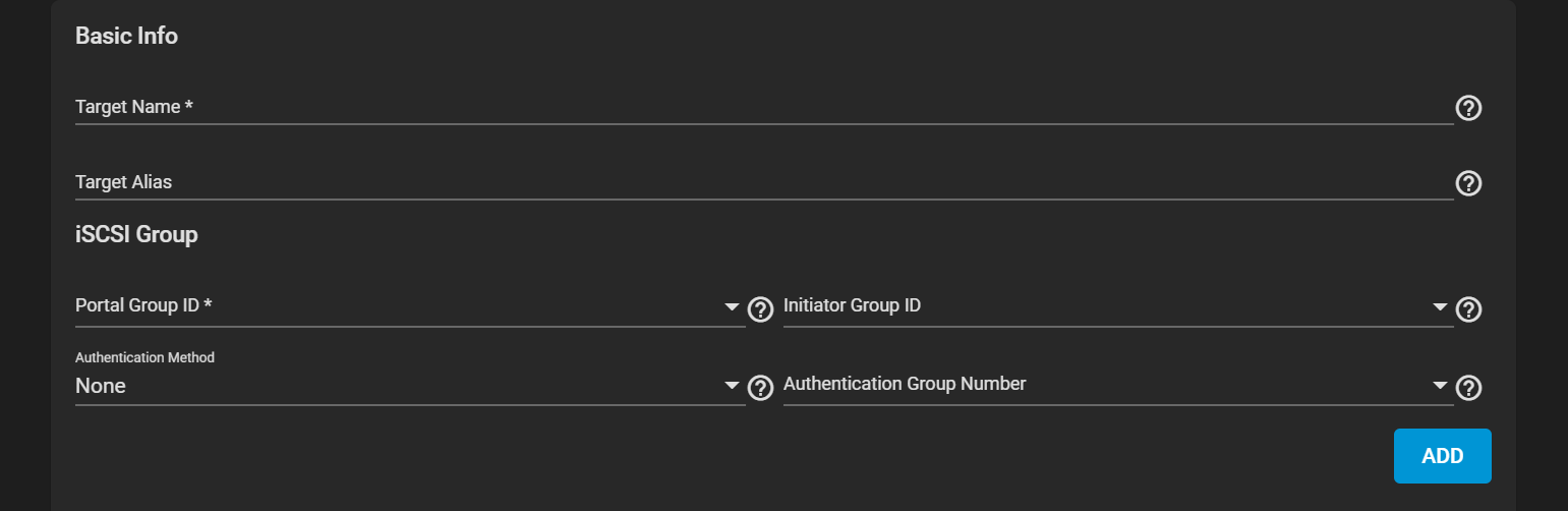

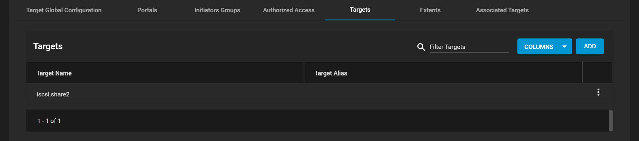

Targets Tab
The Targets screen displays a list of storage resources configured in the system. It lets users create new TrueNAS storage resources or edit existing ones in the list. Use the blue Columns dropdown list to display a list of available options to add or remove columns in the Targets table. Select from Unselect All, Target Alias or Reset to Defaults to reverse any changes you made to the table.
Use ADD to display the Targets Add configuration screen. Click the more_vert icon for the target and select Edit to display the Targets Edit configuration form. Both the Add and Edit forms have the same settings fields.
Basic Info
| Target Name | The base name for the target. It is automatically prepended if the target name does not start with iqn. Allowed characters are lowercase alphanumeric characters plus dot (.), dash (-), and colon (:). See the “Constructing iSCSI names using the iqn.format” section of RFC3721. |
| Target Alias | Optional user-friendly name for the Target Name. |
iSCSI Group
| Portal Group ID | Leave empty or select an existing portal to use. If you click the dropdown arrow, you must select a portal group ID from the list. |
| Initiator Group ID | Select the existing initiator group that has access to the target. Leave empty if Portal Group ID is empty. |
| Authentication Method | Select None, CHAP, or Mutual CHAP. |
| Authentication Group Number | Select None or an integer. This value represents the number of existing authorized accesses. |

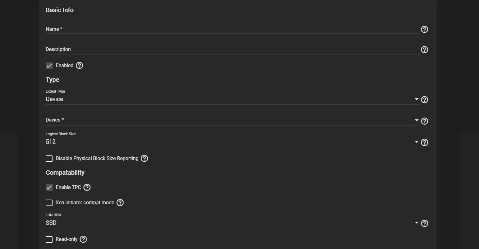

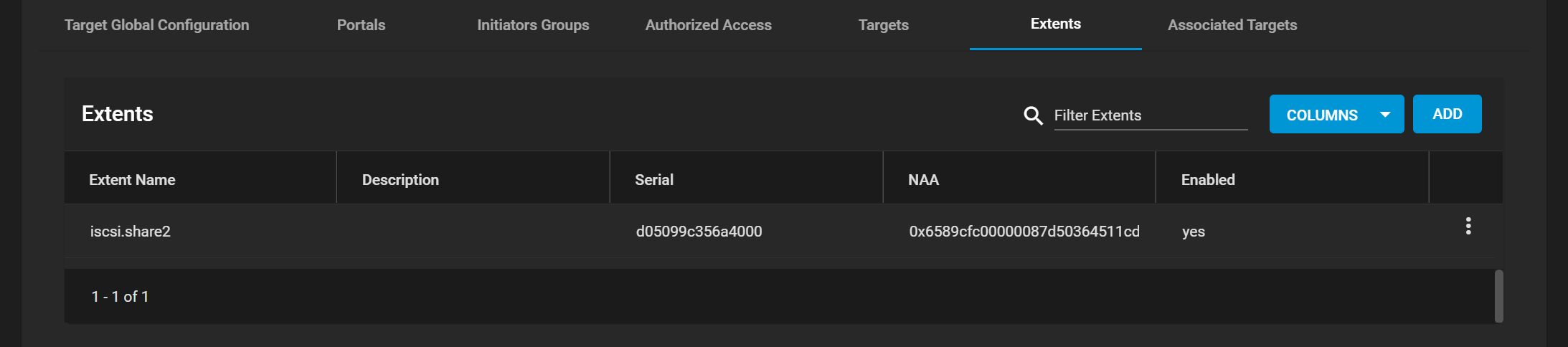

Extents Tab
The Extents screen displays a list of available shared storage units configured on the system. It lets users create new shared storage units or edit existing ones in the list. Use the blue Columns dropdown list to display a list of available options to add or remove columns in the Extents table. Select from Unselect All, Description, Serial, NAA, Enabled or Reset to Defaults to reverse any changes you made to the table.
Use ADD to display the Extents Add configuration screen. Click the more_vert icon for the shared storage unit and select Edit to display the Extents Edit configuration form. Both the Add and Edit forms have the same settings fields.
Basic Info
| Name | Name of the extent. An extent with a size of zero can be an existing file within the pool or dataset. An extent with a size other than zero cannot be an existing file within the pool or dataset. |
| Description | Type any notes about this extent. |
| Enabled | Select to enable the iSCSI extent. |
Type
| Extent Type | Specify the storage unit type. Select Device or File from the dropdown list. Device provides virtual storage access to zvols, zvol snapshots, or physical devices. File provides virtual storage access to a single file. |
| Device | Only displays only if Device is the selected in Extent Type. Select the unformatted disk, controller, or zvol snapshot. |
| Path to the Extent | Only displays if the Extent Type is set to File. Browse to an existing file. Create a new file by browsing to a dataset and appending /{filename.ext} to the path. Users cannot create extents inside a jail root directory. |
| Filesize | Only displays if the Extent Type is set to File. Enter 0 to use the actual file size and it requires that the file already exists. Otherwise, specify the file size for the new file. |
| Logical Block Size | Leave at the default of 512 unless the initiator requires a different block size. Select from 512, 1024, 2048 or 4096 on the dropdown list. |
| Disable Physical Block Size Reporting | Select if the initiator does not support physical block size values over 4K (MS SQL). |
Compatibility
| Enable TPC | Select to allow an initiator to bypass normal access control and access any scannable target. This allows xcopy operations that are otherwise blocked by access control. |
| Xen initiator compat mode | Select when using Xen as the iSCSI initiator. |
| LUN RPM | Do not change this setting when using Windows as the initiator! Only change the default SSD setting if in a large environment where you need a number of systems using a specific RPM for accurate reporting statistics. Options are SSD, 5400, 7200, 10000 or 15000. |
| Read-only | Select to prevent the initiator from initializing this LUN. |

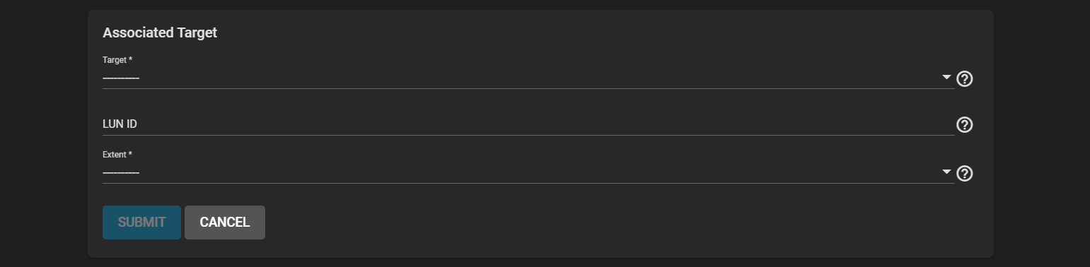

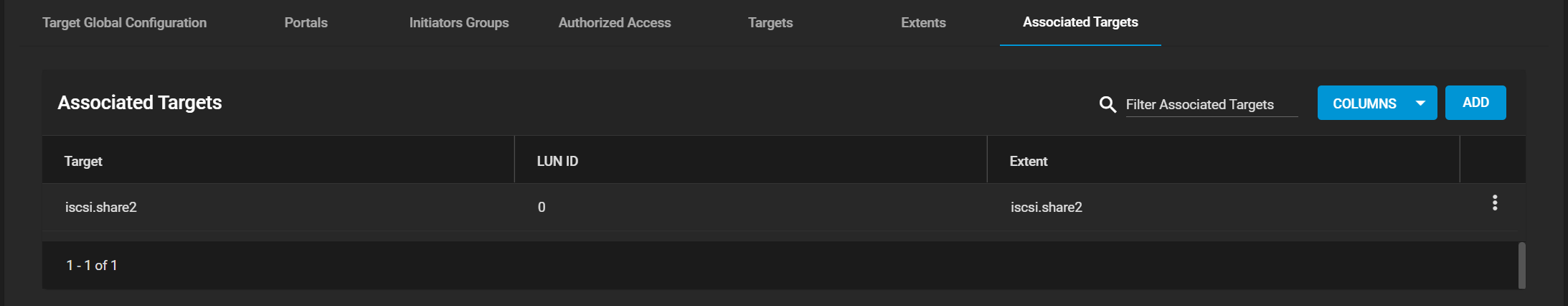

Associated Targets Tab
The Associated Targets screen displays a list of associated TrueNAS storage resources configured on the system. It lets users create new associated TrueNAS storage resources or edit existing ones in the list. Use the blue Columns dropdown list to display a list of available options to add or remove columns in the Associated Targets table. Select from Unselect All, LUN ID, Extent or Reset to Defaults to reverse any changes you made to the table.
Use ADD to display the Associated Targets Add configuration screen. Click the more_vert icon for the associated TrueNAS storage resource and select Edit to display the Associated Targets Edit configuration form. Both the Add and Edit forms have the same settings fields.
| Target | Select an existing target. This is a required field. |
| LUN ID | Select the value or enter a value between 0 and 1023. Some initiators expect a value below 256. Leave this field blank to automatically assign the next available ID. |
| Extent | Select an existing extent. This is a required field. |
