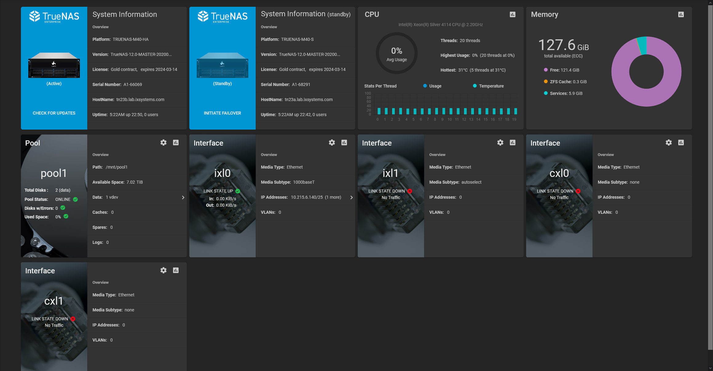

In the web interface Dashboard, find the entry for the active TrueNAS controller and click CHECK FOR UPDATES. This button changes to UPDATES AVAILABLE when there is an available update.
Clicking the button goes to System > Update and shows the option to Download Updates or, when the system has detected and staged an update, Apply Pending Update.

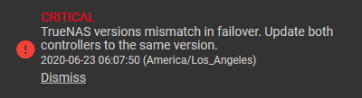

Update progress displays for both TrueNAS controllers. The standby TrueNAS controller reboots when it finishes updating. This can take several minutes. When the standby controller finishes booting, the system must fail over to update and reboot the active TrueNAS controller.

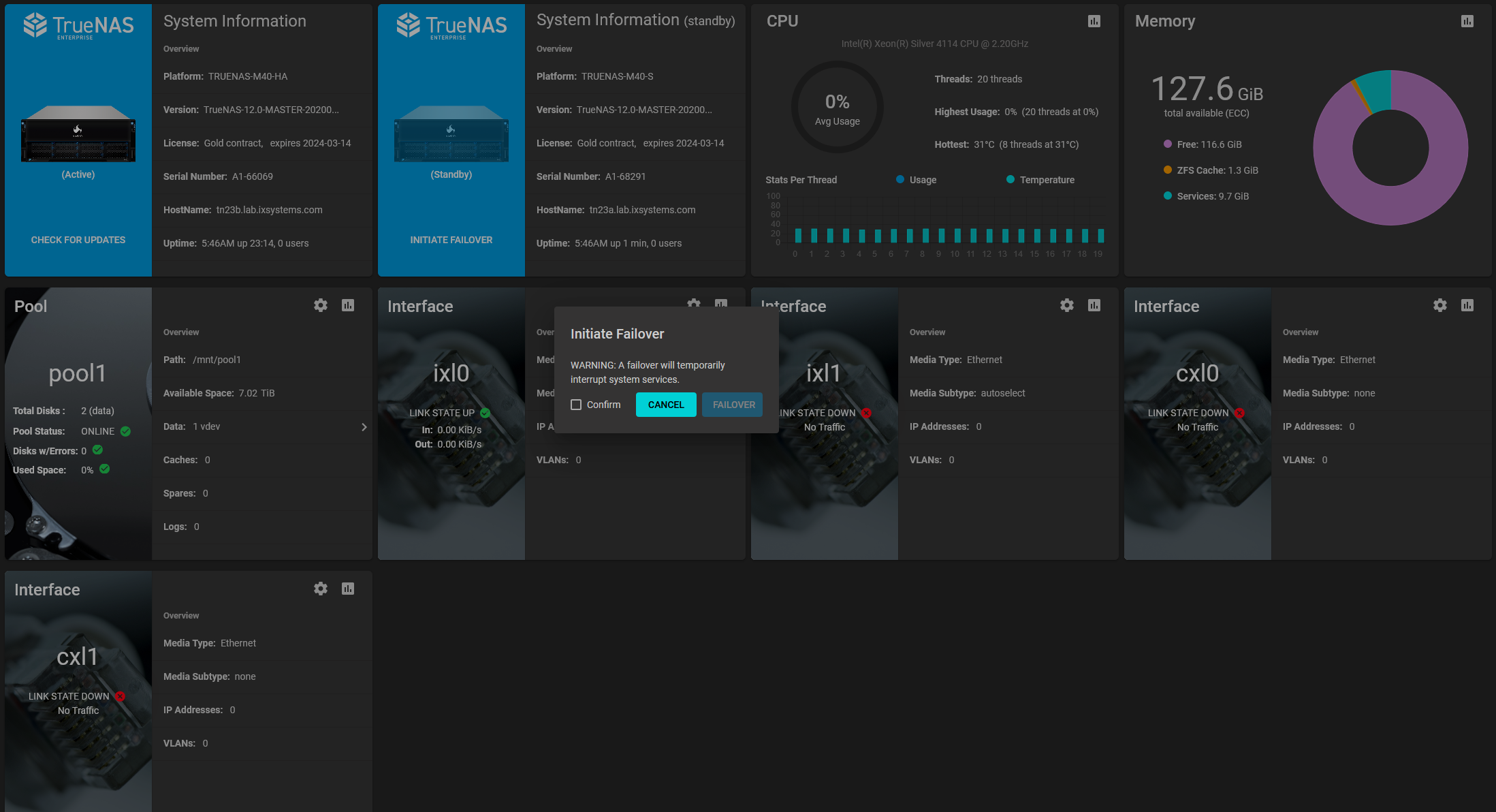

To deactivate the active TrueNAS controller and finish the update, go to the Dashboard, find the entry for the Standby controller, and click INITIATE FAILOVER.

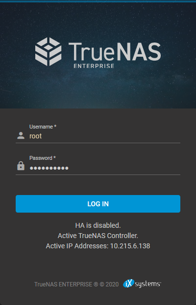

The failover briefly interrupts TrueNAS services and availability. The browser logs out of the web interface while the active TrueNAS controller deactivates and the standby TrueNAS controller is brought online. The web interface login screen reappears when the standby TrueNAS controller finishes activating.
Log in to the web interface and check the cloud HA status in the top toolbar. This icon shows that HA is unavailable while the previously active TrueNAS controller reboots. When HA is available, a dialog asks to finish the update. Click CONTINUE to finish updating the previously active TrueNAS controller.
