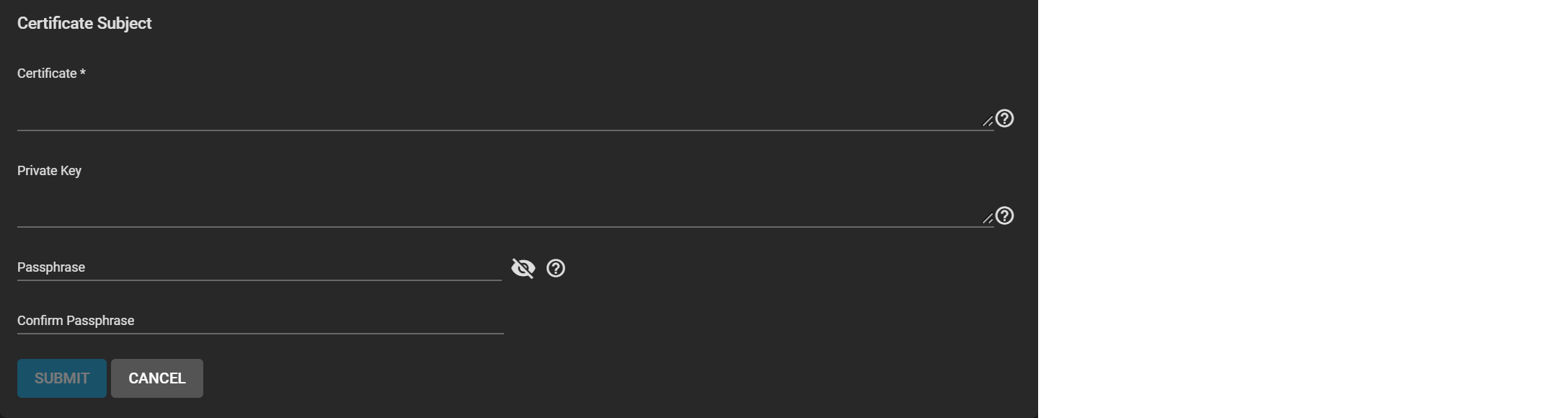

Setting | Description |
Certificate | Paste the certificate for the CA. |
Private Key | Paste the private key associated with the Certificate when available. Provide a key at least 1024 bits long. |
Passphrase | Enter the passphrase for the private key. |
Confirm Passphrase | Confirm the passphrase for the Private Key. |
