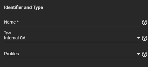

  1. Enter or select the Identifier and Type setting options.
    AddInternalCAIdentTypeNoProfile
    a. Enter a name for this CA. b. Select Internal CA from the Type dropdown list to create an internal certificate. Select Intermediate CA to create an intermediate certificate. This displays the Signing Certificate Authority field in Certificate Options.

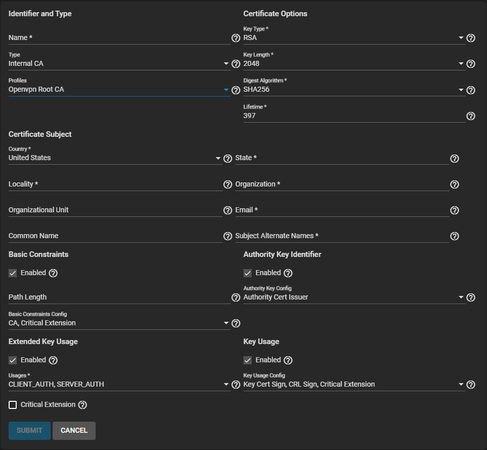

    To add an OpenVPN Root CA, select OpenVPN Root CA. The configuration form populates with default settings, enables Basic Constraints, Authority Key Identifier, Extended Key Usage, and Key Usage, and sets the options for each extension.
    AddInternalCAOpenVPNRootProfile

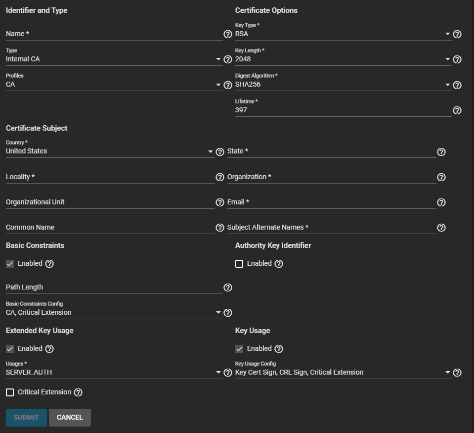

    To add CA certificate, select CA. The configuration form populates with default settings, enables Basic Constraints, Authority Key Identifier, Extended Key Usage, and Key Usage, and sets the options for each extension.
    AddInternalCAProfile

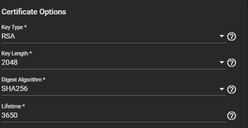

  3. Select the Certificate Options.
    AddInternalCACertOptionsNoProfile
    a. Select a Key Type from the dropdown list. We recommend the RSA key type. Use EC for elliptic curve certificates.
    b. Select the Key Length. We recommend a minimum of 2048 for security reasons.
    c. Select a Digest Algorithm. We recommend SHA256.
    d. Enter the Lifetime of the CA in days to set how long the CA remains valid.

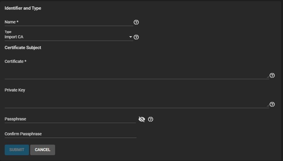

Importing a CA
Use this procedure to import a CA.
  1. Enter a name for this certificate.
    ImportCA
  2. Select Import CA from the Type dropdown list.
  3. Copy the certificate for the CA you want to import and paste it into the Certificate field.
  4. Paste the certificate private key of at least 1024 bits in length into Private Key when available.
  5. Enter and confirm the passphrase for the private key into Passphrase and Confirm Passphrase.
  6. Click Submit.
