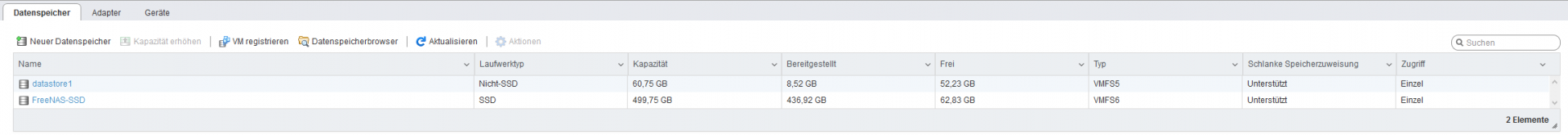

So I have a pool on SSD only for datastores. Within this I have a ZVOL called Poseidon-SSD, with a compression ratio of 2.09x and a size of around 55GB. On the ESXi side, where I connect via iSCSI to FreeNAS/ZVOL.
Now ESXi reports me the size of the ZVOL of available 500GB (thats correct) and the used size of 410GB. This is incorrect in two ways.
1. On the ZVOL only 55GB is occupied. How do I menage to push this also to ESXi?
2. Even with compression of 2.x Its might be about 120GB and not 410GB in size. How could this happen?

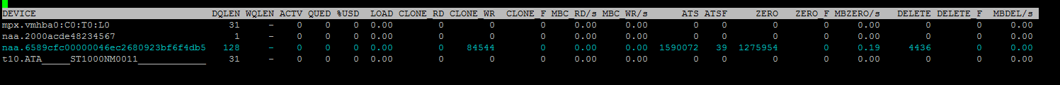

You can check to see if you have any UNMAP errors from the ESXi host. ssh to the host and run the below commands:
esxtop
u
f (choose a and o) and press enter.
You'll now see the VAAI stats for the disks. You'll want to pay attention to DELETE and DELETE_F. These are the unmap stats. If you have a lot of DELETE_F then something is wrong with your setup. So get this console up, put some test files on the datastore and then delete them. You have to delete them from the vSphere web client (not from some other utility as they may not send proper unmap commands to the ESXi host). If you have a guest that meets the requirements for in-guest UNMAP support and your host is configured for it, you can delete files from within the guest to test as well.

I have attached the esxitop output, from this point all looks fine.
I have also attached a picture of the ESXi view, where you can see how much space is used.
If you have any other idea, you're welcome :)

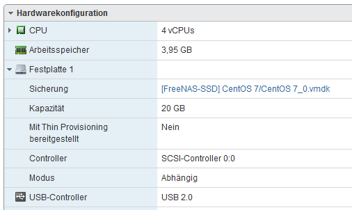

So I looked into the VMs information.
As you can see in the image
It says Thin provisioned "NO".

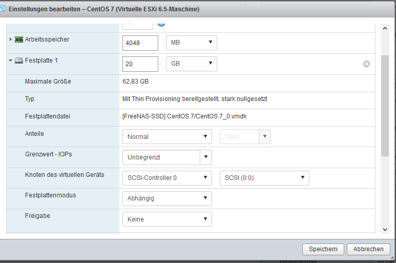

When I go into the VMs options:
It says in english: With Thin-provisioning provided, strongly zeroed.
But I am sure I have created these one all with thin-provision.
Maybe this is the overall fault here? :/
