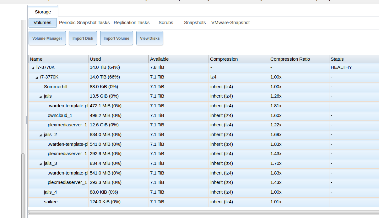

I have a Sabertooth Z77 mobo with a i7-3770K CPU populated with 32GB ram.
The mirror udev has 2x3x8TB.
I know I am not using the recommended hardware because I am still in the stage of trying out the FreeNAS. However FreeNAS has worked for every of the 3 old PC I have tried. Absolutely no complaint. I was about to mirror the boot drive but got this problem first. The new V9.10 installation has 2x32GB USB boot drive but it is too late.
My other other FreNAS box has a Gigabyte EX58 UD5 mobo, a i7-920 CPU, 12GB ram and 3x2TB stripe udev. It is my pilot scheme working flawlessly.
I have found in the past the udev can be transferred from one PC to another with the files intact after import. I wouldn't mind to rebuild my data again but it would be nice if I know the mistake and learn from it.

I think I'm stumped here. I don't think your data is gone--something's using that space on your pool. But it seems to be hidden for some reason, and I think I'm out of ideas why. @Ericloewe? @rs225?
Edit: Actually, I have one other idea--try reporting a bug using the Support button in your web GUI. That will attach a debug file, which might help the devs figure it out.
I have filed a bug report as recommended.
Thanks for all the help. It is a great forum here. The quality of the community is reflective of the quality of FreeNAS.

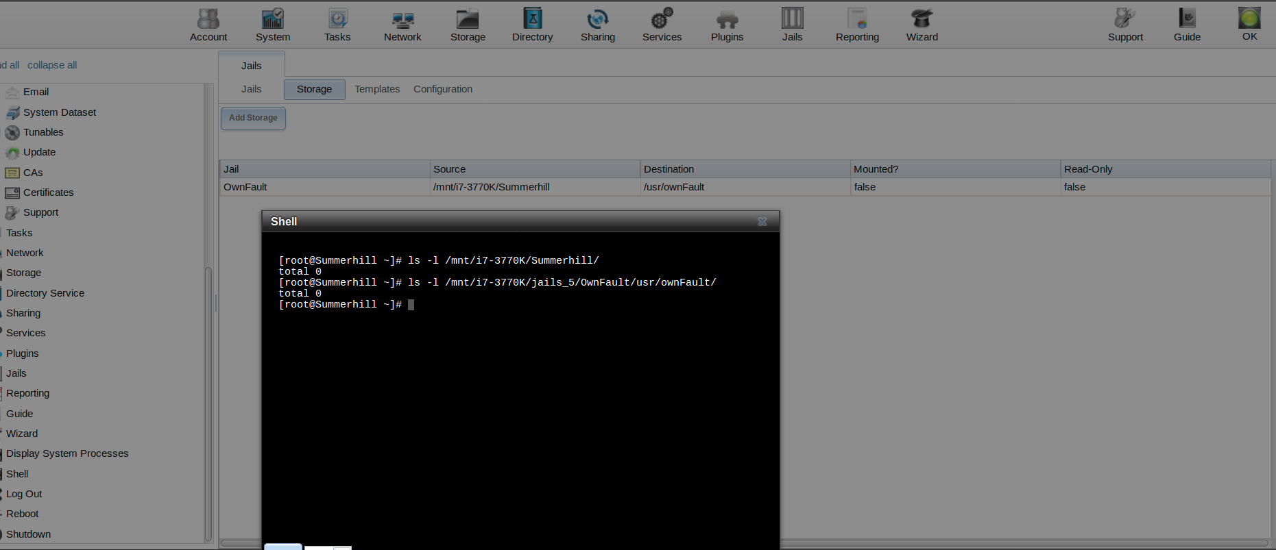

So we're talking in the Mumble here, @Ericloewe, me, and @m0nkey_ , and we have a crazy idea.
Go ahead and "ADD STORAGE" to one of your jails, FROM a directory that you think is supposed to have a bunch of files in it, mount it somewhere inside the jail, and just for the hell of it, let's see if they show up in the jail.

The existing jails do not show up in the jails section.
I created a new jail /mnt/i7-3770K/jails_5/OwnFault by pointing the source from /mnt/i7-3770K/Summerhill
to a target
/mnt/i7-3770K/jails_5/OwnFault/usr/ownFault/
CLI indicates both are empty
to a target
You're not actually inside the jail there, are you? In other words, jexec into the jail.
This is a new jail visible in the GUI only after I created following DrKK suggestion. In CLI I could see the filing systems of all the jails. May be there are other ways to do it the files in my jails seem to be symbolic links to the original files created automatically with plugins but the corresponding mounting points are now empty. I can confirm this by comparison with my other smaller FreeNAS installation.

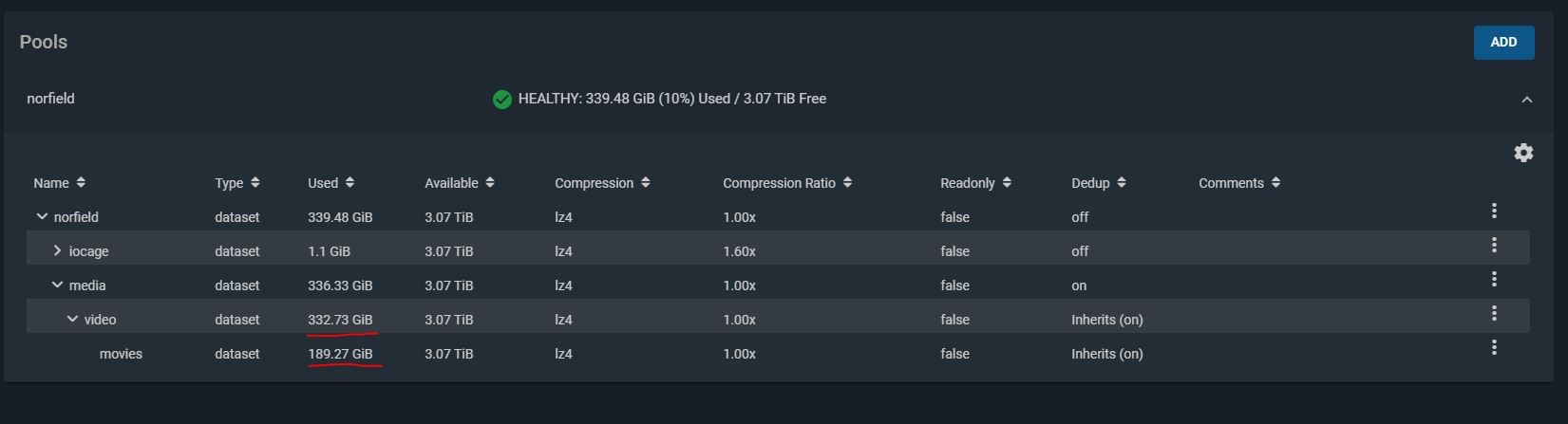

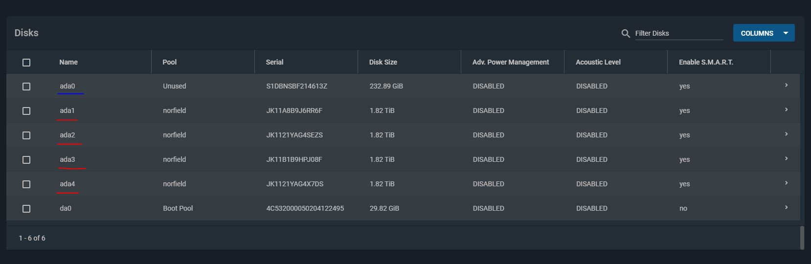

I have a very similar problem to this. I recently updated to 11.3-U1, everything seemed to go well, but I can no longer see my files. I have followed the suggestions in this thread but nothing seems to work.
The only snapshot I have is post update. The dashboard and output from command line du suggest that the files are there, its just I can see them.

norfield/media 336G 3.07T 3.60G/norfield/media
norfield/media/video 333G 3.07T 143G/norfield/media/video
norfield/media/video/movies 189G 3.07T 189G/norfield/media/video/movies
Have I lost my data?! :-(
Any help would be most welcome.
Thanks.

Your zfs list result doesn't show the entire content, You are missing disks within a RAIDZ2 setup. Currently you are only showing 2. However the pool looks healthy.
What worries me is the fact you are using Dedup on your Media dataset. I don't know the consequence of that for your setup.
PS. I think you should start a new thread specific to your use case.

Just checked the missing disks from the zpool status output were a cut and paste error. I think that the dedup got switched on accidentally when I was trying to figure out what happened. I have switched it off.
I'll start a new thread as you suggest.
