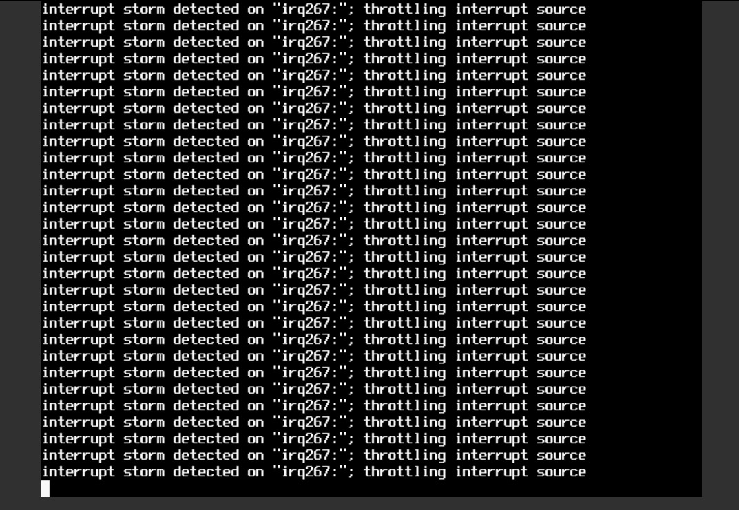

UPDATE: it is booting, but take very long and now my ZFS Volume is in Unknown status :(
and i still get the interrupt storm message every second.

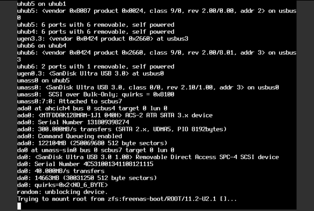

Hello everyone,
yesterday I replaced the CPU of my server with one with more cores (Intel Xeon E3-1260L) and since then my Freenas 11.2 doesn't boot anymore. I only get the following messages:
I've already googled after it, but found nothing.
i hope someone can help me.
Greetings
D1Ck3n

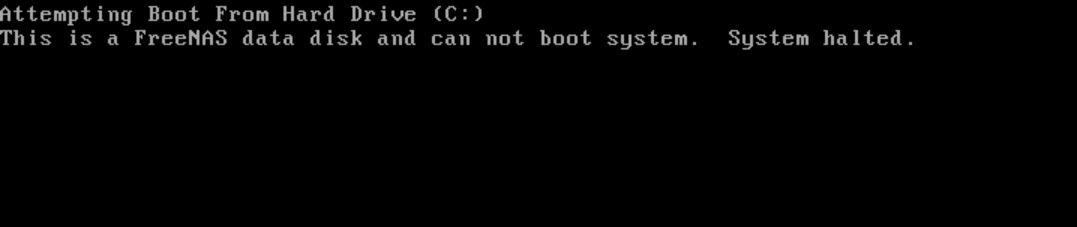

So, i removed the usb stick but now i got the following error:
My Freenas is installed on a SSD i connected with the single Sata port in the server. I think boot from HDD is my storage bay. How do is boot from SATA?
Redcoat
Feb 18, 2014
2,924
Well, it looks to me like you were booting from that USB in fact, and it likely failed. You now need to look in your bios and tell the machine to boot from the SSD. If you have FreeNAS installed on it and it's not corrupt, all shoud be well., hopefully. If all isn't well, reinstall FreeNAS on the SSD.

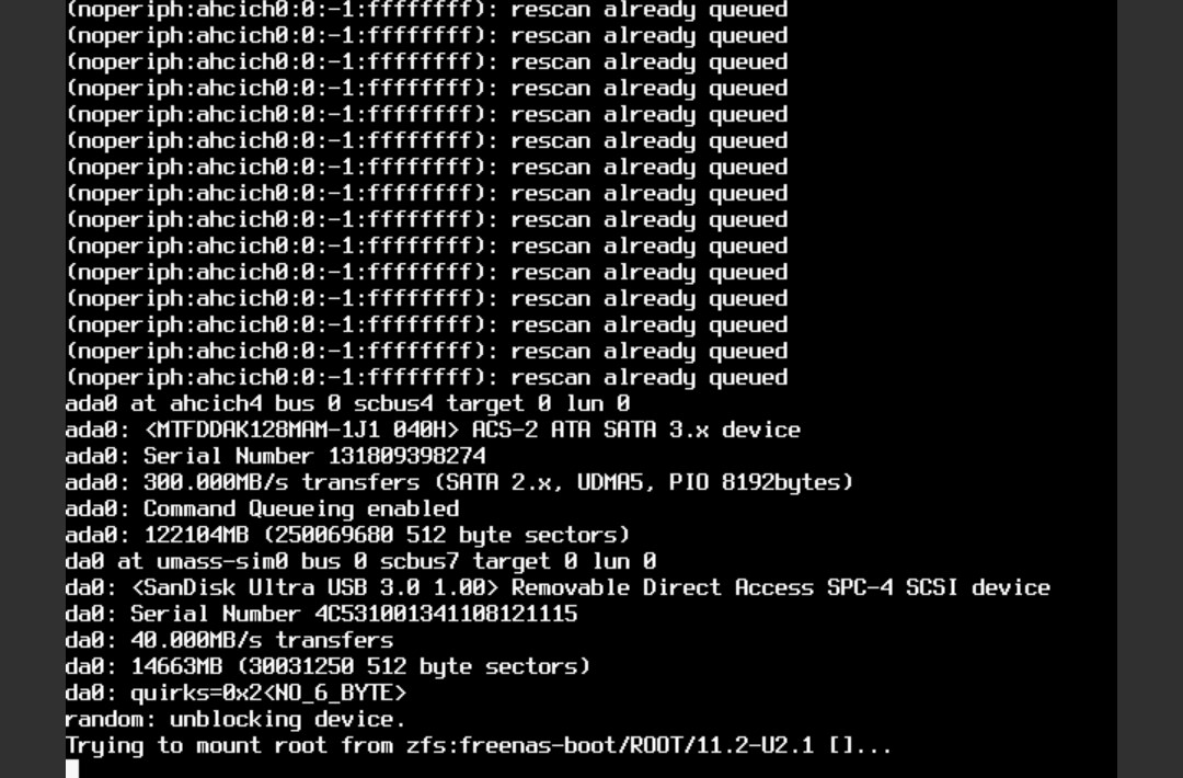

I think I solved it! But I can't say exactly how I solved it. I opened the server again and reconnected all cables. Actually it boots normally again. Nevertheless thanks for the answers!
Greetings
