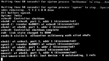

And just when I think i'm on the home stretch, things are pushed too far. It was working for almost 24hrs, and now the zpool isn't being recognized by zpool import.
About the only thing i have to go on is that shutting down the system gives this error
I'll have to troubleshoot this after work.

cyberjock
Inactive Account
Mar 25, 2012
19,525
You may need more than 16GB of RAM. Perhaps a drive is failing in addition to your other problems.
