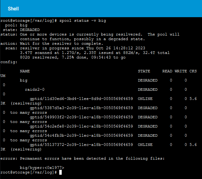

I am in a bit of a (maybe) pickle and would appreciate some help, thoughts and just understanding what is happening.
So I have just shutdown my server and started it back, without any hardware changes.
The below is what is happening currently:
I do not understand concretely what is happening and about 40 mins of searching nets nothing close to what I am experiencing.
How are 4 drives suddenly degraded and 2 are resilvering if I read correctly?
Is anyone able to say with a degree of certainty if my pool will actually recover?
I checked SMART data on all these drives and it seems fine, there is another 2 drives in a striped pool off the same controller running just fine.
I am very confused at my current situation, would greatly appreciate if someone can help walk me through any troubleshooting or just explain what I have missed.
Your help and time is appreciated. Thanks!

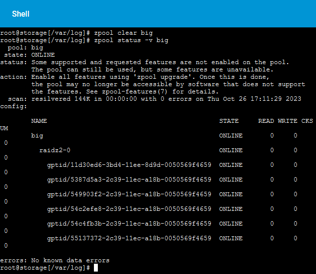

Well I am at a loss, this happened, it seems its all ok now?!?

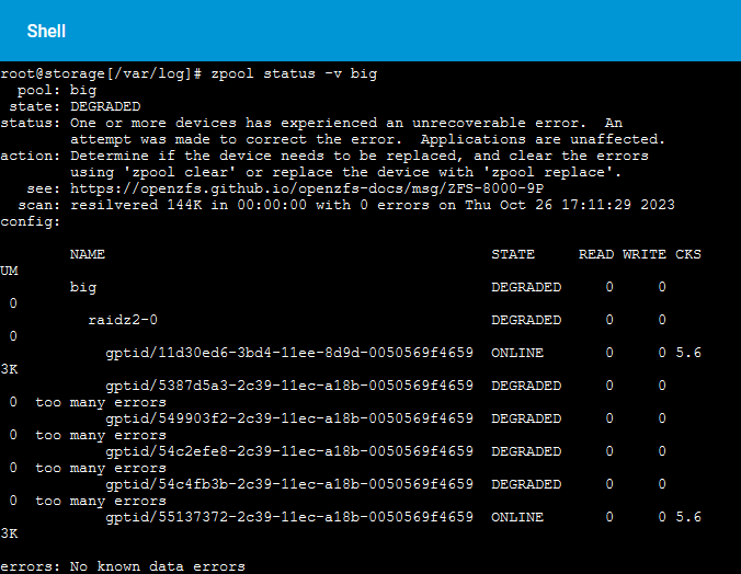

It stopped on its own like this:
I did the zpool clear at the end and now it looks like this, much better
I am actually not satisfied because I do not know what has actually happened to cause this. I have been having a rock stable time on TrueNAS for years, even doing drive replacements without issue.
Any help on identifying what gives, even tho the issue appears to be resolved?
Thanks!
