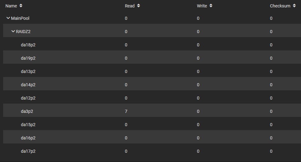

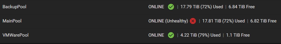

I am on the fence about replacing this WD Red 4TB EFRX (CMR) drive.
Smart tests, both short and long are failing on two LBA's.
No other errors of significance that I am seeing.
Normally I would just replace it but seeing as CMR drives seem to be going the way of the Dodo bird, I am on the fence.
I have a cold spare on the shelf ready to go. Ran Bad blocks on it when I purchased it 18 months ago.
Here is the output from smartctl on the drive in question.
What would you do?

I've got another one I am on the fence about:
Would you replace this or let it go awhile and see what happens?
Pool is RaidZ2.
Interesting tidbit, I woke up yesterday to a faulted drive.
It was totally FUBAR and I replaced it.
The drive below threw some read errors during the resilver.
Gotta love the alerts in TrueNAS.
BTW, I am leaning towards just replacing this one as well but I'm curious as to what others thinks of this SMART report.

What is driving my concern is the alert saying a drive experienced an unrecoverable error.
And the 7 read errors it is showing. See screenshots:
What I find a little interesting is that when looking at the dashboard, MainPool shows green and healthy.
But status shows what you see above.
Seems to me the two should agree.
Bug perhaps?

Run a scrub on the MainPool and see what the results are. This will tell you if the data is all intact, which I suspect it will be. If the pool comes back without errors but you still have the read errors listed, you may need to run zpool clear MainPool in order to clear the error, BUT FIRST I recommend rebooting (not a power off unless you want to) the system to see if that fixes it. I doubt it will fix it but damn, sometimes things just get fixed. Then if that don't fix it, run the command I listed above. That should fix it. Report back your results.
The hard drive itself looks fine right now. It could have been caused by the MultiZone errors or just some other anomaly (my bet is something other than the hard drive right now). If the MainPool has more of these failures then post them and the drive data as you previously did. Also think about what might have happened to your system. A power drop, you shut down the computer, you did something to TrueNAS. It could be something you did is what I'm saying, or nothing you did. Troubleshooting intermittent problems is difficult and takes time. Hopefully the problem will just go away after you issue the clear command.
Matt_G
Jan 24, 2016
65
Your advice was spot on joeschmuck. :cool:
Ran a scrub and it showed zero errors.
Rebooted as advised and sure enough, it cleared those read errors.
Everything looks good at this point.
I have saved that SMART report and will keep on eye on this drive going forward.
Thanks for the help!
