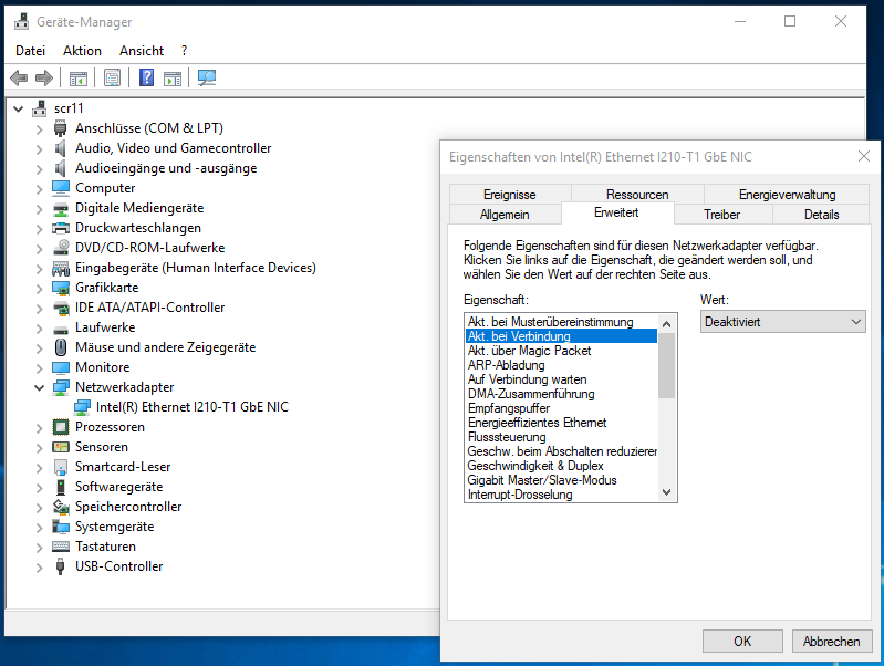

Unfortunately I don't know an answer to your question. If there's no way to accomplish that in FreeBSD and you already exploited all available BIOS options there might be a chance to configure that in Windows. That is if it is possible for you to (temporarily) install a Windows-Version on this machine which supports the i210-AT. Admittedly I do not know if the settings shown below would be permanent and survive a reboot into FreeBSD/FreeNAS.
Getting to the point: I'm using a i210-T1 based NIC in my primarily used Windows Client-PC (hopefully close enough to the i210-AT on the X11SSM-F) and within the Windows Device Manager I'm seeing several APM (Advanced Power Management) configuration options (the formerly called "Wake on LAN" thing as the Intel documentation calls it [Product Brief]). In German these are called "Aktivierung bei Musterübereinstimmung", "Aktivierung bei Verbindung" and "Aktivierung über Magic Packet". As I already said I do not know if these settings survive a reboot into FreeBSD/FreeNAS.
Windows 10 Device Manager screenshot (german OS version, hopefully nevertheless understandable)
