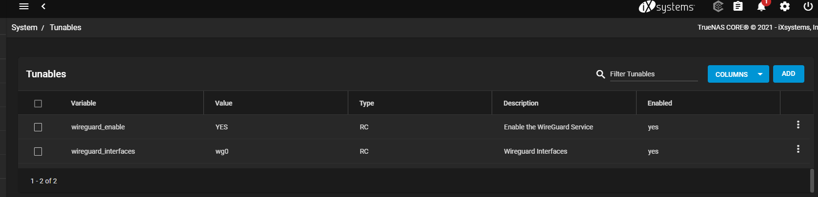

Hi all,
I am following the ixsystem guide to setup wireguad on the TrueNAS system. Once I rebooted the server I cannot see the wg0 interface.
I am also not able to see the
wireguard_enable = YES
in the /etc/rc.conf file

Hi all,
I just managed to get the interface up and running by changing the interface address.
I had the following:
[Interface]
# TrueNAS server private IP address ##
Address = 172.15.10.11/24
## Wireguard VPN server port ##
ListenPort = 51820
## VPN server's private key from /etc/wireguard/privatekey ##
PrivateKey = PNmyprivatekeylED5H41geGbXvLmkU=
The IP 172.15.10.11 is my TrueNAS IP.
I changed it to 172.15.10.111 and now the interface load.
Could anyone please advise what exactly I am meant to set the Address to? It it my public IP ir my TrueNAS IP?
Thank you
