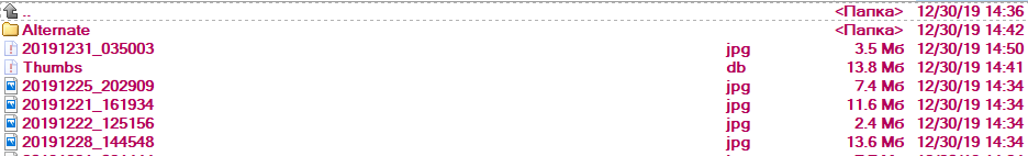

I sync photos from my phone using syncthing into SMB share on my freenas (FreeNAS-11.2-U7). Syncthing is configured to use my SMB credentials (same as for my windows account). Some reason windows doesn't see sync-ed pictures, although they exists there. Total commander on the other hand sees them but displays them with exclamation mark (see first JPG in the list):

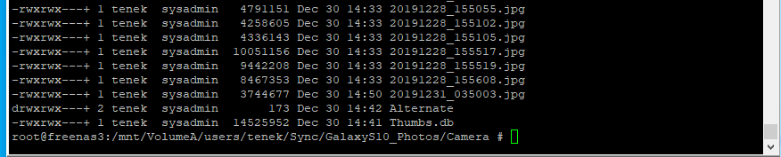

Folders setup with windows permissions, and looking on attributes I don't see any differences (the example problem file on is the last on the pic below), why new synced pics somehow not recognized by windows, any ideas?
