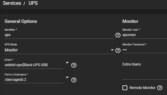

I have this APC Back-UPS BE850M2 model connected to my TrueNAS server.
It is showing up as Back-UPS ES 850G2 on the Server
I tried a few different combinations of Driver, Username and Password. But when I start the service, within a few seconds the service seems stop automatically.
I keep seeing ERR ACCESS-DENIED and forced shutdown in progress in the logs
The UPS information seems accurate too
What settings should I be using?
# dmesg | grep ugen ugen0.1: <0x8086 XHCI root HUB> at usbus0 ugen0.2: <American Power Conversion Back-UPS ES 850G2 FW:931.a10.D USB FW:a10> a t usbus0
# tail -40 /var/log/messages Nov 14 11:15:15 Cloud 1 2021-11-14T11:15:15.841476-05:00 Cloud.lan upsmon 36639 - - Login on UPS [ups@localhost:3493] failed - got [ERR ACCESS-DENIED] Nov 14 11:15:20 Cloud 1 2021-11-14T11:15:20.842767-05:00 Cloud.lan upsmon 36639 - - UPS ups@localhost:3493: forced shutdown in progress Nov 14 11:15:20 Cloud 1 2021-11-14T11:15:20.843152-05:00 Cloud.lan upsmon 36639 - - FSD set on UPS ups@localhost:3493 failed: ERR ACCESS-DENIED Nov 14 11:15:20 Cloud 1 2021-11-14T11:15:20.843287-05:00 Cloud.lan upsmon 36639 - - Executing automatic power-fail shutdown Nov 14 11:15:20 Cloud 1 2021-11-14T11:15:20.853090-05:00 Cloud.lan upsmon 36639 - - Auto logout and shutdown proceeding
# upsc ups battery.charge: 97 battery.charge.low: 10 battery.charge.warning: 50 battery.date: 2001/09/25 battery.mfr.date: 2020/07/08 battery.runtime: 1700 battery.runtime.low: 120 battery.type: PbAc battery.voltage: 13.7 battery.voltage.nominal: 12.0 device.mfr: American Power Conversion device.model: Back-UPS ES 850G2 device.serial: 4B2028P16913 device.type: ups driver.name: usbhid-ups driver.parameter.pollfreq: 30 driver.parameter.pollinterval: 2 driver.parameter.port: /dev/ugen0.2 driver.parameter.synchronous: no driver.version: 2.7.4 driver.version.data: APC HID 0.96 driver.version.internal: 0.41 input.sensitivity: medium input.transfer.high: 139 input.transfer.low: 92 input.transfer.reason: input voltage out of range input.voltage: 121.0 input.voltage.nominal: 120 ups.beeper.status: enabled ups.delay.shutdown: 20 ups.firmware: 931.a10.D ups.firmware.aux: 10 ups.load: 23 ups.mfr: American Power Conversion ups.mfr.date: 2020/07/08 ups.model: Back-UPS ES 850G2 ups.productid: 0002 ups.realpower.nominal: 450 ups.serial: 4B2028P16913 ups.status: FSD OL CHRG ups.test.result: No test initiated ups.timer.reboot: 0 ups.timer.shutdown: -1 ups.vendorid: 051d
