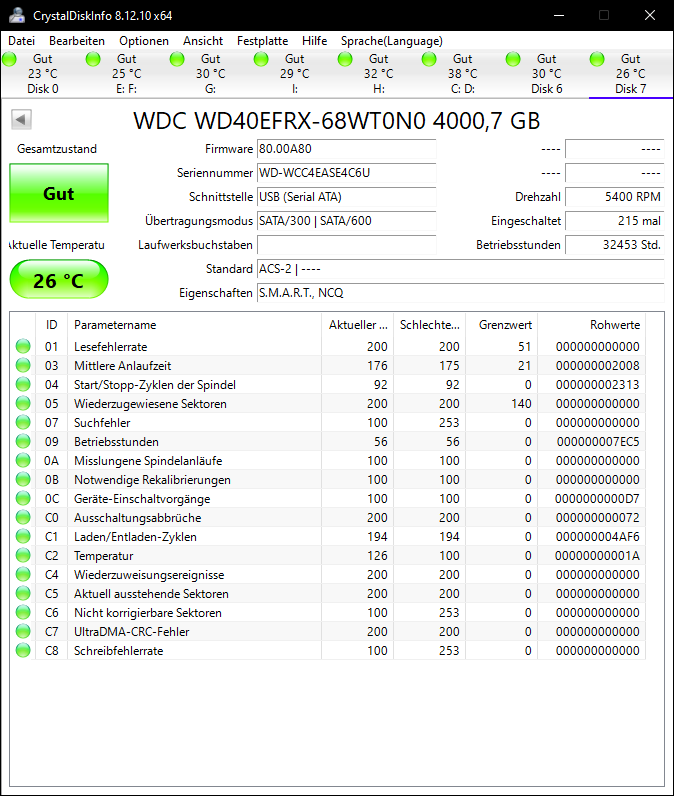

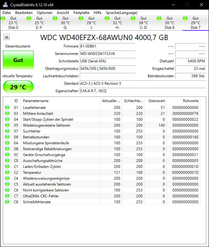

It is not the hard disks, I removed them all individually and checked them with CrystalDiskInfo.

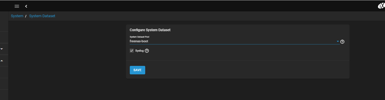

TrueNAS is only set up as a data server with SMB, nothing more. No plugins installed, nothing. Also the pool for plugins to install is deleted. I only have a pool from the 7 hard drives for data exchange in the home network.
