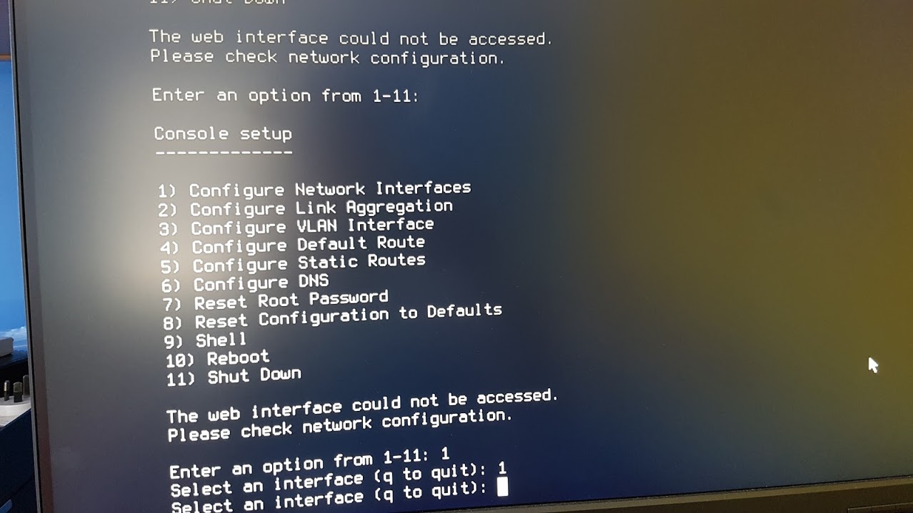

Hi all,
I've just downloaded and installed freeNAS 11.2-U3 using a usb stick onto my 240GB Samsung SSD HDD Sata3, Installation was ok, however once the OS loaded i got the error (freenas the web interface could not be accessed please check network configuration). The issue i have is that i cannot make any selections in the console menu. I've attached a screenshot example. When ever i make any selection between 1 to 11 nothing happens, the "select an interface (q to quit):" keeps appearing.

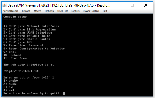

Sorry to be the bearer of bad news, but your system is not compatible with FreeNAS at a hardware level. There are no recognized network interfaces to configure. That screen should look like this, populated with at least one network interface to configure"
Gaming hardware is often a poor choice for a NAS. Here is our hardware guide:

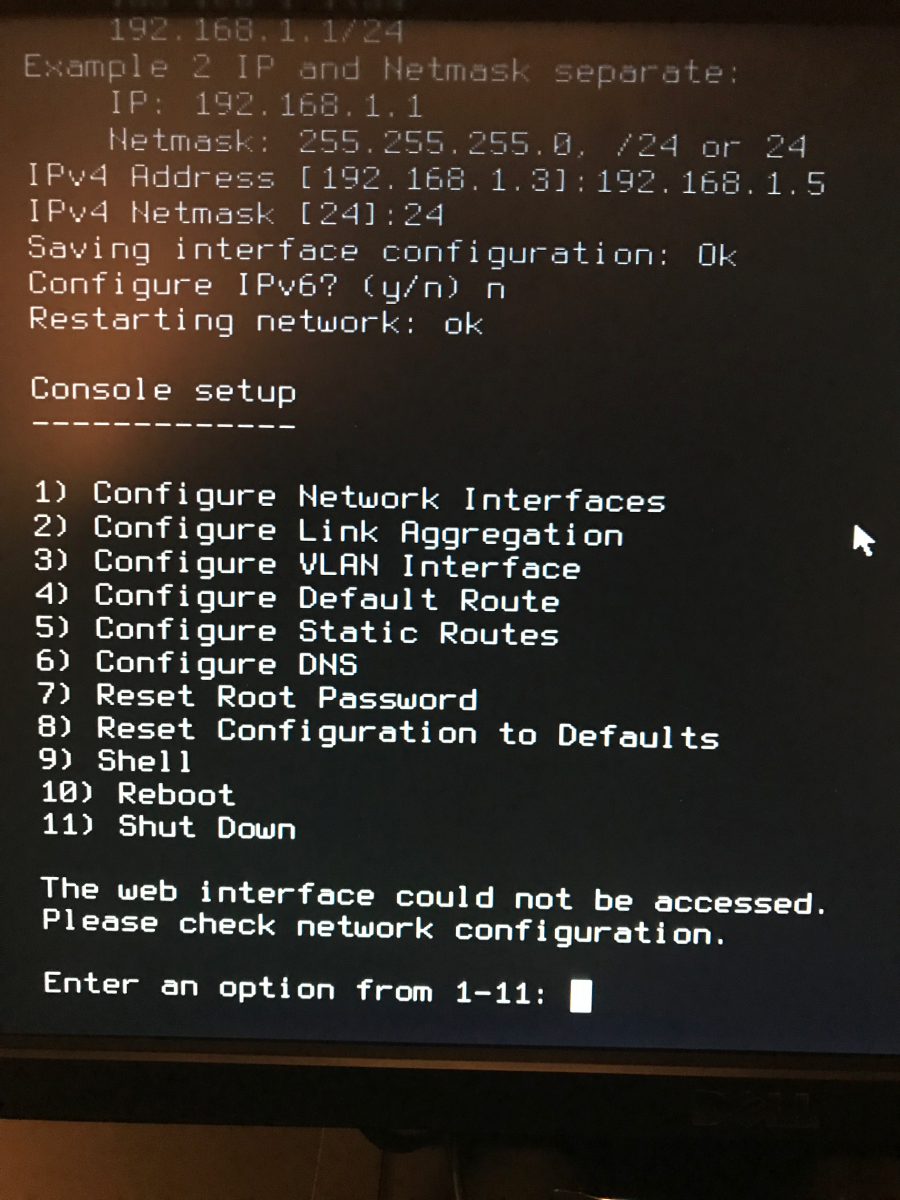

I just got hit with same problem under FreeNAS 11.2 U6 cant get into FreeNAS WebGui "* The web interface could not bind to 192.168.1.3; using 0.0.0.0" and i am fully hardware compatible and i can see all network interfaces exactly as chris More screen shot but it seems cant be able to resolve this as of this writting. I can get into shell console but no idea what to do. Any help would be apreciated. Last time it happen with my test FreeNAS and couldnt be able to resolved the problem I end reset configuration to default then later restore with my config, but this one is my production it should be something i can do.
I tried several times to reset configuration to defaults but never work or managed to get ip for webgui so at the end i decided to restore back to FreeNAS 11.1 U7 and now everything works fine and what I lost was 2 days of work mostly for testing purposes and not much important.
