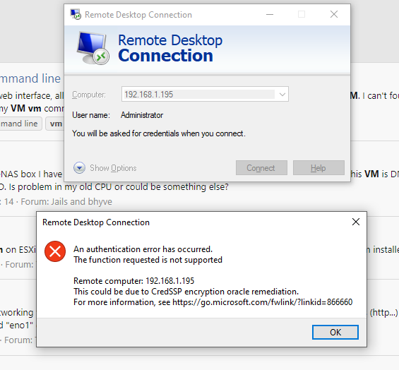

Hi There,
I installed as an exercise a Windows 2016 server and enabled the remote desktop service.
When I enter its IP adres in the Remote Desktop Connection app I need to enter my username and a password.
This login prompt closes immediately after hitting enter.
I noticed the webpage itself uses VNC but when I use a VNC app/viewer for my Windows 10 machine it can't connect.
How can I easily connect to my virtual machine from my windows machine without using the webpage from Truenas server.
