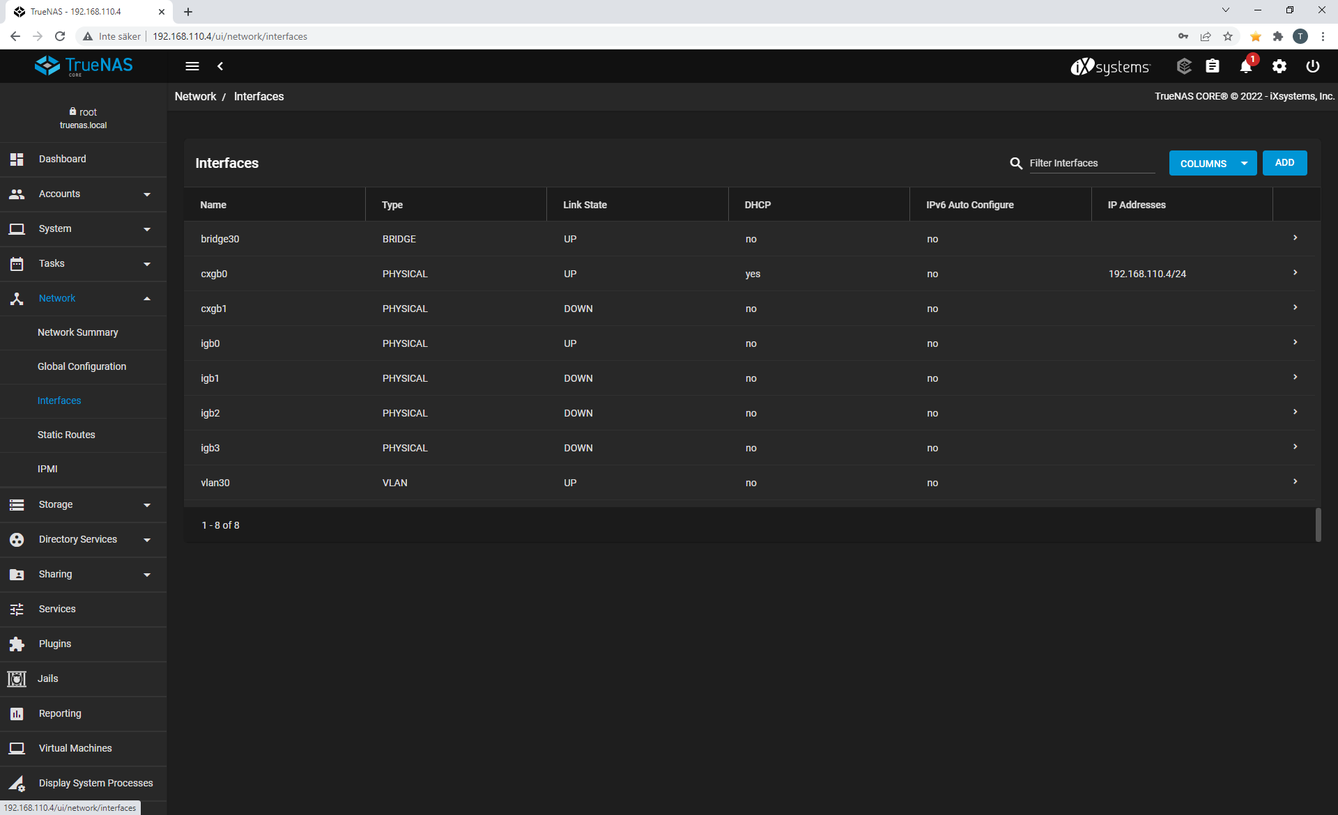

i have setup a vlan30 on parent igb0
i have then bridged a bridge30 on vlan30
linkstates are up
problem is that when using bridge30 in jails they dont get the tagged vlan address range, they get the main lan range

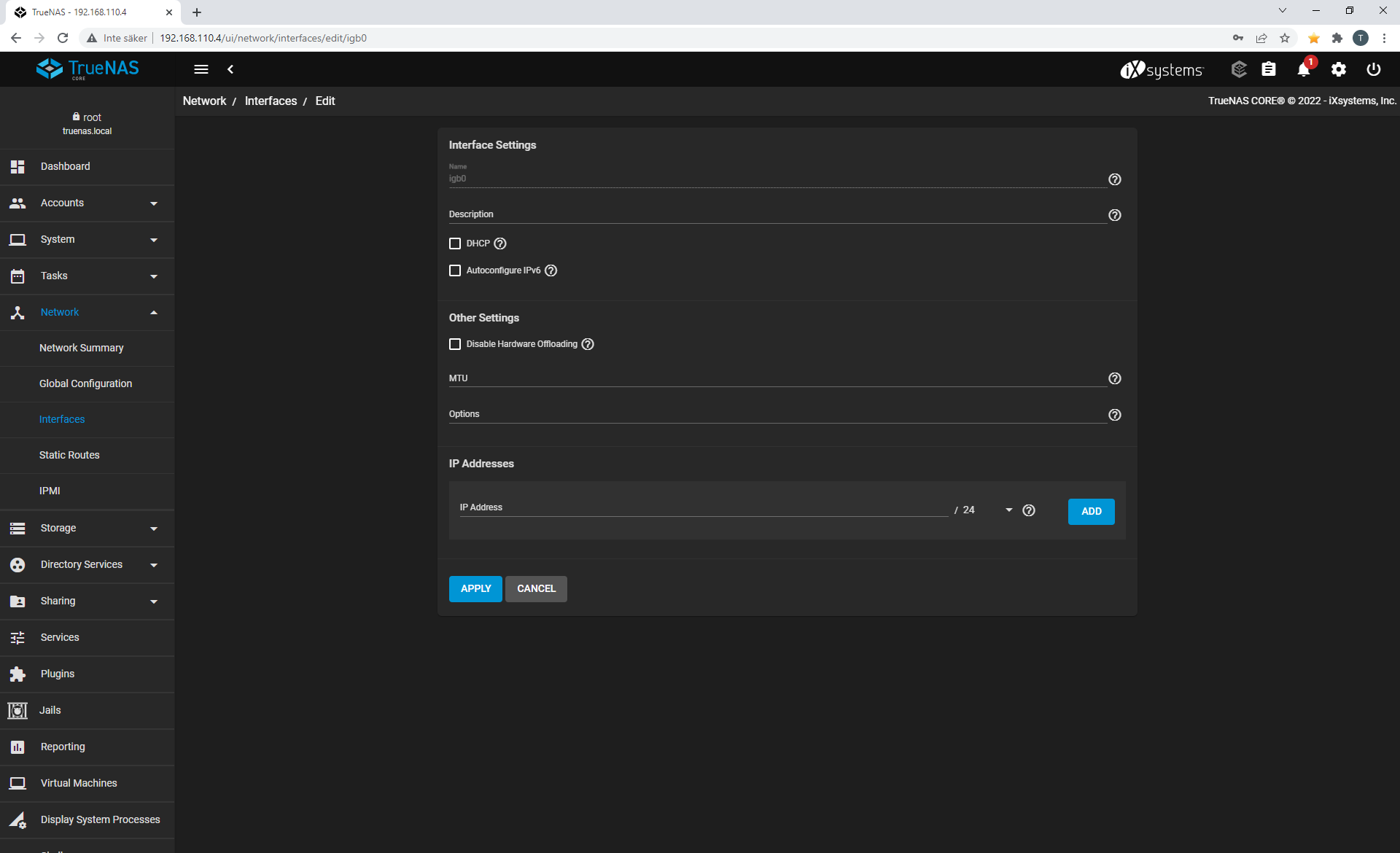

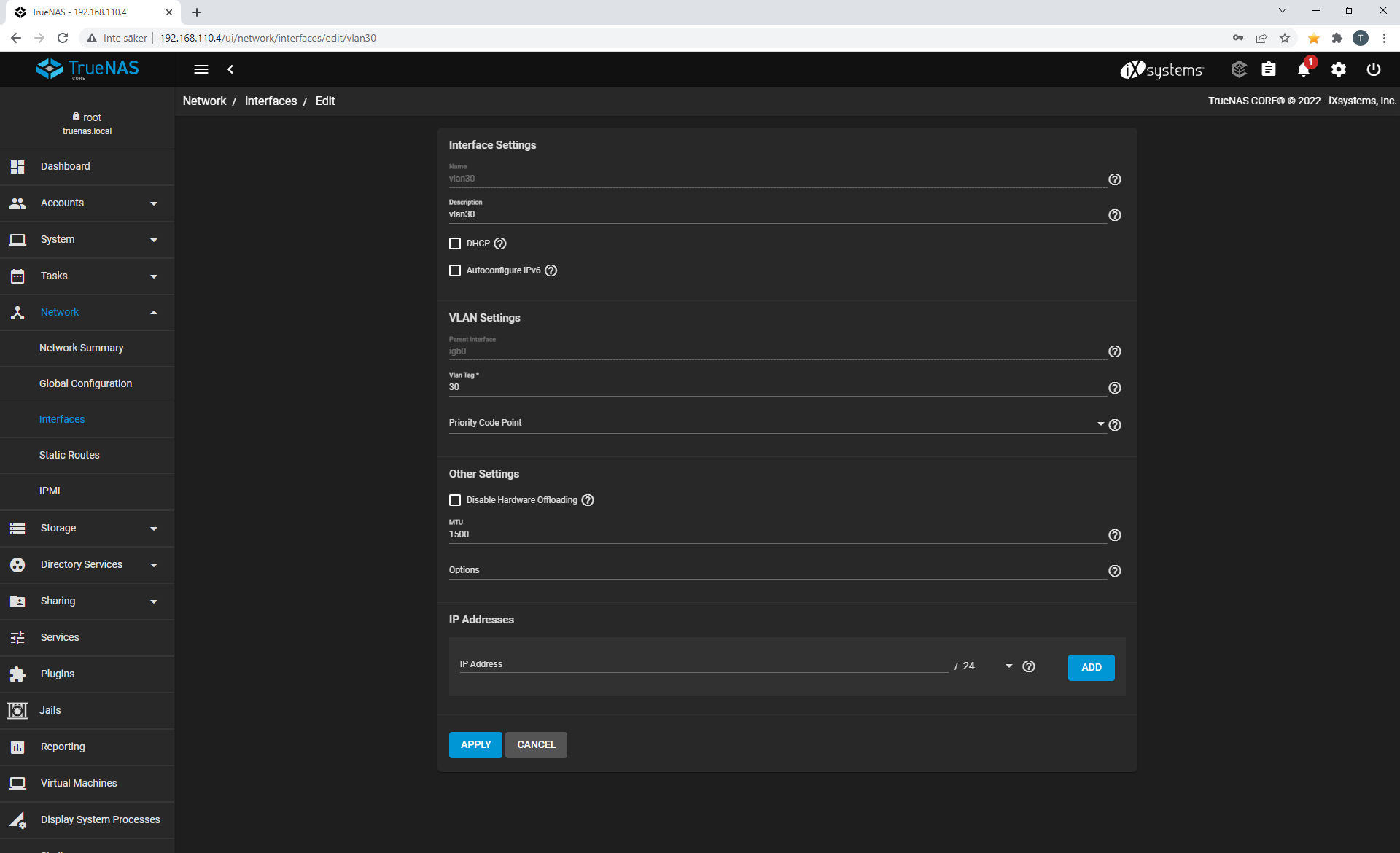

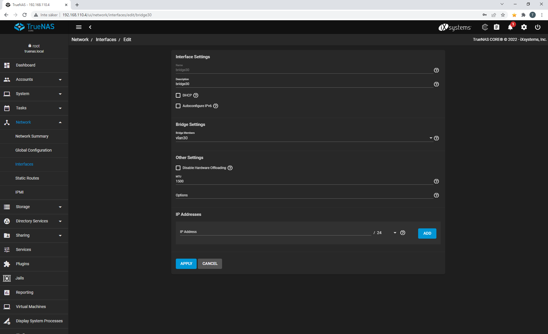

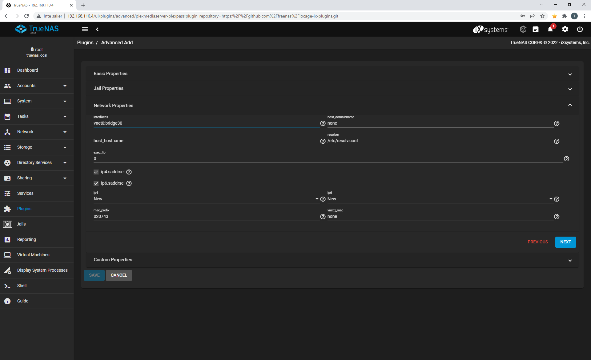

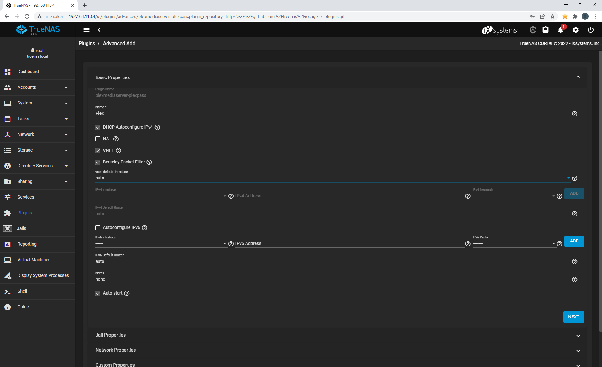

see picture for how i did
do i need to set the vnet_default_interface also in the jail conf ?
that was not done in the Lawrance video i watched
is the problem that i follow a 2020 video ?
