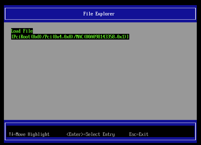

I have been able to confirm my image works by simply adding the image as a raw file to the VM and the VM boots fine to that image file. The issue comes when I DD the image to the ZVol, the command runs, I start the VM and then I get the error Boot Failed. EFI Hard Drive. After a min it pops me into the EFI shell, now ordinarily from here I would go to Boot Maintenance Manager and Boot From File and select the boot file. The issue I have is the file doesnt work.
This boots me to a blank screen which then just shoves me back into the EFI shell again after a while. I feel like something must be wrong with the DD process or is there a simple fix for this?
